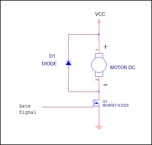

Carl suggested earlier:
Make sure you add a protection diode (cathode to plus) across the motor to suppress turn-off spikes that could zap the transistor.
See the attached!
I have no clue how a microprocessor could have cost you $100?
All of your drawings still reflect a poor choice of MOSFET and yet you still persist, I fail to understand that? Using the correct MOSFET with the mentioned correct protection should be all you need. As to a DC SSR? Why? If you want isolation a few dollar opto coupler for the gate signal should work fine.
Just maybe if you would stop and listen to people you might stop cooking parts. If you don't understand when someone tells you something then ask for clarification.
Ron

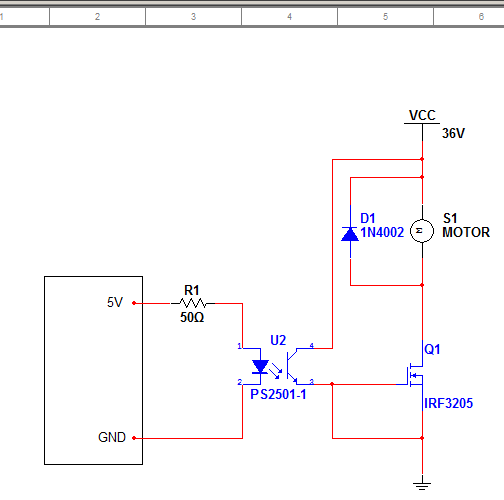

Alright, attached is the updated circuit.
I have a good feeling the optoisolator is hooked up wrong, and note I know it's not the same one Carl linked to, but multisim didn't have that one in it's database.
Anywho, I tried to apply this example that site provided as much as possible to this application but just started to get confused after a while: https://www.sparkfun.com/datasheets/Components/PS2532-Example.jpg
You want your circuit to resemble the attached. The way you have it drawn the MOSFET Gate is shorted to ground. Also your U2, when it is turned on effectively becomes a 36 volt short to ground. The LED side of the opto will work fine with a fwd current of 10 mA and a fwd voltage of about 1.2 volts. That would be about a 380 ohm series resistor. I used 330 as a common off the shelf part. This is your opto coupler data sheet. It's actually a quad so you might want to rethink that.
There may be a few other errors, I did not really look close at the MOSFET data sheet. Getting late for me as I am up at about 3:30 AM so you have a good evening.
<EDIT> OK, now I get the part numbers. I saw your comment about multi-sim. That makes sense. You are only working with the parts in the library that you have. </EDIT>
Damn, one more thing. With this setup the motor will run when the PIC output line is low. Look closely at what happens.
Ron

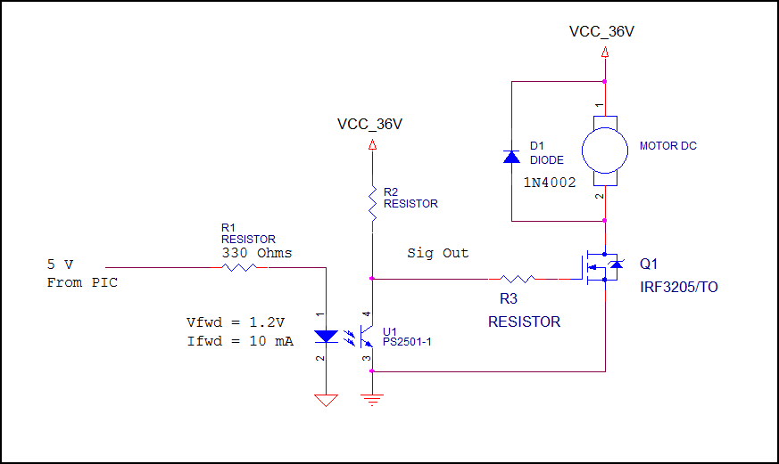

Ron
Alright, so I've modified my circuit to resemble yours, however, I'm unsure why you have bot R2 and R3. I understand we can't send 36v to the gate, so are those used to create a voltage divider of some sort to give an output of 5v to the gate?
R2 limits the current thru the opto when it turns on. Its value will be determined by the opto. This resistor will also put 36v on the gate of the MOSFET when the opto is off. This will not be tollerated well by a 20v max MOSFET gate. To remedy this and use the circuit provided, you will need to supply R2 with a voltage lower than 36v (like 10 or 12) or make a voltage divider by placing a resistor across the opto to put 10-12v on the gate, or place a 10-12v zener diode across the opto. All of this is clumsy. The circuit will draw current when it's off and also while it's on. Not much maybe, but it still does.
R3 helps snub oscillations that can occur at the gate. It is usually a few hundred ohms at most.

Like most Mosfets, the one shown needs 10V on its gate (not just 5V) to completely turn on. You can buy a "logic-level" Mosfet if you want it to completely turn on with just 5V on its gate.
