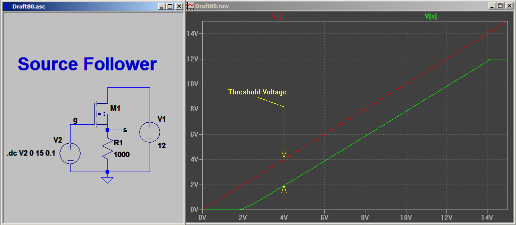

You seem to be confused about how a source-follower works. Note that V(s) follows V(g), but there is an offset determined by Vth (threshold Voltage) of the NFET. Note that V(g) has to exceed Vth before the source follows. Note that the source cannot follow any higher than V(d)=12V.
Two NFETs of the same part number can have radically different Vth.

No, as it is done now, V(g) is not more than Vth above V(s), or Vgs =Vth, which is clearly within the Absolute Max Rating.
If you use a NFET and put the loads in its drain, then since Vs is ground, Vg max = 12V, which is right at the max limit.
If you use a PFET (source connected to +12V) and put the load between its drain and ground, then the gate swing must be constrained to be between 12V (PFET turned off), and ~2V (PFET turned on hard, Vgs = -10V max). This would keep the Vgs of the PFET within its Absolute Max Rating limits.
