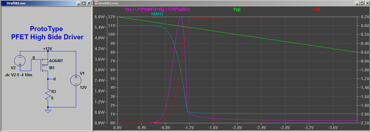

Here is a prototype PFET high-side driver. You have to understand this before you worry about driving it from a 3.3V micro...
Note that the gate drive is referenced to the +12V line; not gnd. If V(g) = 12V, the PFET is off (Vgs=0V).
As V(g) decreases from 12V toward ~11V (Vgs=-1V), the PFET begins turning on, pulling its drain V(d) toward +12V in-spite of the 6Ω load.
By the time V(g) reaches ~10V (Vgs=-2V), the PFET is turned on about as hard as it needs to be to deliver 2A to the 6Ω load resistor. Note the power dissipation in the PFET (the violet trace) as Vgs moves from 0V to -4V, which is the X-axis of the plot.
As the Vgs drive is increased (decreased?) from -1V to -4V, the PFET turns on better, reducing its Ron, and thereby reducing the power lost in the PFET.
In a subsequent post, I will show how to drive this from a micro pin that swings from 0V to 3.3V, but I want you to understand this post first.

You understand what I mean when I said there is no point using a PMOS on the low-side right? Because you might as well just use an NMOS which is better. You use a PMOS so you don't interrupt the ground path.
So in post #22, note where the gate, source, and drain pins are. It's flipped upside down compared to an NMOS in the same location. The important thing is to note that the the MOSFET turns OFF when the gate equals the source pin voltage (just like an NMOS), but unlike an NMOS, to do that requires the gate to be pulled to12V. The MOSFET starts to turn ON when the gate is pulled below 12V by a more than the threshold voltage and fully turns on if you pull it sufficiently farther below that. The most straightforward way to do this is to pull it to ground. So again, the greater the voltage difference between gate and source, the more the PMOS turns on, just like an NMOS. But unlike an NMOS the gate voltage needs to be pulled towards ground to do this.

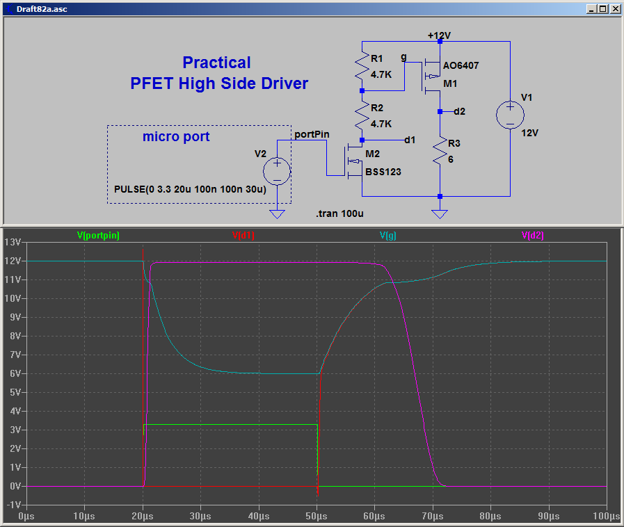

So here is a practical PFET high-side driver that starts from a 3.3V swing coming out of a micro port pin:
The green trace is the signal from the port pin. In this simulation, it switches high at 20us and switches back low at 50us. It drives the gate of a small-signal NFET, whose Vth is about ~1V, near the center of the swing. Time is the X-axis.
M2 amplifies and inverts the signal to make V(d1) = red, and swings from +12V to 0V and back to 12V.
The voltage divider R1 and R2 constrains V(g)=blue to be between 12V and 6V, making Vgs of M1 either 0V or -6V (well within the max allowed).
Finally V(d2) = violet shows the voltage delivered to the 6Ω load R3. Note that is a max load current of ~12V/6Ω = 2A!
This driver turns on in ~2us, but it takes about 20us to turn off, mostly due to charge stored in the gate region of M1.

I am just a bit confused that the drain of M2 is called d1 and the drain of M1 is d2 but I got the xplanation. Why is the blue trace (M1 gate voltage) not following the red trace (M2 drain) between 20µs and 30µs?

M1 gate between 20-30us is a curve because it's discharging the gate capacitor through a resistance. The gate capacitor's voltage is the voltage of the gate which controls the MOSFET.
First, V(g) comes from a tap on a voltage divider, so it is ratiometric with respect to 0V and 12V, hence while V(d1) swings 12V, V(g) swings only from 12V to 6V and back.
Second, the effective series resistance of the voltage divider R1 and R2 is charging and discharging the gate-to-source and gate-to-drain Miller capacitance of the PFET. Although 20us looks like a long time for the PFET to turn off, that is not very long if you are switching the load on/off a few times per second.

As a replacement for the BSS123, would any of these do: SI2312, BSS138, AO3400A (datasheets annexed)?
And for the AO6407, would one of these do (nice to have a low on-resistance, but I only need to switch 200mA): FU9024 or AOD403?
EDIT (added): and maybe even an SI2301?
