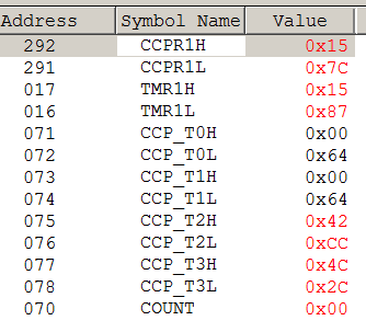

Old can be beautiful. Simulated my 12F1840 on a 16F1519 platform (SIM = MPLab SIM):
Spent a lot less time doing that than I did fusing with the dead horse, and I got useful results.

Start to finish with the 16F1519 was only about 2 hours, and most of that time was me reviewing the SFR's to be sure I had everything set right. There is not much different, just a couple of duplications.

I got the program for eight reads debugged this morning. There was an obvious logic flaw, and the simulator helped immensely to find it. The program takes eight reads, sums them, then does right shifts to get rid of useless precision. The result is a value equivalent to a double read, but quite steady. For example, the total counts for a single period are 0x1cbd ±1 lsb (approx. dec. 7357 ±1).* The numerator is also ±lsb. So, worse case, you are seeing a display that is about ±0.1° or less. I do not know how accurate the values are.
I find that precision amazing, but it is time to put it away and work on my taxes. Thanks for the help trying to get MPLAB X working. The old 8.92 version is just so much more intuitive for Assembly.
John
*The device's oscillator is about 4.5 MHz, my PIC is at 32 MHz . The data are reported as 12 bit (i.e, about ±0.08°), so my measurement of the PWM seems to be pretty close to the predicted limit.
