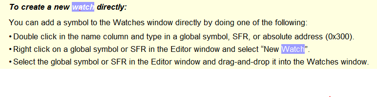

3) I could watch SFR's, but didn't find the trick to add my own registers ("symbols"). I could get them in the watch window, but they disappeared as soon as I did something, like click on run or step.

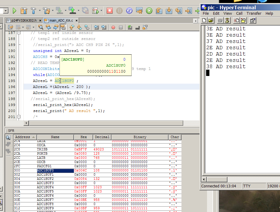

I found MPLABX and C a steep learning curve, I had a few years with PIC16 and asm with MPLAB 8xx , Have not found lack of animate a problem . PK3 debug is the tool ! just set a break point then hover mouse over variables ( turn it yellow) and IDE shows values etc , single step or run to cursor etc.

I though I had MPLAB X working until about 2 hours ago. My watch window had both SFR's and what are now called Symbols showing, and when paused they nicely updated. Stopped to do something else and when I reopened, every line with a semicolon in it gave an error. The error was:
Makefile:2:***missing rule before recipe. Stop.
After a little digging, I guess MPLAB X decided to make me use C whether I liked it or not. Not being able to find what got corrupted, I discarded that project and built a new one. That now builds and simulates, but I cannot get Symboles in the Watch window; only SFR's appear.
The Help window says:
I have tried everything and have no memory of what I did yesterday to make the register symbols show up with their current content value.
Very frustrating. I suspect MPLAB X will go down in history as Microchip's version of Windows 8
John
Just looking myself... Whilst debugger is paused... I right click on the global variable, the context menu has "New Watch..." as the first menu option... It automatically added the variable to the watch window..
I get exactly the same windows, but when I click on OK, it just disappears. Are you in C or ASM? I suspect C. C is all the help window shows. I am using Assembly absolute mode.

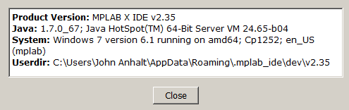

One other disturbing thing is that MPLAB X apparently thinks it is running on an AMD64 processor, which it is not. I can fully appreciate the reasons behind Microchip's decision to outsource further development of its IDE, but I don't think it was well planned or implemented.

I have not given up on MPLAB X yet. I am just giving it a rest. The "about" showing the wrong CPU may be a flag that it did not install correctly. My PC is most definitely an Intel.
