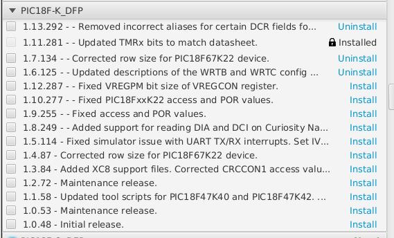

Can anyone see what I'm doing wrong here?
I've got a project that's (now) rather large.
I've defined a buffer that's 80 bytes long,
As can be seen from above the buffer shows in variables as correct and the data memory used is 975.
If I now reduce the size of the buffer to 40 (or any other number) it still shows the same in variables,
But the data memory used has reduced to 935 - 40 bytes less. But the variable window still shows it as 80 bytes.
What is more worrying is I can write to the 79th byte of the buffer - yes I wrote 0x55 there.
I've tried everything - deleting buff from variables, renaming it and putting it back - still shows as 80 bytes long.
I'm using the simulator as I currently don't have the hardware.
Sorry about hiding the project name etc but it's obvious who the client is if I don't.
I have a line in the code, sprintf(buff,"TST %3F",2.345); with a breakpoint after it but buffer stays empty.

I added a buff[70]=0x55; to the version with the buffer declared as 40 (long) and it produced a warning.
A clean and build made no difference.
I'm assuming that a clean will force all files to be compiled.
I think crap like this happens when two or more projects are open.. Also if you compile without debug, watch and variable lists are incorrect.. So if one of your open projects is in release mode.. Well MPLABX must have been written by a man.. as it seems to not multitask.
I only have one project open and I am compiling a debug version. The annoying thing is that if I try to make a cut down version to show the problem it's (the problem) not there.

A little more information,
When I compile it shows buff at address 0x400
However, when I look at the data memory it shows,
These are after the same compile.
This appears to show the buffer at 0x173. I use buff[39]=0x55; to place the end of the buffer.
And sprintf(buff,"TST %f",toFp(539)); to place the text in the buffer.
The function toFp rounds to the nearest mV (it's displaying ADC values as voltages - client prefers voltages) - why is it printing three trailing zeros?
I could try defining a pointer and loading it with the address of buffer but I just won't know if to trust it.
A long shot... the pack PIC18-K DFP 1.11.281 I had trouble with PIC18F k packs. may be just my set up .
Brilliant. I've just switched to 1.13.292 and it appears to have fixed it.
At least now it's showing the correct address.
Wait, I've now recompiled and it's gone back to how it was (buff at 0x400).
I really hate MPLABX.
P.S. going to try booting into Win10 and see if anything changes.

Update,
Booted into Windoze (10) and couldn't get it to compile. Kept telling me I hadn't stated the processor - whatever that means.
Rebooted in Linux and it appears to get the address (of buff) correct,
The line that is placing stuff in the buffer is, sprintf(buff,"TST %f",toFp(539));
I'd still love to know where the extra three zeros are coming from.

Have now returned to Linux and have access to Pickit4 and the hardware and (miraculously) all is correct again. Except it's running at 16MHz not 64MHz as I thought.
Whoops, the address of buff is correct (I think) but it still thinks it's 80 bytes long.
And it's full of random characters even after executing sprintf(buff,"TST %f",toFp(539));
Are there any updates for the compiler or linker in use? I'd expect the IDE gets all the symbol data & allocations from the compiler / linker, so problems could well be there rather than in the IDE?
I use MPLab X, but with the CCS compiler & I never get a fraction of the problems I see others mention.
