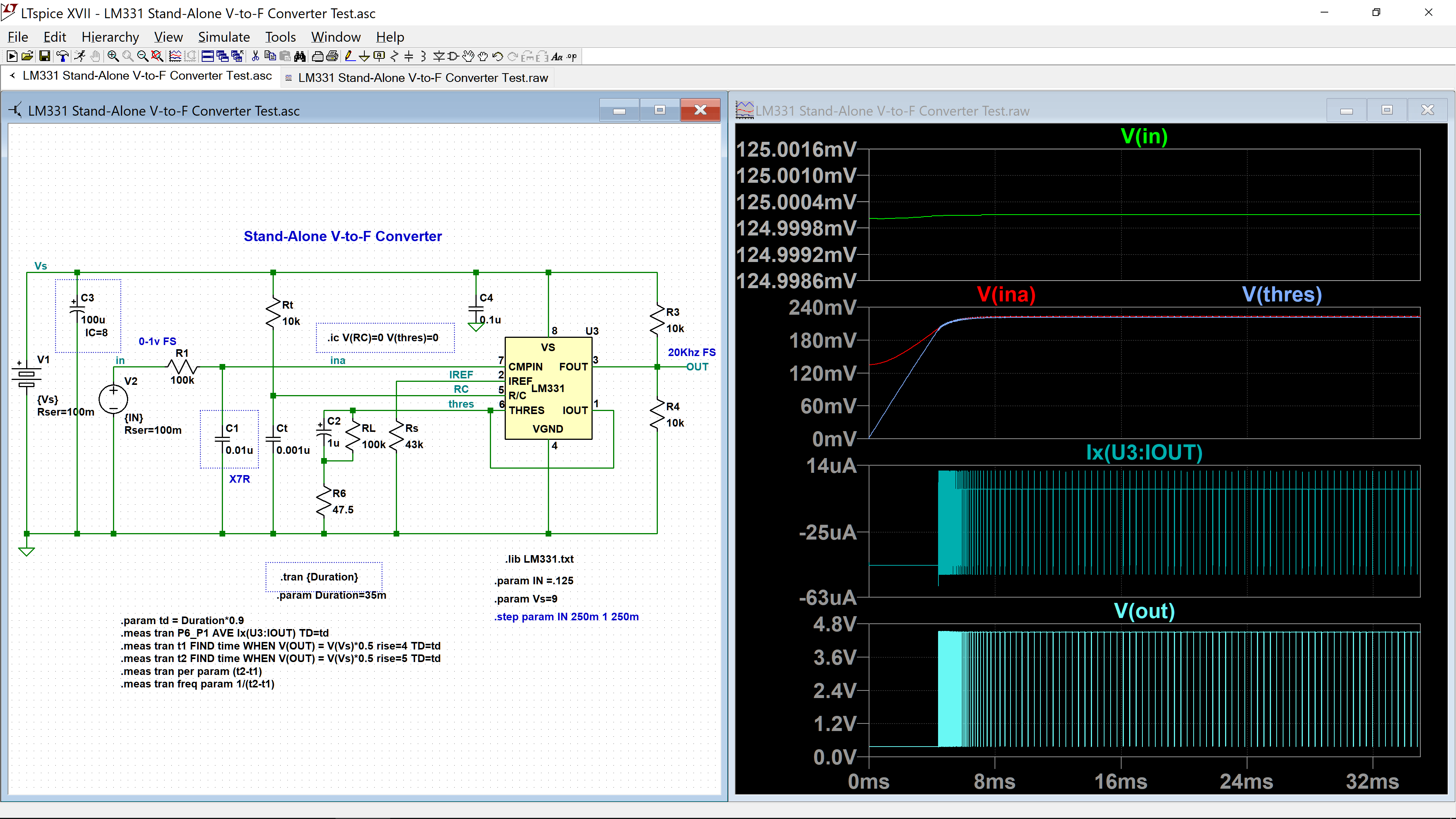

Model of LM331 for LTSpice
Yes, the only 1uF polarized cap is C2.
Noise suppression == C1
Attached V-F Theory of Operation
fritual
Will this work for you?
This is a transistor based model. I think this is a more practical simulation duration than 500uS.
If so I'll post the files.
Clip from Logfile:
.OP point found by inspection.
p6_p1: ix(u3:iout)=-5.00096e-008
t1: time=0.0316679 at 0.0316679
t2: time=0.0317147 at 0.0317147
per: (t2-t1)=4.67939e-005
freq: 1/(t2-t1)=21370.3
Date: Fri Sep 11 07:44:05 2020
Total elapsed time: 21.367 seconds.

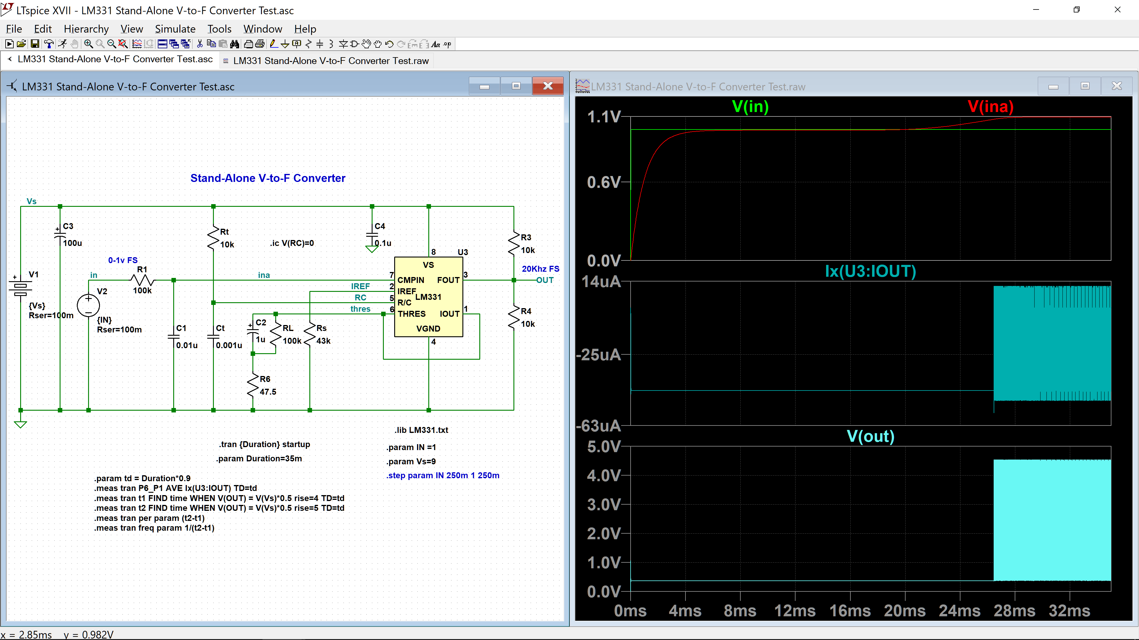

Ok...Here you go....let me know how it works out.
Attached my plot, leaving your schematic alone.
Since this is a TI part, can your LM331_Stand-Alone_V_to_F_Converter symbol and hierarchical data be used in their simulator?
I need to study SPICE directives, in your schematic, to prove it correlates to the *real* world.

TINA, which does appear to work using Wine.

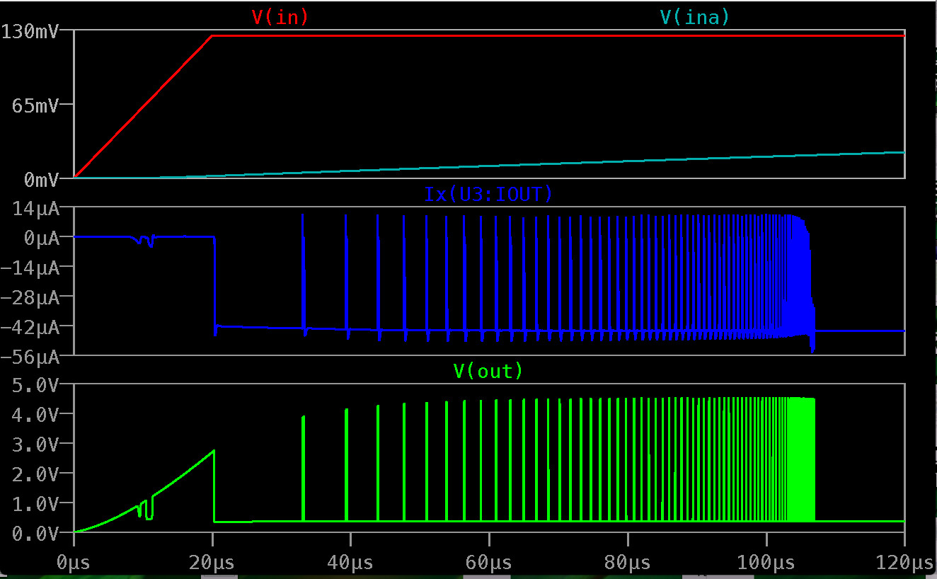

Fout duty cycle shouldn't deviate much from 50%.
Attachment looks more like a noise spike, changing .parm IN=.125/Duration=120u.
Perhaps I don't have linear sweep setup correctly.

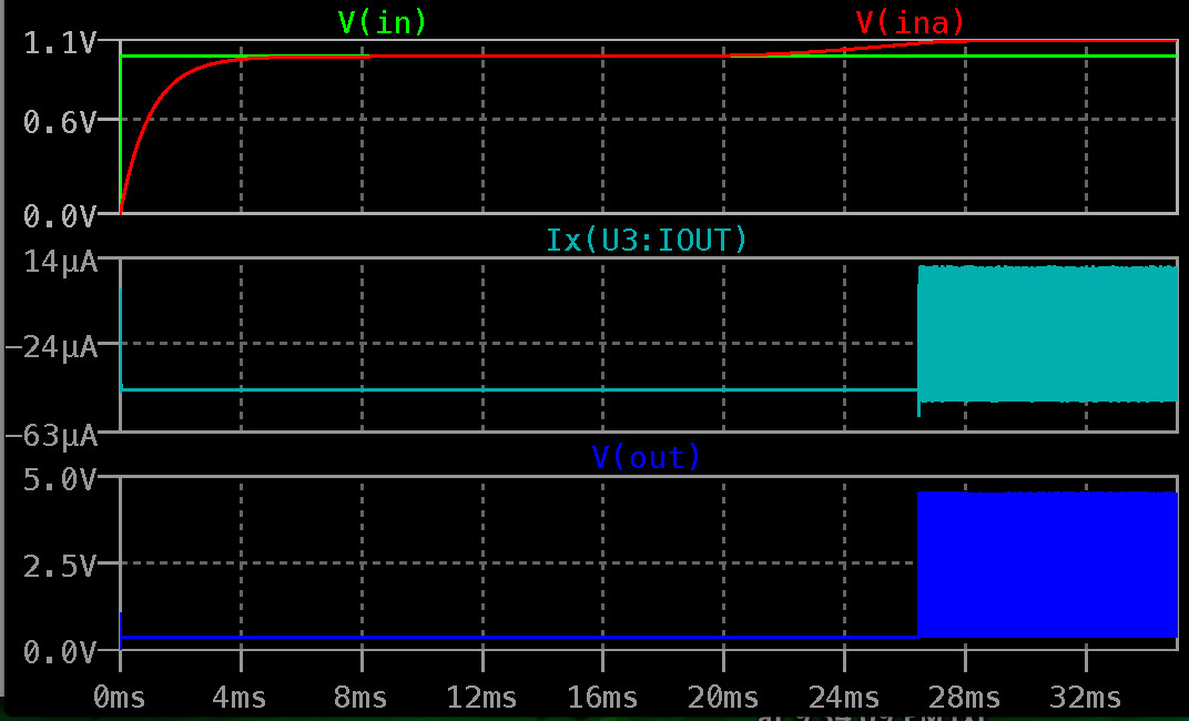

I don't see anywhere in the spec where Fout duty cycle is specified. The output pulse will be narrow and inverted. I don't think your allowing enough time for the output to settle. You can try ramping up the power supply over a few milliseconds.
If you want 50% duty cycle, I think you'll have to add a flip flop to the output and operate at half frequency or double the operating frequency. Its been awhile, but I have an LM331 on hand and guess I can build the VtoF again to verify.
Meanwhile, try this:
I've outlined the changes below.
1. I replaced C1 with an X7R cap over the existing one. The existing one had missing params. This is for the sim only...in real HW use a temperature stable cap like an NPO.
2. Removed "startup" directive. But now have to add IC statements.
Log file output:
p6_p1=0.035 FROM 0 TO 0.035
t1: time=0.0327774 at 0.0327774
t2: time=0.0331834 at 0.0331834
per: (t2-t1)=0.000405968
freq: 1/(t2-t1)=2463.25

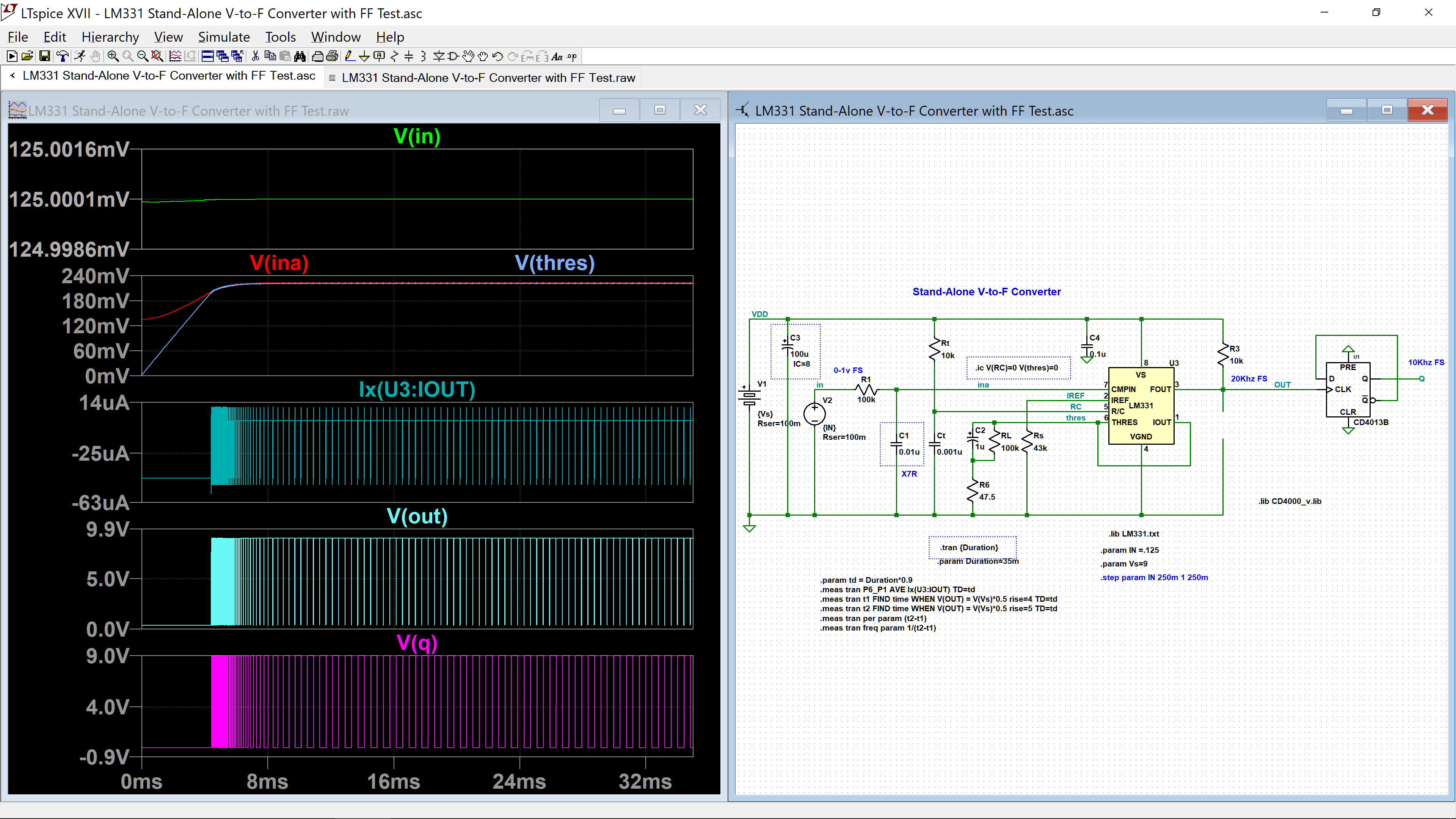

Symulation has shown Fout needs to be doubled and adding a FF. The maximum driving frequency I need must be limited to 25 khz and not deviate from 50% duty cycle. If you have any suggestions doubling the frequency, here is the formula: Fout = Vin * (Rs / 2.09 * RL * Rt * Ct).

Then you will have to use a flip flop at the output or use a different chip because the LM331 duty cycle varies and there is nothing in the TI spec that states the duty cycle.

No...it does not.
I could try pointing with the mouse in the waveform viewer but the .meas statements are more accurate.
The .meas statement results are in the log file. I've shown the results below the graph.
See below.
Log file:
t1: time=0.0321685 at 0.0321685
t2: time=0.0323603 at 0.0323603
per: (t2-t1)=0.000191795
freq: 1/(t2-t1)=5213.89 <-Fout at V(out)
t1_q: time=0.0329358 at 0.0329358
t2_q: time=0.0333192 at 0.0333192
per_q: (t2_q-t1_q)=0.000383426
freq_q: 1/(t2_q-t1_q)=2608.07 <---Fout at V(Q)

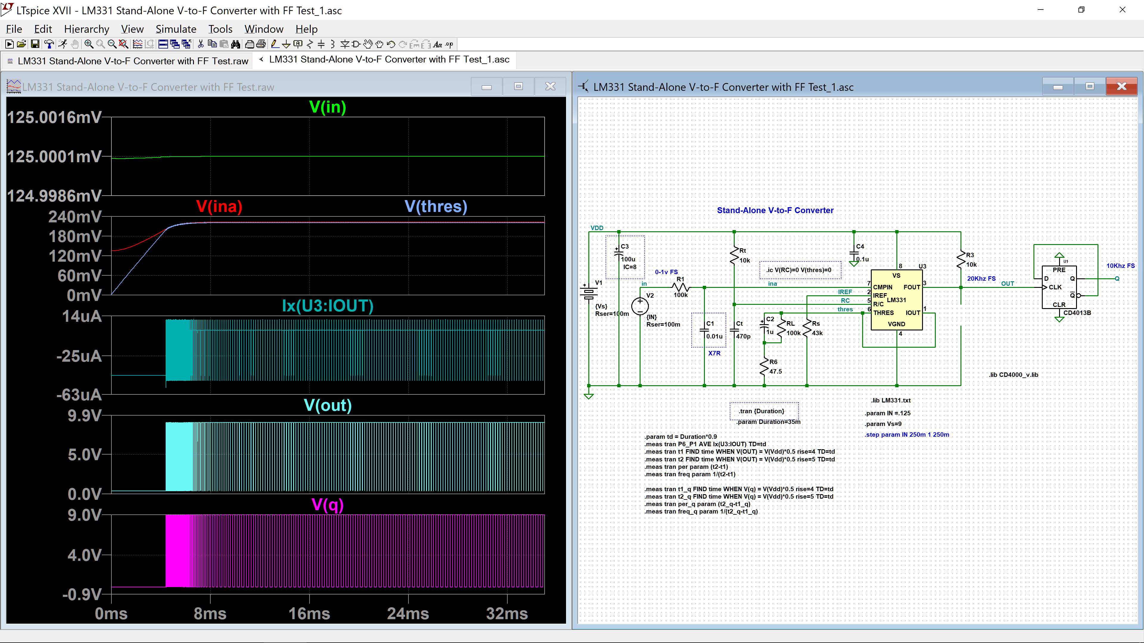

Did you intensionally remove R4, 10 K resistor? TTL would have a fit with 9 volts!
The cap appears to double frequency, that calculations reported V-F out == 43,775 Hz, while simulation == 5,214 Hz ?
I've attached ZX schematic showing 'EAR' having R34, 220 ohm to ground and C10, 10 nF & R33, 4K in series, feeding pin 20 of IC1.
Could this FF load be simulated, too?
  • zx-ear.pdf
Yes...you said nothing about TTL.....where did that come from?
So...use a different FF instead or level shift.
That's exactly what that value will do, it will set the LM331 to 43khz. The FF output will be half that frequency at 50% duty cycle..
Since you've set the input to 0.125mv, both outputs will scale accordingly. The simulation is correct.

Only 1 '.meas' statement functioned correctly in fritual's LOG file:
Measurement "t1" FAIL'ed
Measurement "t2" FAIL'ed
Measurement "per" FAIL'ed
Measurement "freq" FAIL'ed
Measurement "t1_q" FAIL'ed
Measurement "t2_2" FAIL'ed
Measurement "per_q" FAIL'ed
Measurement "freq_q" FAIL'ed
Please help resolve the other 8 fail'ed '.meas' statements.
