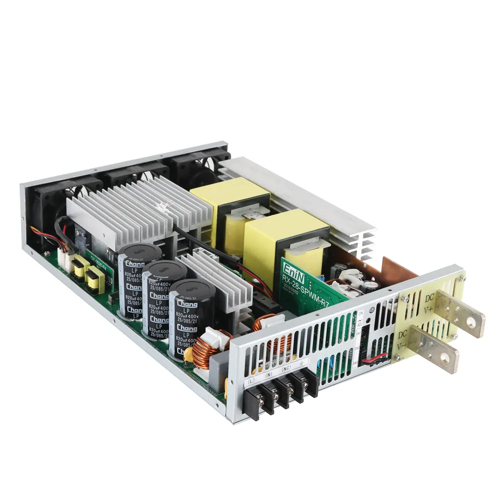

AC-DC converter (230v,AC to 28v DC ,147 A) - it can be readily available IC or design
There is no "single IC" solution, the power rating is orders of magnitude too high.
That system will be handling power input in excess of 4000 Watts - into the range of industrial welding machines and too great a power for normal domestic outlets.
It is a very complex and specialised design, which in a DIY version is very likely to destroy many expensive parts during its development and testing!
This is a commercial PSU with similar ratings, around 170A @ 28V:
(Many "24V" PSUs are adjustable up to 28V).
They are almost 500mm long and weigh around 10Kg!
This the an interior view of a similar but slightly lower power one:
I've been designing electronics as a profession for over 40 years, and I would not consider trying to design anything comparable - it's a very specialised field, and you could well get through many thousands of pounds worth of parts before ending up with a workable product.
It's worthwhile for companies that will be mass-producing them, but not otherwise!
