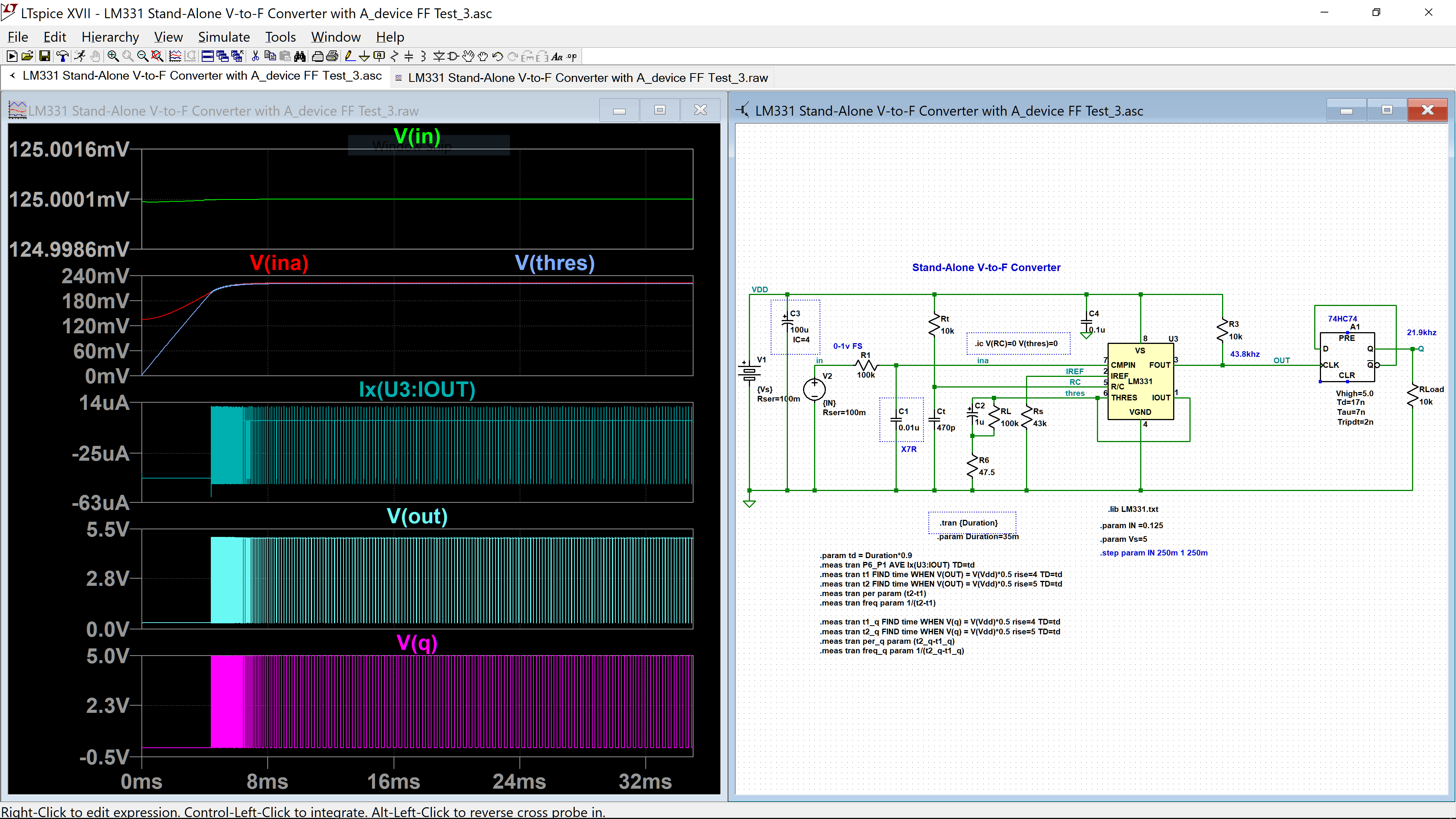

See attachment . . .
LOG file is now down to 4 fail'ed '.meas' statements:
p6_p1=0.035 FROM 0 TO 0.035
t1: time=0.0321918 at 0.0321918
t2: time=0.0323835 at 0.0323835
per: (t2-t1)=0.000191633
freq: 1/(t2-t1)=5218.3
Measurement "t1_q" FAIL'ed
Measurement "t2_2" FAIL'ed
Measurement "per_q" FAIL'ed
Measurement "freq_q" FAIL'ed

Used generic DFLOP, instead of the CD4013B FF.

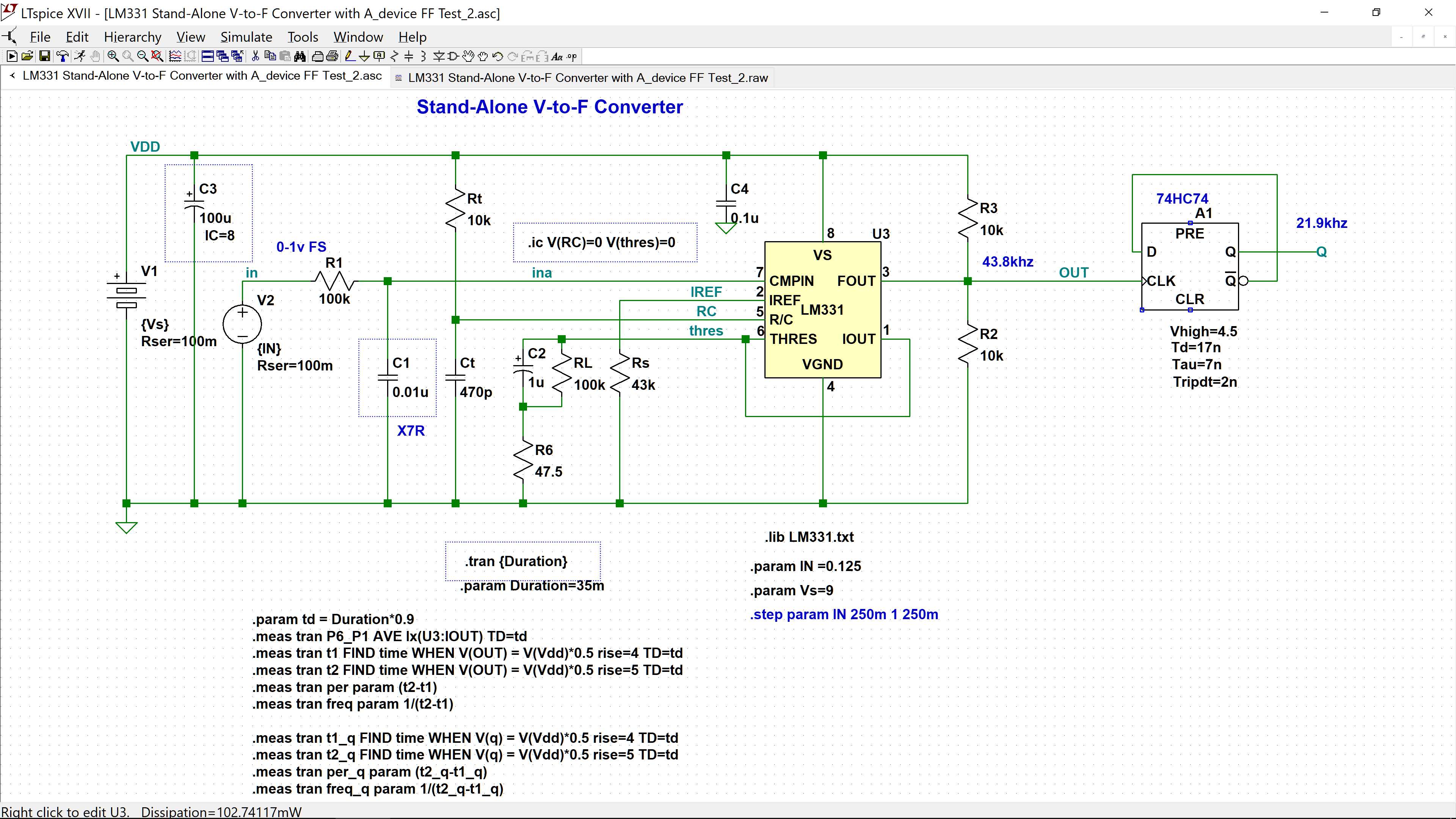

Change the wire label at FF output so that it matches the value used in the meas statements
For example:
change the wire label at the FF output from "Vq" to just "q"
Also:

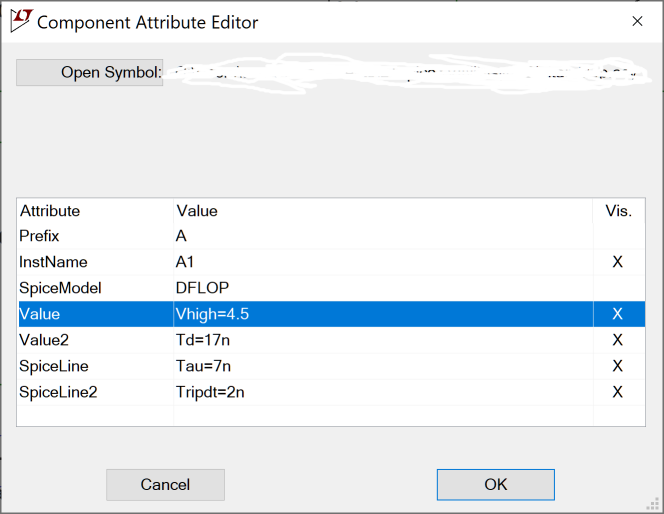

When using the digital "A device", set the following internal params so that it switches with reasonable characteristics
(right-click on symbol):
Vhigh=4.5 <-----logic high
Td=200n <-----Prop delay
Tau=20n <-----trise/tfall
Tripdt=2n <----sensitivity
Remove the ground connections from FF "pre" and "clr" or insert a resistor from each terminal to ground.
(This is for "A device" simulation purposes only)
Otherwise its behavior may be misleading.
Review "A device" help for param settings.

Changed FF output to 'q'.
Removed FF ground connections.
Where's any 'A device' help docs found and please translate 'A device' internal params. I found only what's in attachment, which also shows the 1 volt swing for V(q).
The following warning were flagged, plus the same '.meas' statement failures.
Attachment has the only FF I used in my electronics, the 74HC74 Dual-D, able to drive 10 LSTTL loads.
WARNING: Less than two connections to node Q. This node is used by A1.

1. You'll have to look in "Help" for "A device" info.
2. You forgot to remove the FF ground connections.
3. Your schematic should look like below.
Question:
Why don't you just run the whole circuit with a 5v supply (then remove R2)?
DFlop Component Attribute settings:
Question:
Agree on a 5v supply, after seeing attachment!

This is warning that there is only one connection at the FF "Q" net.
You can ignore this warning or connect a 10k load resistor from FF "Q" to ground like I did.
You made a typing error in the second .meas statement.
change:
.meas tran T2_2 ........
to:
.meas tran T2_q
Also,
Change Dflop attribute value "Vhigh=4.5" to "Vhigh=5.0"
See Below.
