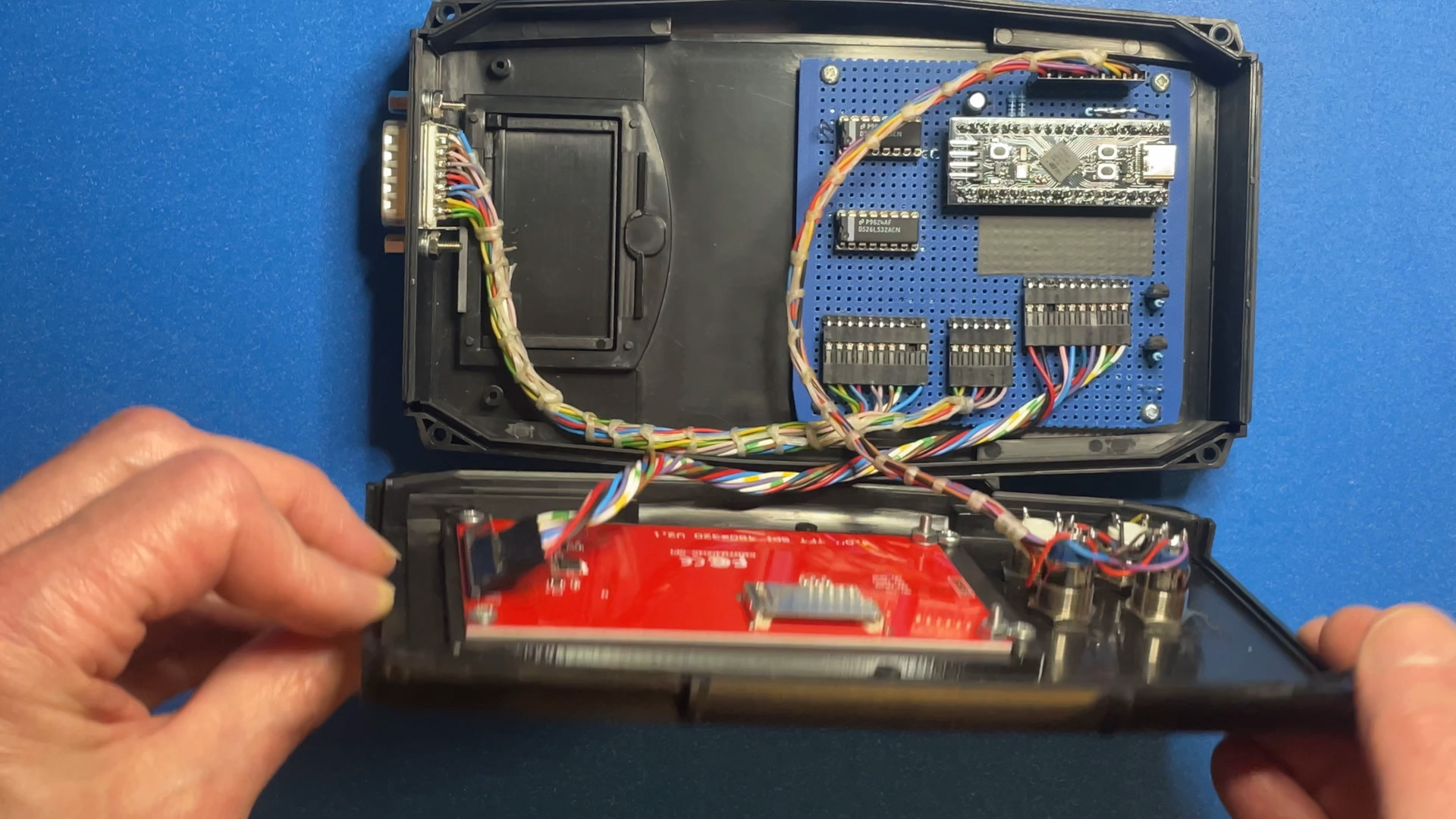

What construction technique do you use to make boards?
For testing the inrush limiter, just components strung together to the DC-DC module with load resistors attached.
For most prototypes / one-offs / test gear, stripboard, either normal stuff or ground plane, depending what it is. Then either point to point soldered connections or wire wrap.

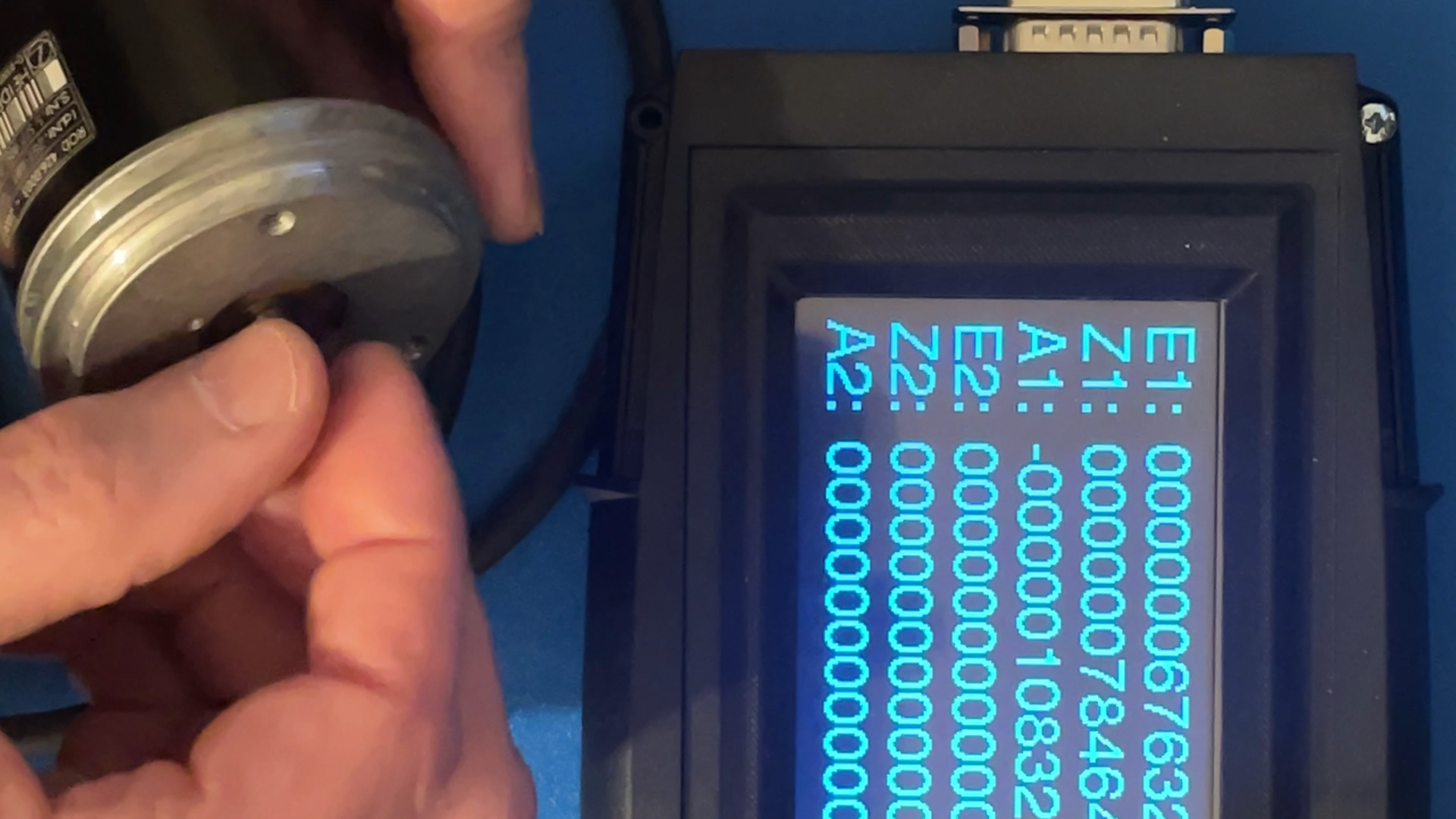

This is the last bit of test gear I built, a few weeks ago - I needed something to monitor the position encoders on a large machine tool, as one axis was not returning to the same position when referenced.
I knocked up a two channel counter that could monitor the encoder signal to the CNC:
Bench testing with an encoder:
