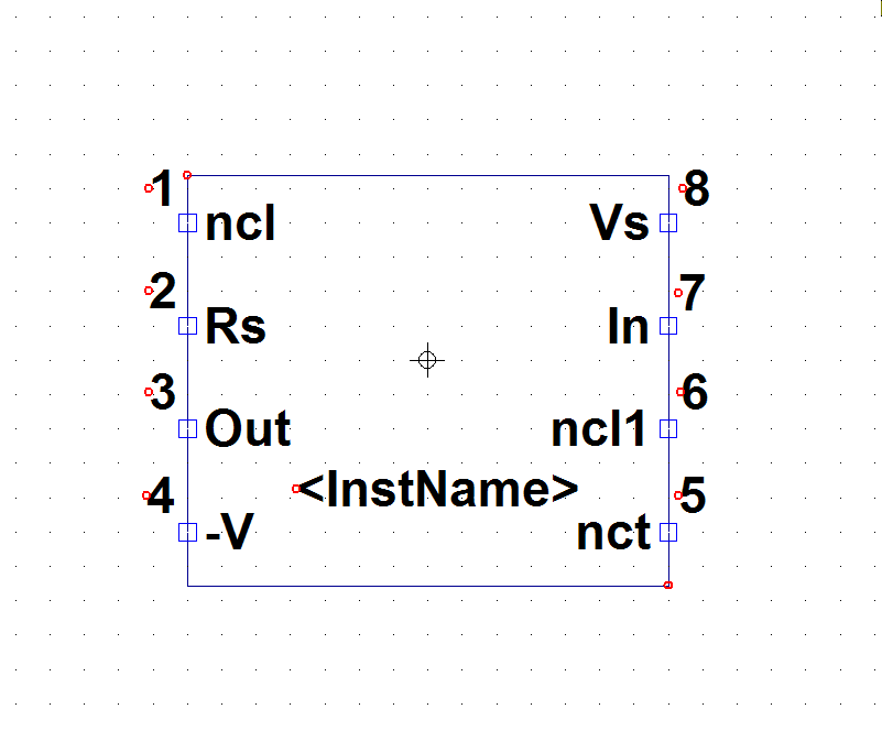

alec,
This a neater symbol, also added pin numbers
Change the file extension from txt to asy

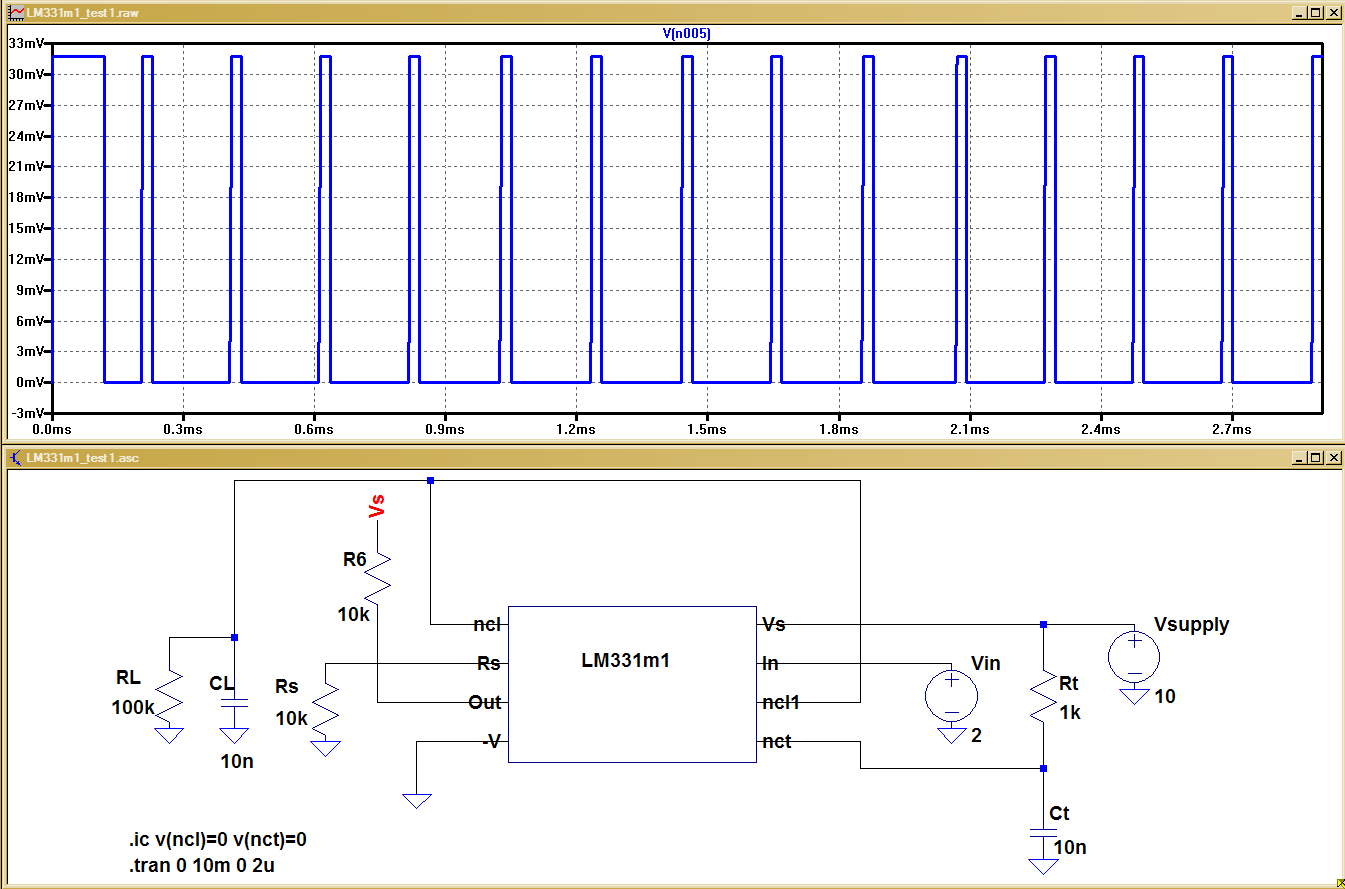

Hello Everyone. Thanks for the LTSpice model. I have one doubt though, Why the output voltage is limited to 30-32mV range? In the datasheet it is mentioned current output is some 120uA. But here it is not the case. Thanks
Hello,
In LM331_testm1.asc is a liitle bug. Pin of R6 connected to Vs should be connected to Vsupply. You will achieve impulses 0-10V.
  • LM331m1_test2.asc
Hello,

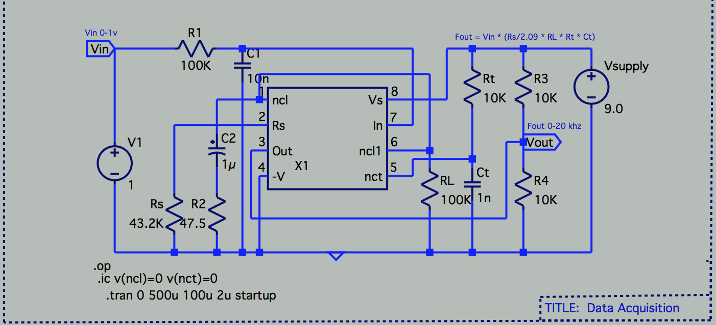

I figured this 3rd party model was worth experimenting on a V-F configuration of mine, after patching this bug.
The attached schematic functions in the *real* world, but fails to simulate!
This is my initial attempt using SPICE and would appreciate any help getting simulation to function, as well.
fritual
  • LM331m1_test3.asc
fritual

What is the measured V-to-F conversion values of your tested circuit?
2v FS in = ? Hz FS out
The attached spec sheet circuit should match LM331 TestRig.asc in post #1.
fritual
I seriously doubt the TestRig.asc will match the entire spec.
Can you provide specifics on which params in the specs your interested in?
You didn't provide the model and symbol. I have one I can provide.
Can you post a snapshot of the schematic?
Attached schematic shows conversion factor formula.
e.g., 1 v in == 20,574 hz out, max.
fritual
Current source, pin #1 that's fed back to pin #6.
The other concern is that the LTspice resistor's 'can' be polarized.
fritual
