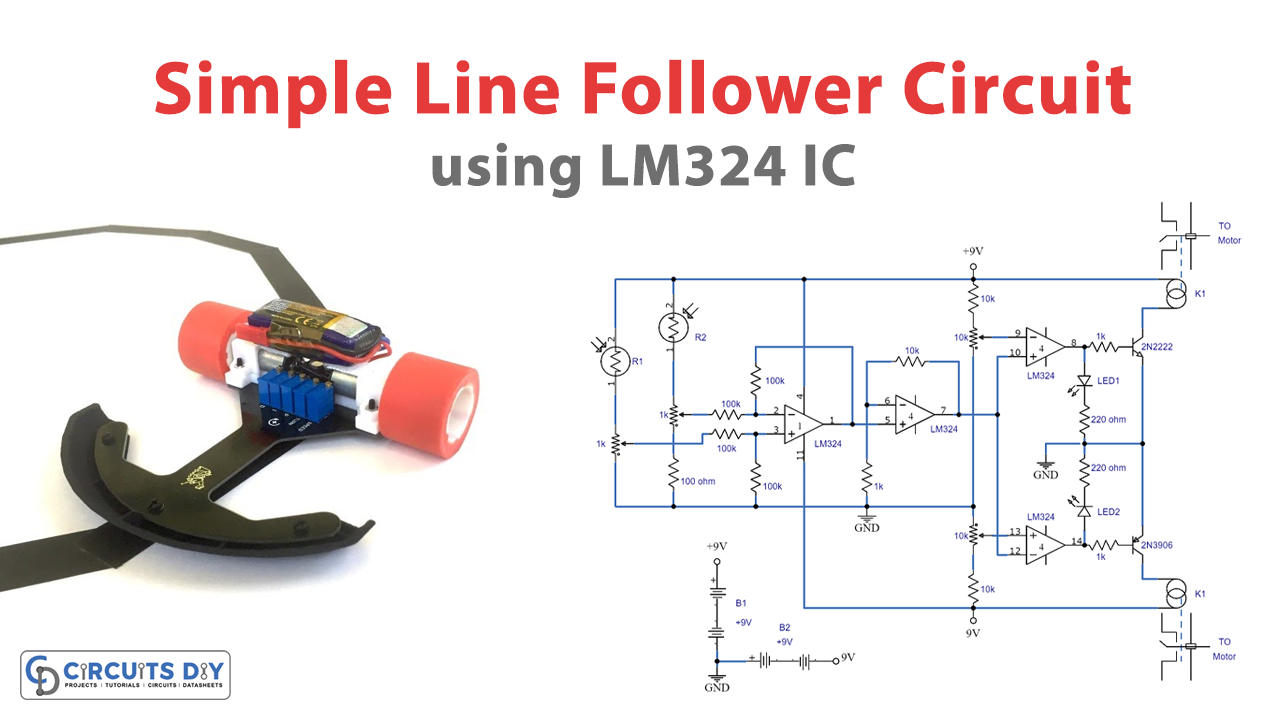

Line follower robot without a microcontroller
A light source aimed downwards and two photo sensors - LDRs, phototransistors etc., with appropriate bias or load resistors.
Use tubes around the sensors to make them directional and "aim" them down near the centreline of the robot, each just slightly to it's own side (left or right), mounted as far forward as possible.
If the robot is centred on the line, the two signals from the sensors should be equal, seeing the line. As it starts to drift off centre, one sensor or the other will start to leave the line.
Use the sensor balance or imbalance (such as a differential amplifier) to steer the robot. Equal signals means straight, if one signal start to drop steer proportionally towards the opposite side.
Add a two pole changeover switch to swap the sensor output, if you may need it to follow a black line rather than a white line.
(I built stuff like that back in the 70s).

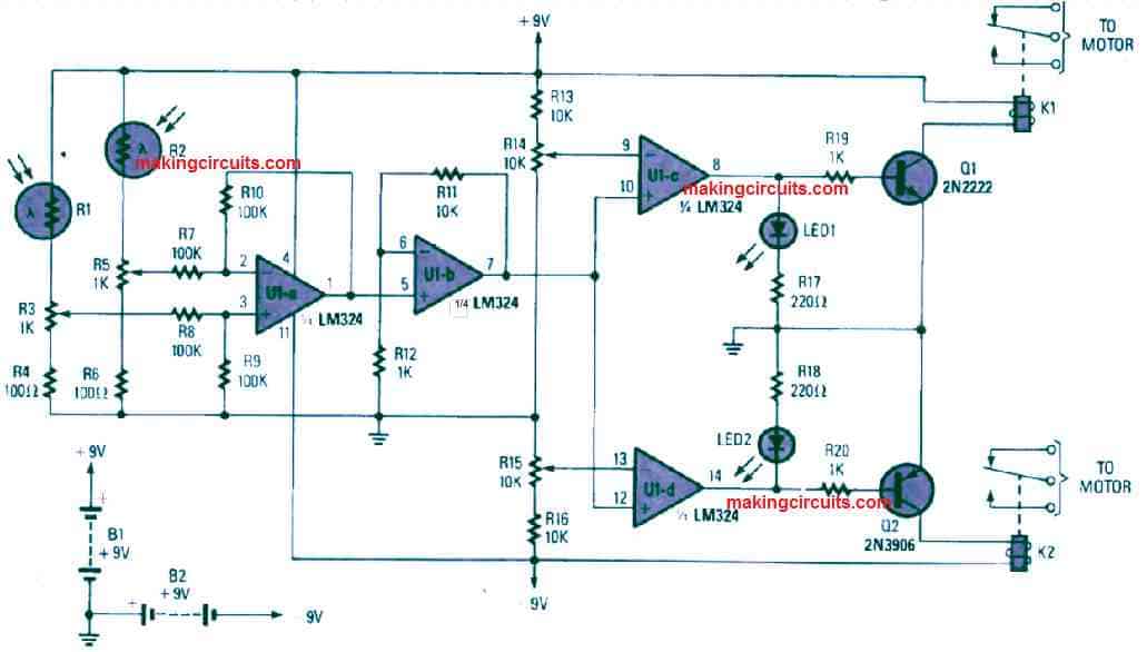

That is the same circuit on two different sites, and the circuit has issues.
1. This circuit places a large reverse voltage across the Q1 and Q2 base-emitter junctions. IIRC, this voltage exceeds the datasheet limits, and will lead to device failure.
2. The relay coils *must* have suppression diodes across the coils
3. There is no power supply decoupling across the IC.
4. The circuit places a large reverse voltage across the LEDs. Depending on the part, they might go into reverse breakdown. There could be some illumination in the "off" state.
If you don't want to mess with a two-battery circuit, it can be modified for operation on only one battery. Also, the output relays can be replaced with small power MOSFETs.

Of course the circuits could be modified with adding simple diodes in series,
1 in series with each current limiting R, for the LEDs and output transistor base
drive limiting R's.
