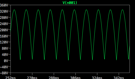

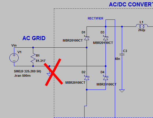

Your full wave bridge is not working. Remove the ground with the red X.
I do not know why R1.

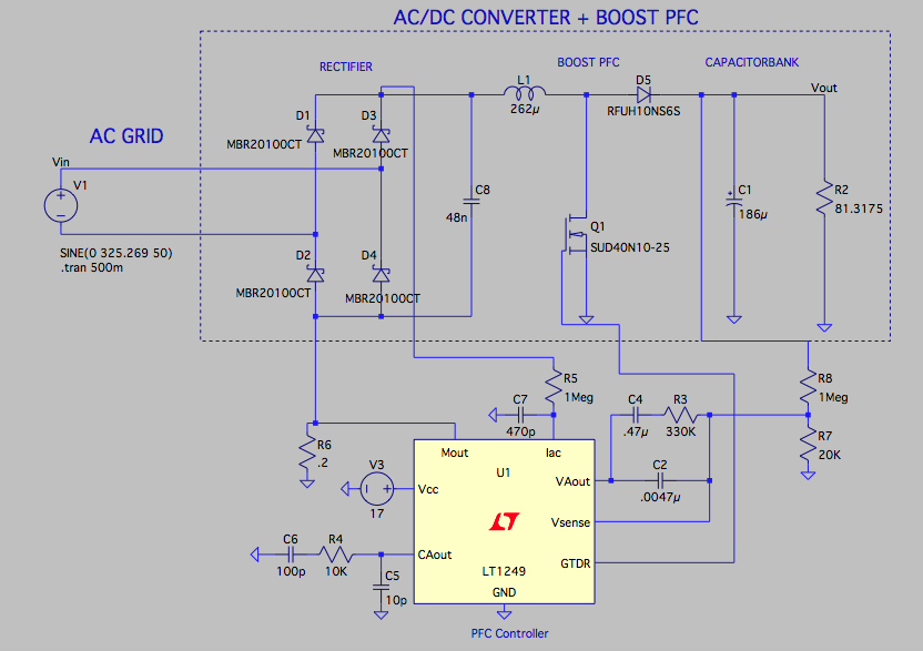

It is not working right. It looks like the frequency response of the error amp is not right. C2,4, R3.
I don't have time to fix it today.
For the C2, C4 and R3 are standard values from a demo for the LT1249, so I haven't change them yet. Yes, it would be great if you have some time to fix it as soonest you have time. Thank you very much, appreciate all your help.

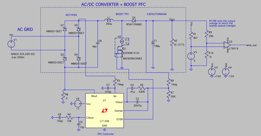

I updated the circuit a bit, I added the feedback that I was recommended to do earlier in order to get a more constant output voltage.

Feedback is provided by R8, R7.
What is the purpose of R1, R9, R10, V5 and U3?
Aha, I see. I have made a doubled feedback, in that case I remove R1, R9, R10, V5 and U3.
But do you think I can improve it in someway? Like to reduce the ripple and to make it more stable for a DC output?

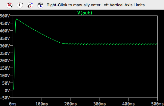

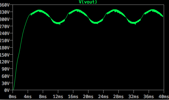

I made some changes. PFC circuits start up slowly. It takes about 250mS for it to get up and running stably.

Hmm, I see, it looks good. But is it strange the values that I calculated is not so similar to the simulated values?
I think I want to have the simulation values close as possible to the calculated ones, if possible.

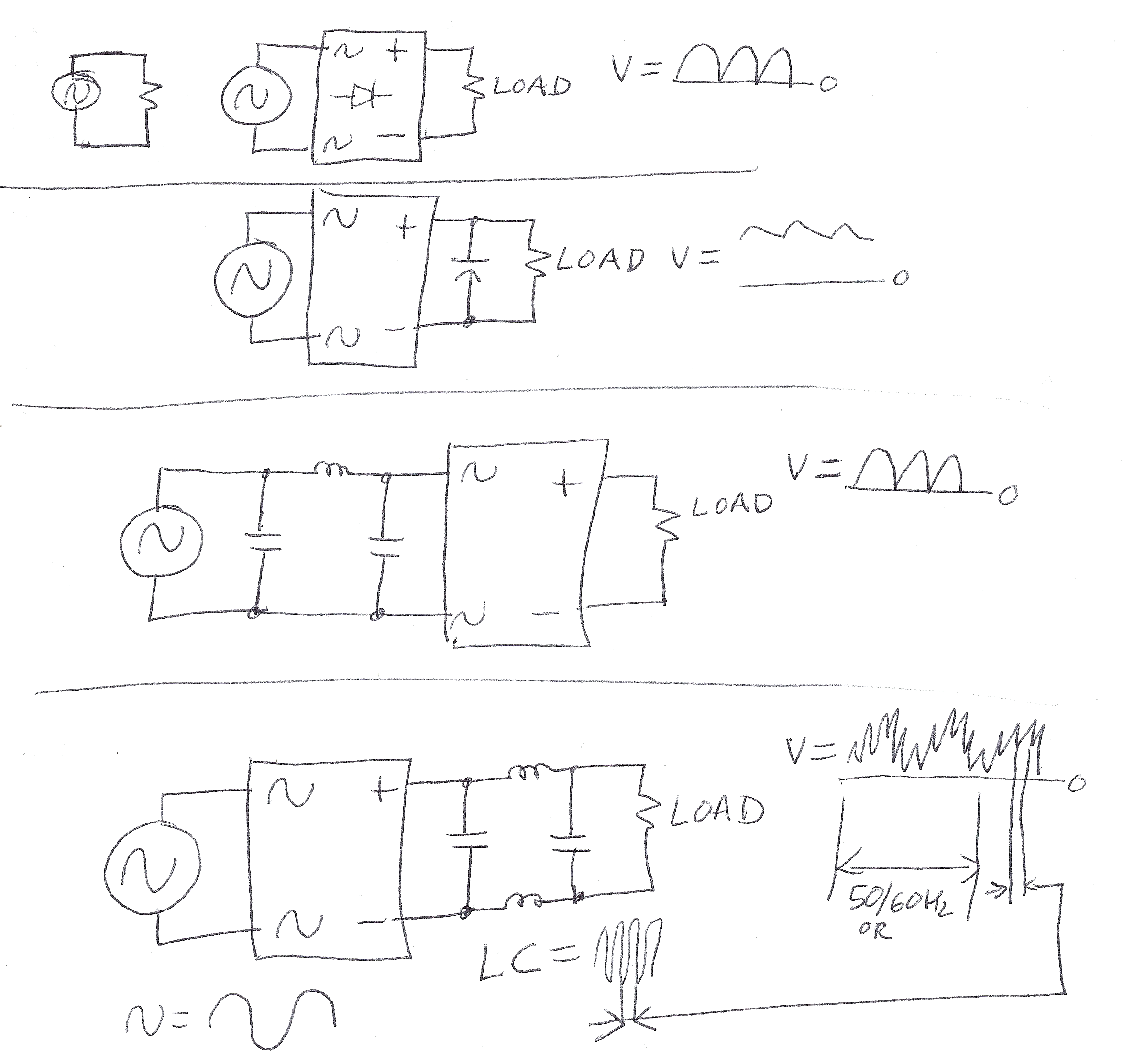

I have said this before but I am not clear. I will try again.

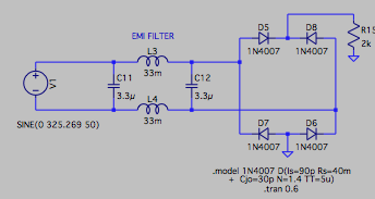

Circuit top left has good Power Factor. Power line and resistor.
Circuit top right has good Power Factor. Power line, 4-diodes, load.
Next circuit with a capacitor has bad PF!!! You can not have a large capacitor after the diodes!
Next circuit has the filter on the power line. Before the diodes. (not cap after the diodes)
Last circuit is yours. Capacitors after the diodes. AND You made a LC resonate circuit.
The voltage right after the diodes must be like the top right picture.
Please read and tell me why PF is important.
Please tell me why there can not be a capacitor after the diodes.
(load can be a PFC IC or a resistor)

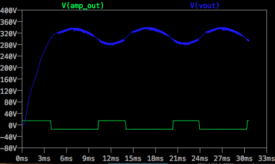

Sorry I made a misstake about the EMI filter, I know it should be before the diode bridge, and I got the same waveform as you mention above. See image.
PF is important since the current and output voltage should be in phase with each other, and to utilize the whole energy avoid too much losses.
But what I understand it should be a capacitor after the diodes in order to smoothing out the waveforms?

Try setting initial conditions for the EMI filter inductors by placing a directive on the schematic:
.IC I(L3)=0 I(L4)=0
add 100m serial resistance to voltage source V1
and add some serial resistance to the EMI capacitors C11 and C12.

Ah, thank you. It seems to work now. But, I got overshoot in the beginning of the simulation, is it because to reduce that overshoot? May it be because I have design the resistors R6 and R5 to be 400 voltage out?
