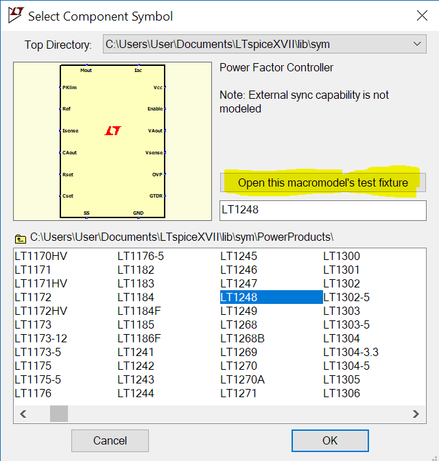

Do you how to change the switching frequency to 150 kHz?
No. The LT8312 doesn't use a fixed oscillation frequency. It operates in the 'critical conduction mode' with a varying frequency which is load dependent and is a result of the power factor correction method that the IC uses.
Do you think its better to use the LT1249 instead? Its operating for 100 kHz fixed, but I can maybe assume its "close enough" to 150 kHz.
Why are you determined to use 150kHz?
Cause I need to reduce the component size in my design. The old design had 100 kHz, so that's why I need to increase the frequency.
but there is no standard demo for it
Yes there is.
The resistor and capacitor on the Rset and Cset pins determine the oscillation frequency.

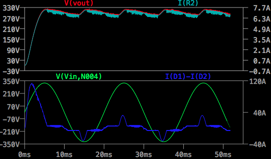

Yes I noticed that, thank you. I have selected 150 kHz. Alec_t, could you please check my LT1248 circuit? I think it works now.
  • ACDC_PFC_LT1248.asc
It works, but whether or not the component values are optimised for a 50Hz mains input and your chosen output voltage, I don't know.

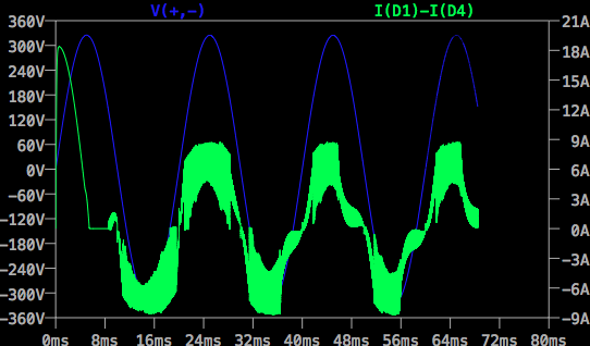

I think I understand your suggestion, and yes, I agree with you that the interleaved do not need to be perfect.
I tried with LT1249, with 100 kHz internally in the IC-circuit, and I put a delay on the voltage source to connected to VCVS circuit.
The output looks okay, but I think the PFC doesn't work properly, since there is current spikes in the input. Maybe it is something with the switching parameters that needs to be adjusted?
  • OBC_INTERLEAVED_ACDC_LT1249.asc
The gate drive arrangement to Q2 is wrong. Q2 source is floating. Try using a BV device with the 'delay' function.
You mean like this? or should I remove the whole VCVS circuit. What do you mean Q2 is floating? Is there something missing in the connections?
