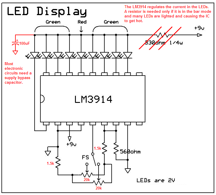

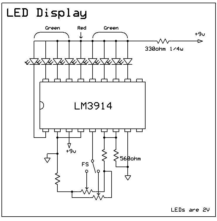

Ok so this is how you recommended to setup the IC correct?
Also since all those resistors are in parallel with the 560ohm won't I have to adjust it's value so that the total resistance among all those resistors are 560ohm?
1) You don't need the 330 ohm resistor in series with the LEDs because the LM3914 regulates the current in the LEDs.
A resistor is needed if the IC is in the bar mode and many LEDs are lighted then their total current is high which would cause the IC to get too hot.
2) Every electronic circuit should have a supply bypass capacitor.
3) The resistors and the 10k resistance of pin 6 are in parallel with the 560 ohm resistor creating a total resistance of 510 ohms. Then the LED current is 12.5/510= 25mA.
I think I calculated the resistors so that the 1st LED lights when the selected pot is at minimum and the 9th LED lights when the pot is at max. Then the middle LED will light when a pot is in the middle.
