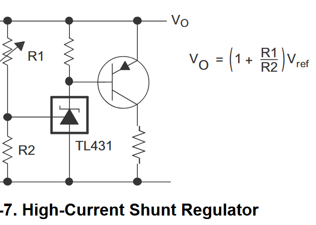

Hi there. Some lithium tool batteries have a tendency to go out of balance over long periods, such as Milwaukee's notorious HD 9.0 and 12.0 batteries (the ones I have). They don't have built in cell balancing (even though they have hardware for it), so I'm trying to think about ways to add it. I've seen some people add balance leads for an external balance charger, but I'd rather find a way to add internal balancing so I can keep using my Milwaukee chargers. However I haven't found any balancing boards that are quite small enough to fit inside the existing case. So first question is: does anyone know of any very small (even if very low current and passive) balance boards? Like 15mmx20mm or smaller, and thin. If not, my other idea is to design one using 4.1V zener diodes with 10ohm resistors to create a sort of pseudo-balance board so as they charge up, if they're out of balance, the highest ones will slowly drain to allow the lower ones to catch up. Should this theoretically work the way I am expecting, or am I missing something about circuit design? Thanks!

Zeners must be able to shunt all the power pumped into each cell, so I suspect your Zener solution will burn up.
Tell us the max power under CC at say 4V. I would use something more accurate like a TL431 and a power resistor on the PNP collector to dissipate the power outside and place on the bottom. This will a ribbon cable inside or magnet wires to drive the power resistors at 3V at max CC. Chose >>2x power rating to cut the temp rise to 125'C << 50%.
Thank you for this simple circuit. But I'm not sure what you mean about the Zener needing to shunt all the power and burning up. My plan was to use a resisitor (probably 10Ohm) to limit current. And since the Milwaukee charger has cell monitoring, it won't let any cell charge over 4.2V (unless there's a major failure). With a 10Ohm resistor that would limit current to 10mA, which should be fine. The battery will often spend days at a time sitting unused. The worse case scenario (barring a major failure of course) would be that they never charge over 4.1 and therefore don't ever get a chance to balance.
Also I'm sorry, I'm not really good with this stuff, so I don't quite understand what you mean with most of the second section, but the maximum current would be I believe 600mA based one my understanding of how they operate.
