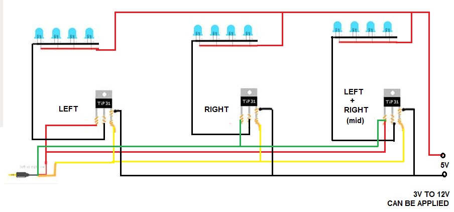

what i did is hooked 3xtip31 to 3set of leds one with left and other with right and the last with combination of left+right but all blink the same with low intensity HELP
without seeing your schematic then we don't know what you connected to what.
The circuit is HORRIBLE:

Have attached the circuit this time exact what i have designed

I have done that in last strip of led right+left = mono isnt it ? if am not wrong
since during these many days i have found that connecting these two channels create a mid pass filter which is not with me
All blink same nothing diff and all with same intensity

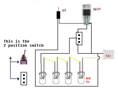

You are simply shorting the two channels together which will destroy an amplifier if the input signals are speaker levels. Then all of your outputs are mono. You are supposed to use an audio mixer circuit to make mono. Some audio mixers are simply two resistors.
Your circuit has no filter. You need an active bandpass filter or an active lowpass filter to make only bass sounds.
Because you simply shorted the left and right channels together so they produce mono exactly ther same.

1) Your circuit is missing input resistors so the base-emitter junction of each transistor shorts the input signal which will destroy a speaker amplifier and/or destroy the transistors.
2) Your circuit is missing rectifier diodes so a speaker level will destroy the transistors (their max allowed reverse voltage is only 5V).
3) Your circuit is missing resistors to limit the current to the LEDs. Then the LEDs burn out.
4) Your circuit has LEDs in parallel which is wrong because all LEDs are different. An LED with the lowest forward voltage will hog all the current and burn out. Then the next LED with the lowest forward voltage will burn out.
Since you know nothing about electronics then I suggest that you buy a kit for a color organ.
