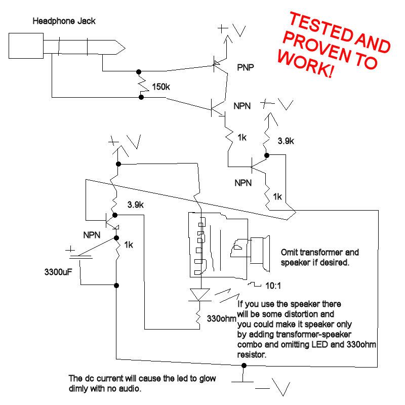

EUREKA!
(this is an accidental invention.)
catcat said:
EUREKA!
It is accidental, all right!
The 1st 3 transistors don't do anything and the 4th transistor isn't biased correctly. The 3300uF capacitor has such a high value that the 4th transistor has a frequency response down to .05Hz. Only 3.3uF to 10uF is needed for audio.
hey audioguru does this look like a good little circuit? it seems to work but i need someones opinion **broken link removed** i dont know if you'll even get this.. but if anyone does can you tell me if it might work or not, thanks!
Hi Ballpoint,
This circuit is nearly as bad as the other one.
1) If the music source has a coupling capacitor, then the LED is on without music.
2) Music causes the transistors to be rectifiers that switch the LED off for each half-cycle of sounds.
3) The LED doesn't get brighter when the music is louder then dimmer when the music is softer.
4) The input of the 1st transistor is like a dead short to the music source.
ballpoint said:
He had a video of it working on there though.. you're saying it wont work at all?
It follows the music, sometimes.
The LED is lighted when there is no sound.
Sometimes sounds turn it off, sometimes they turn it on.
The circuit doesn't know if it is coming or if it is going.
In my circuits the brightness of the LED is the same as the loudness of the sound. Very short duration sounds are lengthened so that their loudness can be seen.

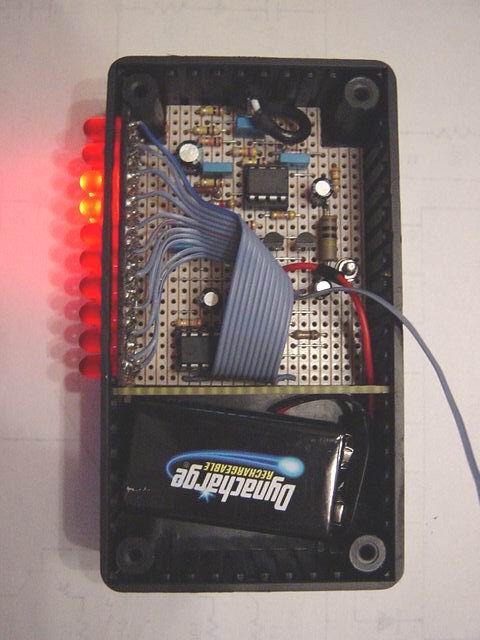

My circuit simply converts the loudness of sounds into current for the LED.
This is my Sound Level Indicator project with its 20 LEDs that display the volume of sounds and it has a microphone and a rechargable battery. It can pickup the sound of a pin dropping on the floor on the other side of the room, or a very loud bass beat. The 20 LEDs can be switched to turn on in a bar, or in a dot as shown here:

Thats cool.. but probably alittle too advanced for me right now, i was just bored and thought about geting some leds to pulse to music for fun.. i found this site and then read all that has already been posted. ill see what i can do, thanks for your help!
