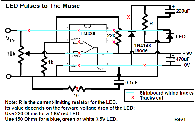

People say that this circuit works well. It stretches the pulse width to make the LED more visible.
Use it with the line level or headphone output of a CD or MP3 player. It might blow up with an output of a power amplifier unless an attenuator is added to the input.

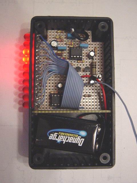

I have a project with 20 LEDs in a bar-graph. It is sensitive enough to indicate a pin dropping on the floor on the other side of a room. It has a microphone and a rechargable battery. It flashes to the beat really well.

Then each LED needs a 180 ohm resistor in series with it, as shown in my circuit by the 220 ohm resistor. Use 1000uF instead of 220uF for 3 or 4 LEDs with resistors. Use a 1N4001 diode instead of the one I have shown.
And explain those teal lines and x's...
Stripboard has parallel copper tracks on it and is perforated. The lines are the tracks and the x's are where the track is cut with a drill bit. Stripboard is like a pcb where half the wiring is already done for you.

-Resistors (10k, 10k, 1k, 22k)
No. 10k volume control, 10 ohms, the 1k and 22k are correct. Don't forget to get a 180 ohm resistor for each LED.
-Capacitors (.1, 470, 220)
No. Capacitor values are in pF, nF, uF and even F.
Instead of the 220uF, use 1000uF if you have 3 or 4 LEDs.
-LM386<-------- what exactly is this, another name??
It is a 1/2W audio power amplifier made by National Semiconductor. RadioShack should have it.
-9 Volt battery
Instead, use a wall AC-DC adapter if you want. Get a battery connector if you use a battery.
-1n4148 diode
Use a 1N4001 diode if you have more than 1 LED.

Their complete value in uF is on my schematic.
And how do i know the voltage of the capacitors, like some say different voltages?(Which one should I get?)
The power supply is 9V so use capacitors with a minimum voltage rating of 16V. 25V or 35V capacitors will also be fine.

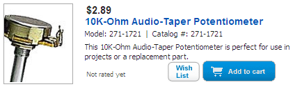

Possibly show me where to get a 10k vol control? Could not find one.
You like RadioShack then use a RadioShack 10k volume control. Get a knob for it there too.
Whats the "R" next to the resistor?
Because its resistance must match the voltage rating of the LED as in the chart. You say your LEDs are 2.1V so use a 180 ohm resistor in series with each LED.
And hopefully my final question, the resisitors should be __ohms, 1/4 watts?
Yes. 1/2W is also fine but they are larger.
