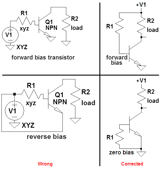

this is the circuit of reverse-2 biased and forward-2 bias.
  • Draft1.asc
  • edw.asc
WHAT is an ASC Extension?
I Can't View these.
How About Posting a "JPG or GIF" File?
Your transistor circuits are both WRONG.
1) The first transistor might have its base-emitter forward-biased if the V1 voltage is 0.7V or higher but the transistor does nothing because the emitter voltage and the load's supply voltage are the same at 0V.
2) The second transistor has no base-emitter bias voltage because they both have the same voltage. So the transistor does not conduct and is turned off. The voltage at the load is backwards.
I corrected your schematics:
you are right sir, my practical circuit was also same in hurry i made connection wrong but second fig. of transistor zero bias of transistor should be a pnp transistor not npn, i thick so.
