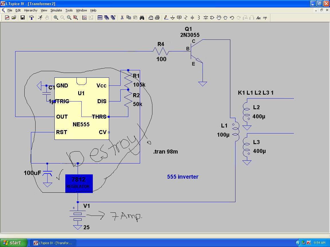

Inverter.........!

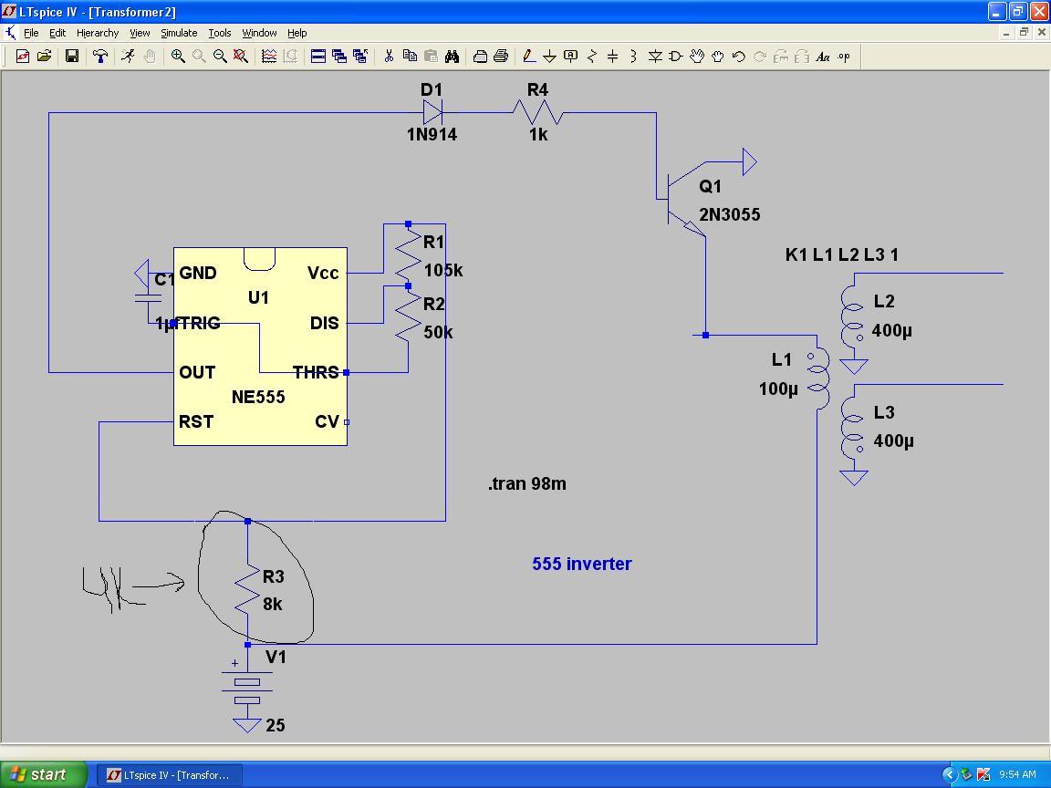

here is schematic of my circuit..!

To 101. It is really wrong circuit cause the coil has located between the emitter and common clamp of driver. You must have it or other loads put between collector and source supply.
1) You have the 2N3055 transistor connected backwards. Since you show it an an emitter-follower then its collector should connect to the positive supply (you have it connected to ground) and the transformer primary winding should be connected to ground (you have it connected to +25V).
2) The max allowed supply voltage for a 555 timer IC is 18V but it is spec'd with a max of 15. Yours is 25V which is much too high.
3) The resistor R3 plus the resistor R4 add to reduce the base current of the 2n3055 transistor to almost nothing.
If you use a 12V supply so that the 555 is not destroyed then the base current of the 2N5555 can be the 200mA max allowed current from the 555. The output voltage of the 555 goes to only +9.5V so the base resistor has 8.5V across it and can be (8.5V/200mA)= 42.5 ohms. The diode is not needed.
The 2N3055 transistor saturates pretty well if its collector current is 10 times its base current so its collector current can be only 2A. Then the max output power is only (12V x 2A)= 24W but since the transistor is turned on for only half the time then the output power is only 12W.
An inverter with an output of only 12W is useless. I can buy a little 75W inverter for $10.00. A 300W inverter costs only $50.00.
If you want more power then the transformer must be driven with two transistors in push-pull so that there is always one transistor conductiong into the transformer. Since you are using old-fashioned transistors instead of Mosfets then the transistors need to have a driver transistor to provide plenty of base current.
If you want more power then the transformer must be driven with two transistors in push-pull so that there is always one transistor conducting into the transformer. Since you are using old-fashioned transistors instead of Mosfets then the transistors need to have a driver transistor to provide plenty of base current.

Since your 8k resistor plus 1k resistor between the 555 and the transistor limits the base current of the transistor to only 2.4mA then the output current of the transistor is only 24mA but only when it conducts.
But the output of a 555 has a max push-pull current of 200mA. Then it could use a suitable current-limiting resistor that will give a base current of 200mA to the transistor so the output of the transistor can be 2A.
Complementary emitter-follower transistors can replace the single 2N3055 transistor for a high current push-pull output.
If you add a driver transistor in between then the output of the 2N3055 transistor can be 8A if you want.

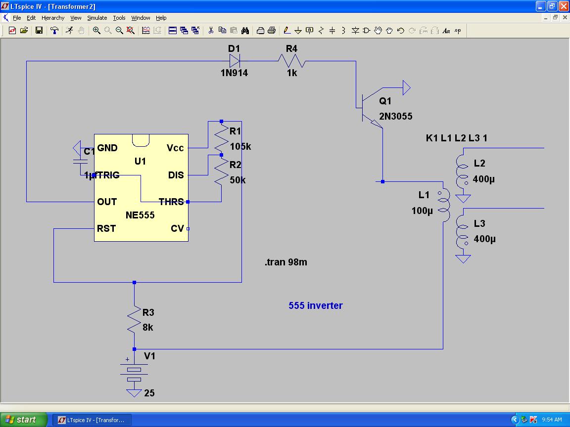

here is schematic and i have using almost all component like darling ton(508d),mosfet,2n3055. for amplification giving almost same output.
now, the resistance of 4k is of 2W, pls tell it does matter the watt of resistance??

This Should Work Better.
But it is Still a VERY POOR DESIGN!

The 4k resistor is not a voltage regulator and the transistor is still backwards!

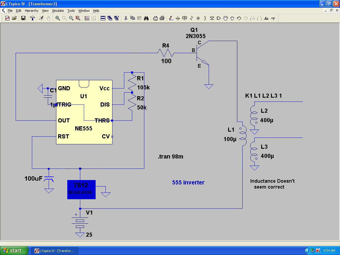

Sorry a Previous Error.
Here is the Correct Schematic.
But it is still a VERY POOR CIRCUIT.
And If the values of your transformer are in Micro-Henries, They are Totally Incorrect for such a Low Frequency!

the transformer shown is not used as same, it is simple step down 18V transformer.
as you have connected 7812 it limit is 1amp and when i will give 25V with 7amp, i thick it will destroy.
NO IT WON'T.
The 7812 Will ONLY use the Current Required to drive the 555.
Even if your battery was 10,000 Amps, it Wouldn't matter.
This is a VERY BASIC ELECTRONIC PRINCIPAL.

A transformer for a frequency of 100MHz uses inductances in hundreds of micro-henries. I think your transformer is for only 50Hz so its windings must have inductances much much higher.
But you are saying that the transformer are in micro henry??
For a frequency of 50 Hz and 24 Volts on the Primary, You Probably need an Inductance of around 100 Milli-Henry.
(100 Milli-Henry is 100,000 Micro-Henrys.)
