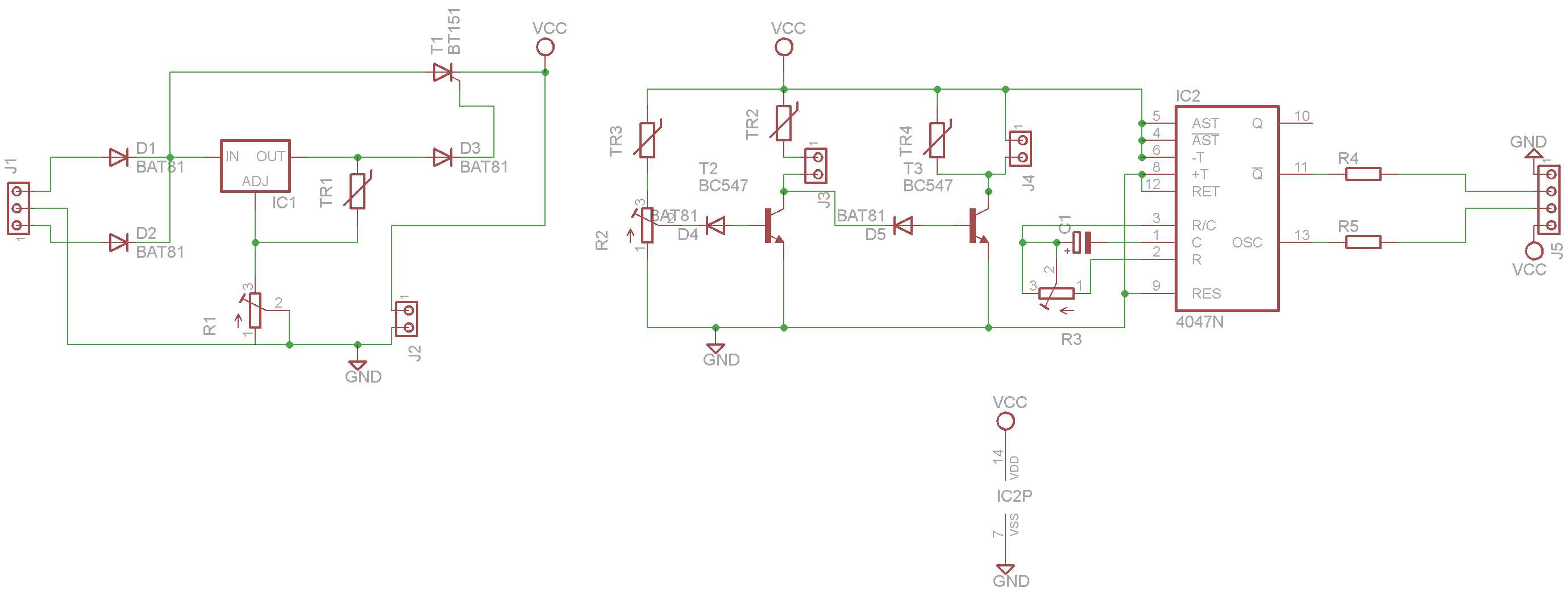

This is one of my designs.
the output must be interface with 3055 transistors mounted on proper heat sinks.
the thermistors are to be replaced with resistors. (assembled in a hurry)
