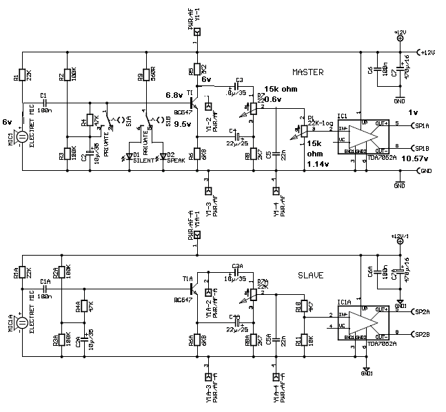

i was try the master circuit , measuring those part with Gnd, and the voltage i measured as list, i dunno why the base of transistor input so high , and the mike seem not worked....
and when i measure output 5 & 8 from the TDA7052a, the circuit became short circuit.... zero voltage measured....

the problem is while i connecting speaker, the circuit became shorted, slave and master circuit also same.
Your transistor voltages are completely wrong.

ya , i know ... the base should be response only while i talking ... but i dunno why it maintain 6v++ and mike wasn't work
The DC voltage at the base should be +6.0V, not +6.8V.
The voltage at the emitter should be about +5.3V, not +9.5V.
The voltage at the collector should be about +10.3V, not +6.0V.
Ground should be 0V, not +1.14V.
R7 should be 0V, not +0.6V.
Both outputs of the TDA7052 should be the same, probably +6.0V, not +1.0V and +10.6V.
The original circuit and Boncuk's circuit show the polarity of both C4 capacitors backwards.

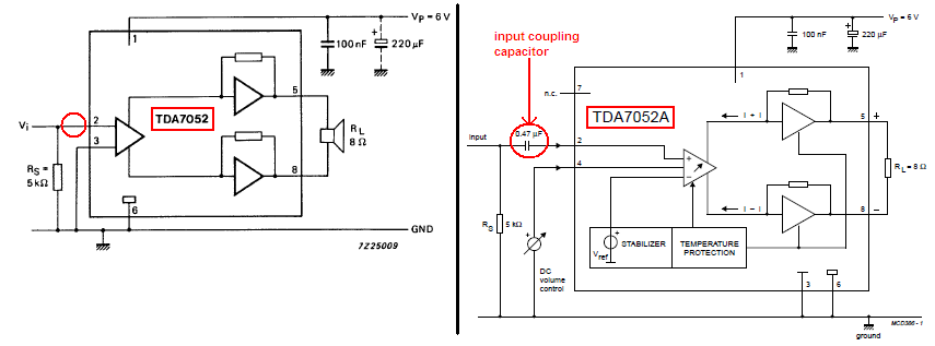

I showed the original circuit's TDA7052 datasheet that has its pin 2 input grounded with a resistor. I also showed your circuit's TDA7052A with its pin 2 input grounded through the volume control but the datasheet shows a coupling capacitor maybe because it has DC on it. Maybe that is why the DC at the output of the TDA7052A is wrong.
the input to pin 2 of ic is +1.14V,
pin 2 of R7 should be 0V, not +0.6V.
and the speaker output not fixed at +1.0V and +10.6V, while i adjust the P1 , the value will different , either p1 max or min , voltage only +6V same
i will try TDA7052 IC at monday, see whether i connected speaker will get shorted circuit or not
May be wrong or not.
Comparing the data sheets of the TDA7052 and TDA7052A the only difference is the unconnected pin4 (DC volume control) in the TDA7052.
The internal connections should be same on both types.
Reducing the AF-input signal at pin 3 shouldn't have the effect of no speaker output.
I admit I didn't pay attention to the suffix "A", when I redesigned the circuit.
The datasheet for the TDA7052A does not have enough details and not enough spec's to show why its circuit uses an input coupling capacitor but the TDA7052 does not show an input coupling capacitor.
Maybe the input of the TDA7052A has a bias voltage that must be kept so it needs an input coupling capacitor. Then when the input is wrongly connected to ground through a resistor it might cause the outputs to have severe offset voltages. I don't use the lousy old TDA7052A because its datasheet is missing so many details. Instead I would use a TDA2822M amplifier in this circuit.
I think the TDA7052A will work properly if you add the 0.47uF input capacitor that is shown on its datasheet. Don't forget to correct the polarity of both C4 capacitors.
