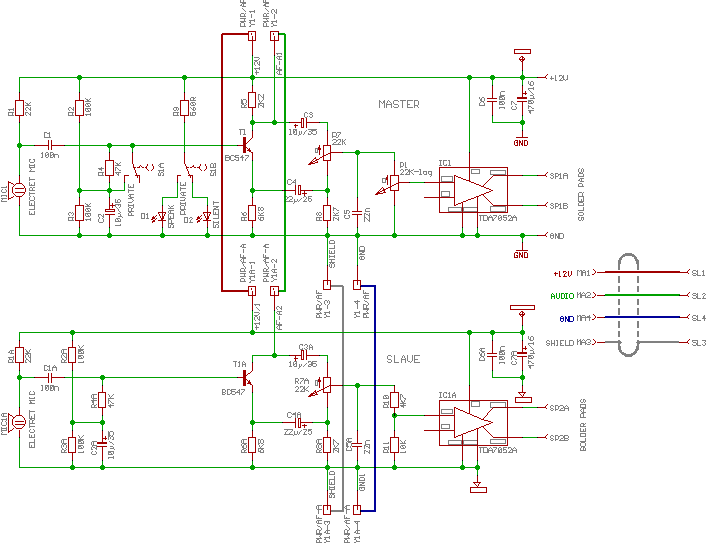

ya... but boncuk edit some part....and the shielded cable connected part is different also....
I guess it won't be difficult to recognize the difference between "SW1" and "S1" as well as "Q1" and "T1".
Since Eagle would connect circuits with the same net names different names were used, e.g. "AF-A1" and "AF-A2", both connected at the junction of the transistor collectors (T1) and C3 and T1A and C3A respectively.
The shielded cable connects exactly at the same connection points with the difference, that a three wire shielded cable is used connecting the power supply from the master board to the slave board.
When using a single wire shielded cable connect that to pins2 and 3 of the connector with pin2 being the "hot wire" (labeled "AUDIO" on the PCB design) and pin3 being the shield (labeled "SHIELD").
Use an unshielded two wire cable to connect pins1 (+12V) and pins4 (circuit ground) between boards.
I tested the clarity of the board layout asking my 12 year old stepdaughter where she would connect both boards and her answer was: "just 1:1 as labeled".
Boncuk

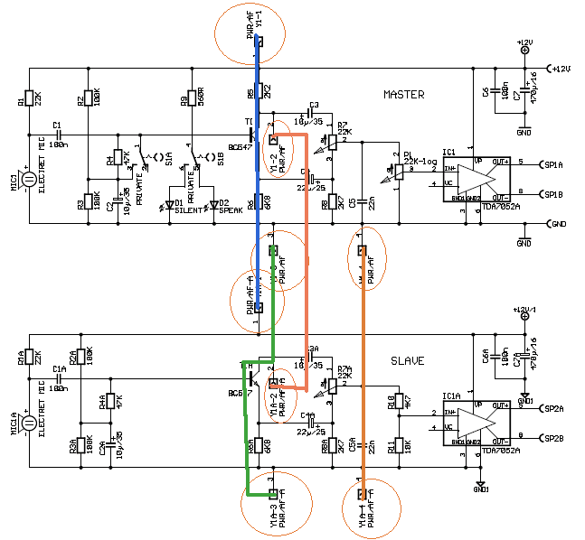

i m using shield 4-wire cable, so i just connect as shown?
and i need 2 power supply , 1 is for "master" , another for "slave" ??

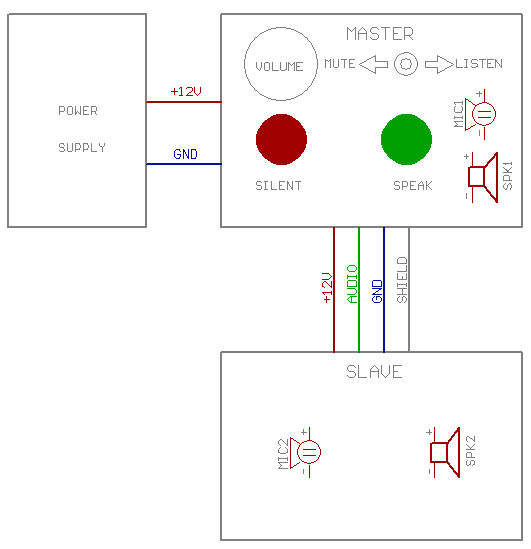

You need two cables:
One two wire unshielded cable to connect the 12V power source to the solder pads on the master PCB. Those solder pads are only present on the master PCB and they are located halfway between connector Y1 and C7. They are labeled "+12V" and "GND".
The second cable should be a four wire shielded cable (If you can get 3 wire shielded cable it will suffice as well.)
I redrew the wiring since I don't like thick lines crossing parts and text in a schematic layout.
Additionally to the wires connecting pins I added a small sketch showing the pins labeled MA1 through MA4 and SL1 through SL4 which stand for master and slave.
Using a four wire cable it won't hurt if you connect the fourth wire to the shield.
If that drawing doesn't help you now I'm afraid nobody can help you.

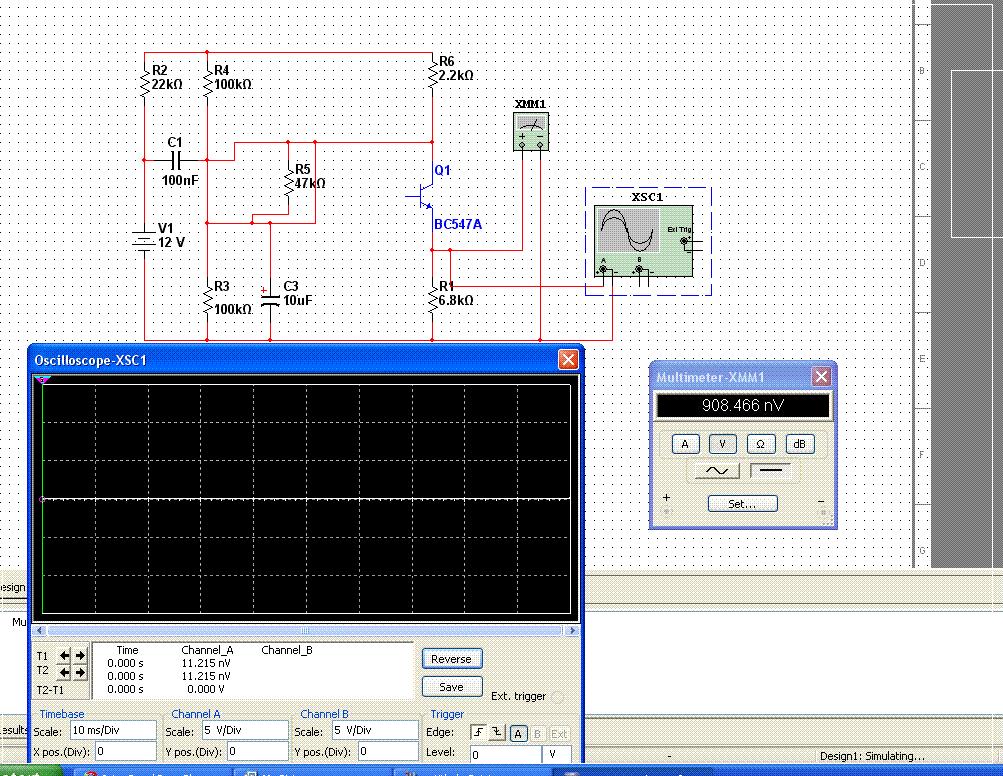

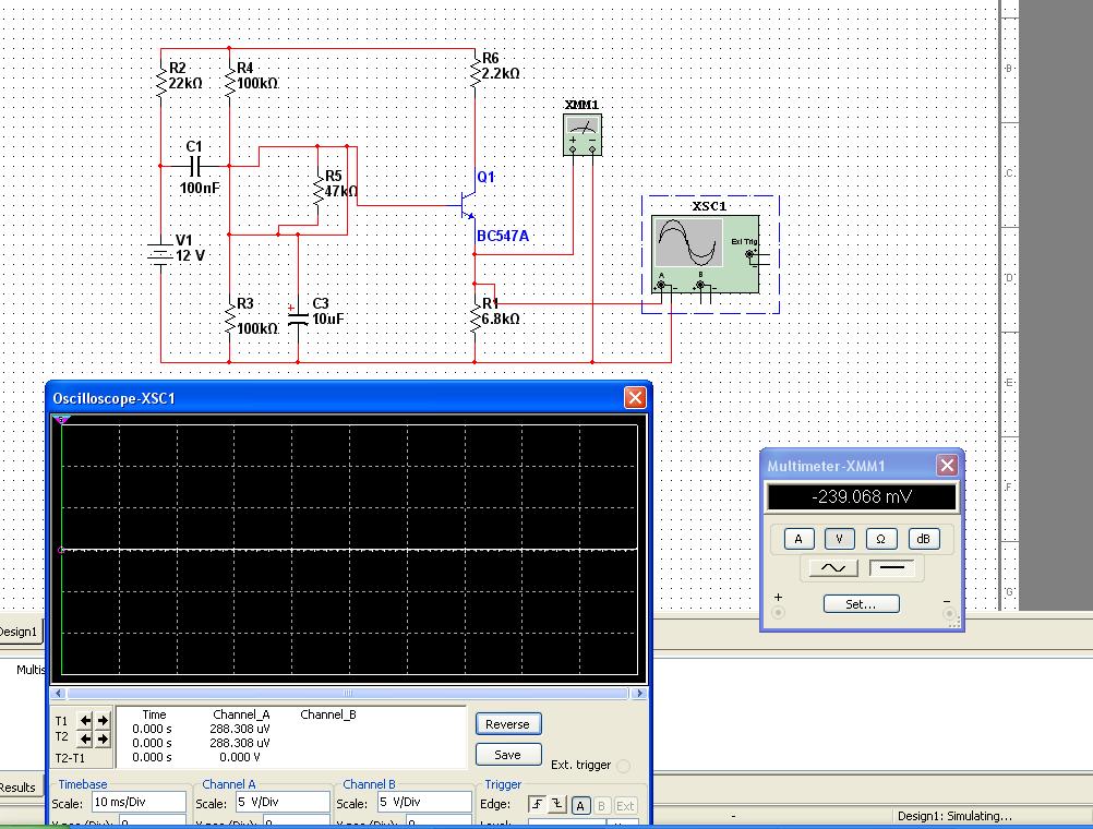

i try a part at multisim , the voltage is low , same like what i tried at board.... and i get zero output on speaker

Your Multisim schematic shows a transistor with no input signal and its base is disconnected from its base bias resistors. So of course there is no output.
