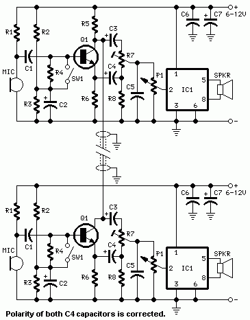

the polarity of both C4 capacitors having problem ?
The original circuit and Boncuk's circuit have the polarity of both C4 capacitors backwards.
The emitter and collector of the transistor have positive voltages and the resistors to ground at the other ends of the capacitors is 0VDC.
Did you consider the 180degree phase shift between C3 and C4?
Of course there is a 180 degrees phase shift in the signals. But it is AC and has no polarity.
The polarity of C4 is backwards to the DC.
I fixed my copy of the original schematic:

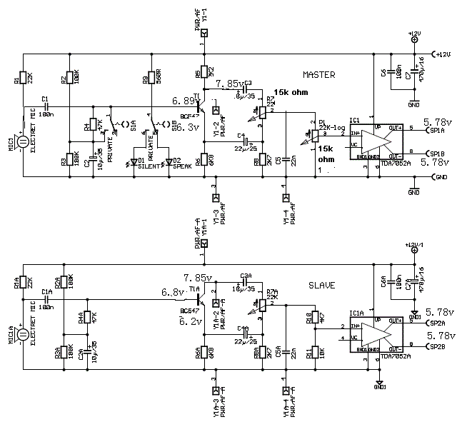

i was connected up both circuits by just using jumper wire and supply voltage on both circuits respecitvely......
the diagram show the voltage i meansure E,B,C,SPA,SPA respectively with Ground......
the output voltage from pin2 of potentiometer was extreamly low.... it just 0.0x - 0.5... i change both C3 & C4 polarity, but the result of pin2 output voltage is almost same... any idea ??

Hi Non89,
wrong again!
C3 connects to the collector of Q1 with it's positive terminal and C4 connects to the emitter of Q1 with it's positive terminal.
So only the polarity of C4 has to be corrected. (both boards)
I contacted the author of the circuit and he will remedy his design soon.
When googling for the design use the search words "full dulex intercom". You should find this page:
Full-duplex Intercom - RED - Page78
Boncuk

by connecting both circuits with jumper wire and supply on both circuits respecitively.... the sound can transfer from "master mike" to "master speaker" , " slave mike" to slave speaker" ..... but the sound is very small..... how to amplify it ??
yaya, i know .... i just trying both for testing XD
this is what i tested with changing C3 and C4 .... both connected +12V DC supply respectively....
C3 and C4 positive polarity connected to Q1 , jumper wire was connected between both circuits Q1 Collector : Speak in mike 1 or mike 2 = Both Speaker voiced out
C3 positive polarity connected to Q1 , C4 negative polarity connected to Q1, jumper wire was connected between both circuits Q1 Collector : Speak in mike 1 or mike 2 = Both Speaker Voiced Out
C3 and C4 negative polarity connected to Q1 , jumper wire was connected between both circuits Q1 Collector : Speak in mike 1 or mike 2 = Both Speaker voiced out
(all the voiced out from Speaker 2 was not clearly....)
now i pull out the jumper wire and changing the C3 and C4 as 3 solution above, and you can guess the result as shown : Speak in mike 1 = Speaker 1 voiced out, Speak in mike 2 = speaker 2 voiced out(but very quietly....maybe i will change the R10 and R11 value or instead with potentiometer)
