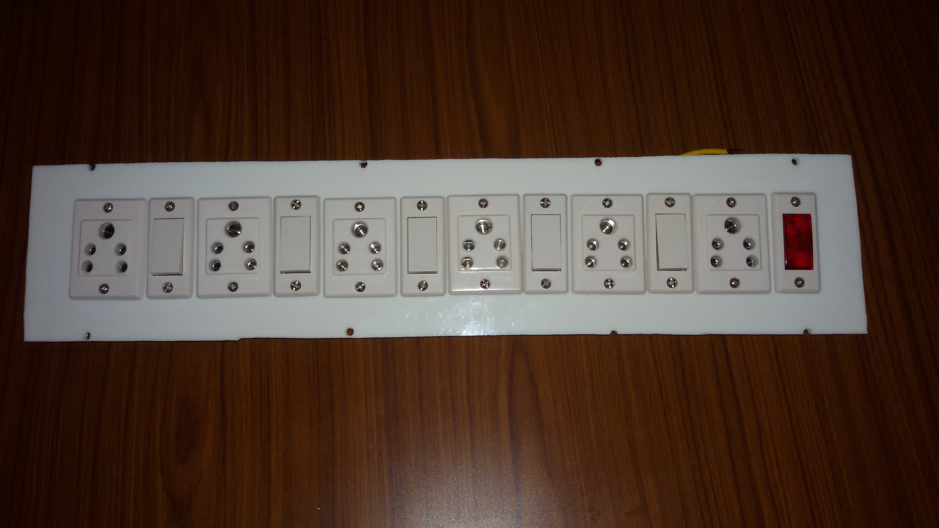

House wiring help

What country are you in? I've never seen outlets with those pin arrangement(s).
At a quick guess, India.
They are the ancient UK 5amp and 15amp sockets from 60 years ago.
PS South Africa uses the old UK 15 amp sockets.
There are still houses in the Uk with those bulgin 5 and 15a sockets, allthough I've never seen a dual socket like those.

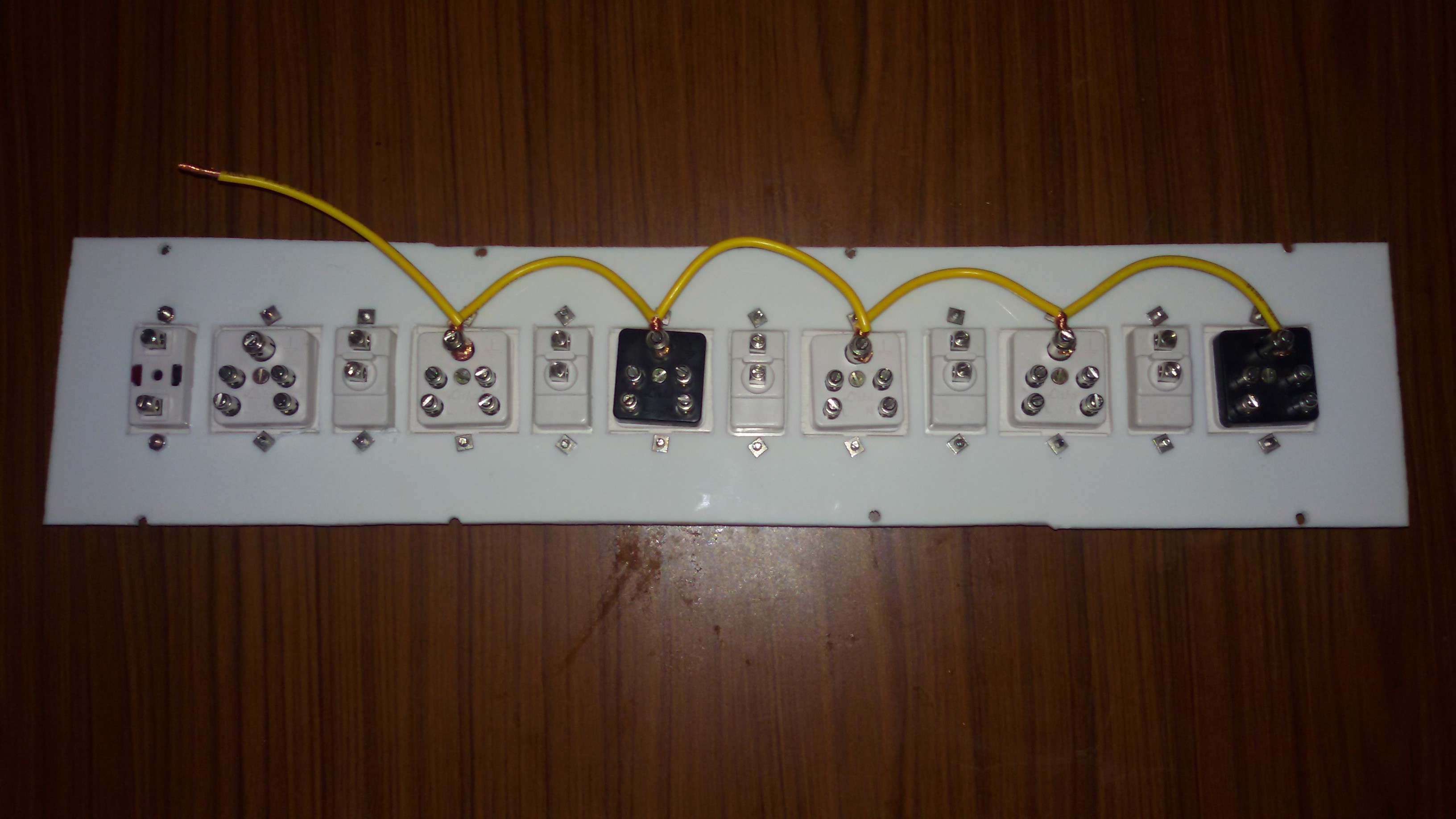

FEBIN

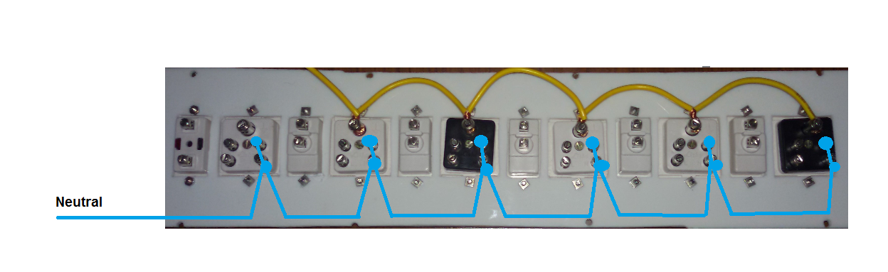

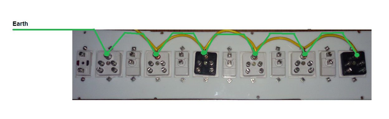

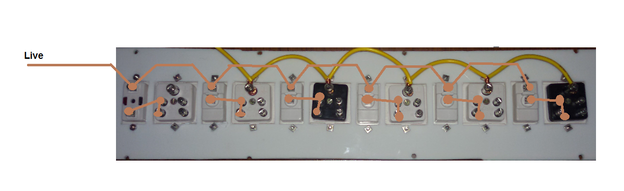

If you want help with this, you need to show a picture of the wiring side of the extension block.
Yellow is ground/earth?
Febin
Try this.
I have split the wiring into three pictures for clarity, Earth, Live and Neutral.
