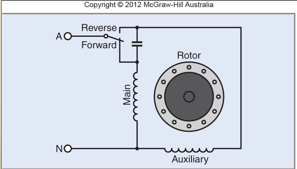

This shows the circuit that I think you have.
The two windings are at different angles around the stator. Most small motors will have the two windings constructed identically, which makes reversing the motor easier.
In the diagram, the one labelled "main" will take more current when running forward, and the one labelled "auxiliary" will take more when running in reverse if the circuit shown is used. There are more complicated circuits that would reverse a motor will always leaving the capacitor in series with the auxiliary winding.
It is possible that the auxiliary winding could be made with thinner wire so that it should not be used all the time at full motor load, but that is unlikely. Anyhow, if you measure the two winding resistances and they are the same you can be fairly sure that you can reverse it by moving just one wire.
That (post#7) shows a typical PSC (permanent start cap) motor, these have identical windings so yes, each is capable of operating as start winding.
They generally only go up to around 1/2HP.
