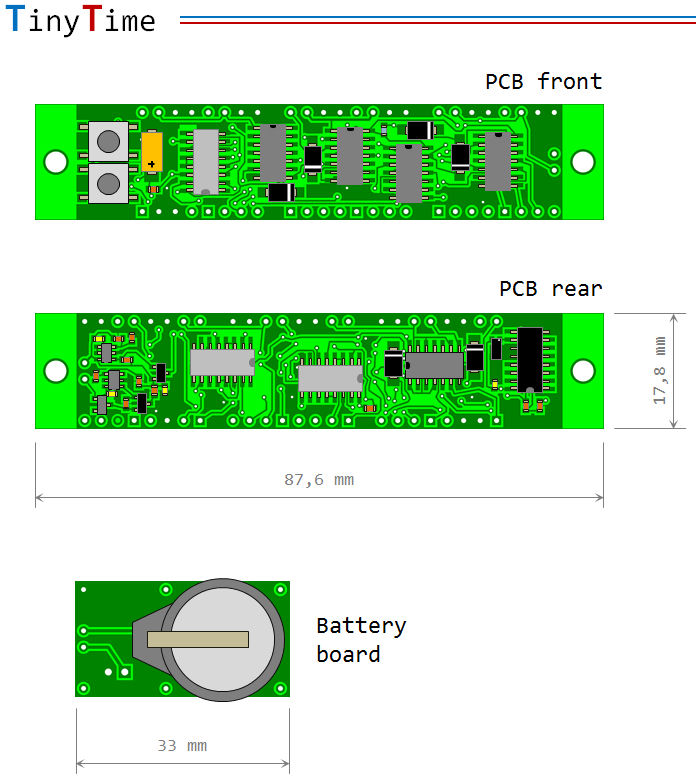

I've made the PCB layouts now, still have to go through them a couple times more and perhaps make a prototype of the "UPS" module but I managed to reach one of my project goals - to fit everything between the display legs :)
Pretty neat eng, especially as you are just starting with the ECAD package. :cool:

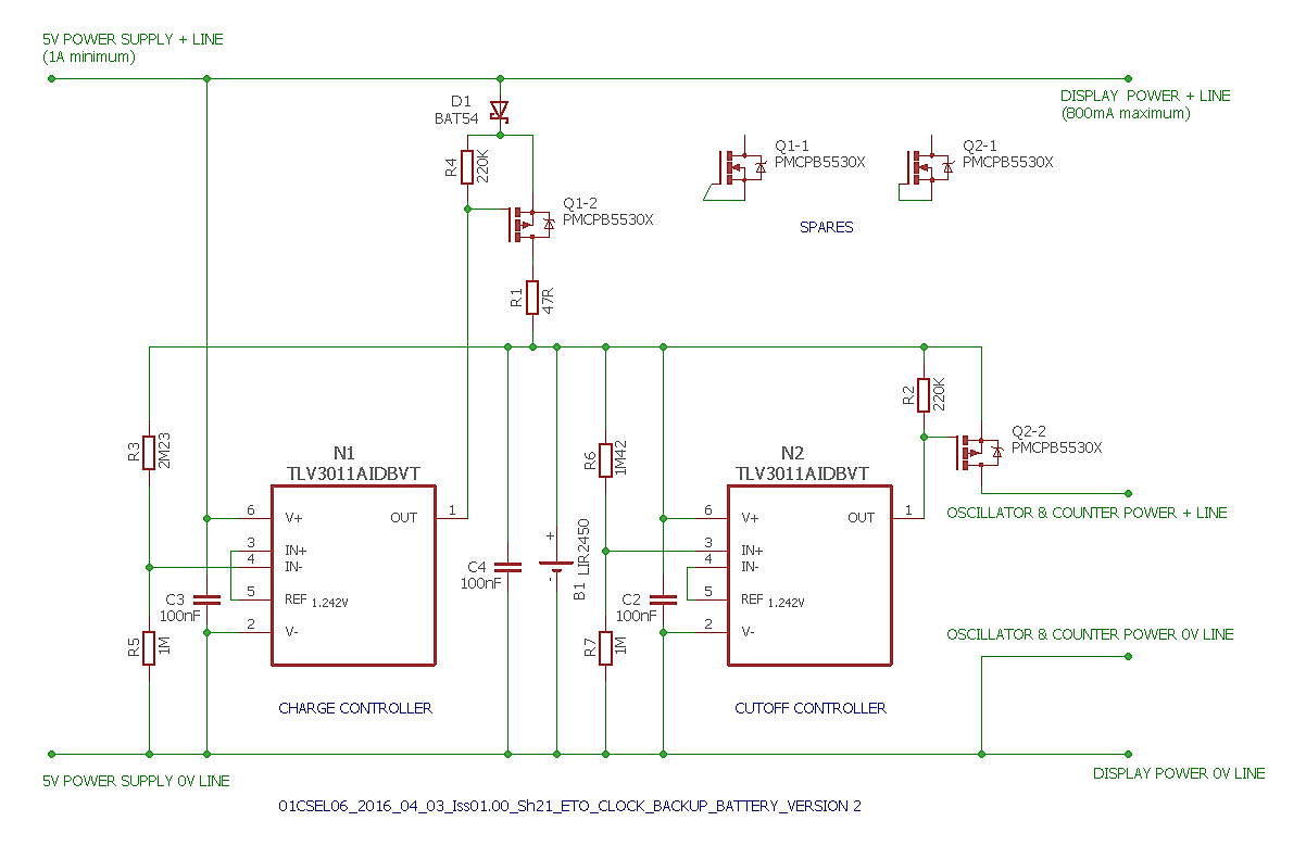

Hy engineer, this is what I have come up with for the revised clock backup battery circuit.
Once again, the parts are hellish expensive. :D
spec
ISSUE 3 of 2016_04_05
DATA SHEETS & SOURCES
(1) Comparator & Voltage Reference, Texas Instruments TLV3012
https://www.ti.com/lit/ds/symlink/tlv3011.pdf
https://uk.rs-online.com/web/p/comp...3743D544C5633303131267374613D544C563330313126
(2) LiIon battery 120mA/hr, Multicomponents LIR2450
https://www.farnell.com/datasheets/1475807.pdf
https://uk.farnell.com/multicomp/lir2450/coin-cell-lithium-120mah-3-6v/dp/2009025?MER=BN-2009025
(3) Complimentary MOSFETS, NXP PMCPB5530X
https://uk.farnell.com/nxp/pmcpb553...id|99301984448|kword|pmcpb5530x|match|p|plid|
NOTES
(1) The above circuit is optimized for a long battery life. Charging current averages around 20mA which represents 20ma/120mAh = 17% of C. But the charging current tails off as the final float voltage of 4V is approached. The discharge current is around 340uA, to keep the oscillator and counters working, and this current is terminated when the battery voltage drops to 3V. All these factors are good for maximizing battery life. Here is an article about extending LiIon battery life: **broken link removed**
(2) The two spare NMOSFETs are only there because they come in the same case as the PMOSFETS.
(3) The NXP PMOSFETs type PMV48 (SOT23) can be used in place of the PMOSFETs in the NXP PMCPB5530X (SOT1118) if the case style is preferred for hand soldering.

Regarding R3 and R6, it seems that 0603 resistors with 1.42 / 2.23 MOhms are very hard to find. Do you think that 1.43 and 2.21 will suffice?
I'd rather not go up in package size for these, if it's not absolutely necessary.
The Varta Li-Ion coin cell withstands their overcharge test with 12V at 300mA for 12 hours and it doesn't explode nor catch on fire!
Long time no see...
I've been busy doing actual salary-paying work, but now I have a little free time again to continue with this project.
Hi engineer,
Nice to see you back.
Being paid for work is always handy.:)
The resistor values that you want to use will be fine.
