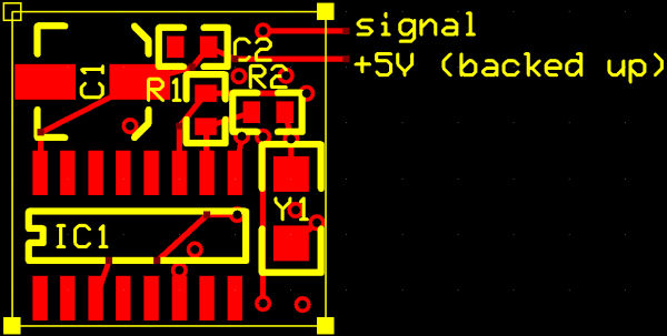

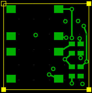

I've just started to learn ExpressPCB, here's my oscillator "module":
Pretty neat, I don't know if you are aware of CadSoft EAGLE CAD. It is a very popular CAD package and there is a free version too.
spec
Yes, I've installed Eagle + some other freeware programs. I'm going to try them all out and decide which one I like best :)
ExpressPCB isn't too shabby though, at least for a noob like me, hehe!
PCB Express, from what I know, is easy to learn and use and as a get-you-started-as-soon-as-possible ECAD it is ideal. My concern, though, is that EAGLE is probably better for more complex applications, so it would be a better program to learn long term. There are a load of very good free ECAD programs available, and everyone has their favorites, but EAGLE is the industry standard, within its sector that is.
