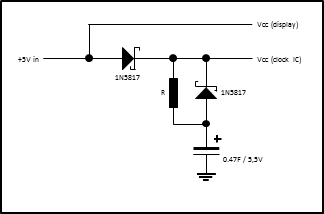

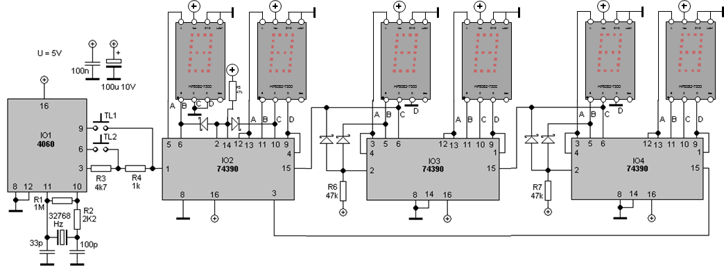

I am building a digital clock using the schematic on this page: https://danyk.cz/hodiny2_en.html
A neat thing to add would be a backup capacitor in case of a power failure, but I have never used these before so I'm not sure how to properly add one to my build. The space available is small width- and heightwise so only a 0.47F fits, but it is however quite long so there is room for up to three 0.47F in a row.
Then again, I read somewhere that it isn't always a good idea to parallell supercaps so I wanted to know your thoughts on the matter.
Also, if my "capacitor circuit" below is correct, how do I calculate a fitting value for R?
As you can see, my idea is to only have the clock circuit backed up and not the actual LED display.

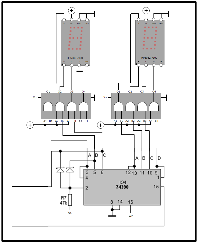

Mike is correct that you need some buffers to the displays if you want to turn them off. They don't have to be tri-state. You could use AND gates and force all the outputs low at the same time as turning off the power to the displays. If you don't have some sort of buffer, the TIL311 displays will try to take power from the outputs of the 74??192 counters, so the power consumption will be far more than you expect and it may upset or damage the counters.

As per the datasheet the LED supply is separate from the logic supply Vcc in the display chips, so you could remove the LED supply safely. That would ~halve the power consumption of those chips. Not sure what the effect of removing Vcc for those chips would be though. Without buffering, that might load the counters enough to prevent them working properly.
I'm building version 2 with 74HC390 counters, also I'm not using TIL311 displays because I have found about 60 HP5082 chips in the recycling bin at my job :happy:
But I guess the question still remains - will the displays try to draw power from the counters when their Vcc disappears..?
Display datasheet:
Here's my schematic:
...But I guess the question still remains - will the displays try to draw power from the counters when their Vcc disappears..?
Yes
You could put one Schottky diode in each ABCD input (cathode pointing at the CMOS counter) to prevent the back-feed.
With the displays off, the CMOS counter chain could operate on a few 10s of uA.

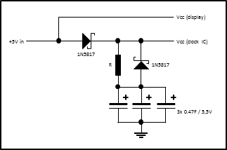

There is absolutely no problem connecting supercaps in parallel. You can evel parallel different values from different manufacturers, provided, of course that you do not exceed the working voltage of any one capacitor in the parallel bank. There are problems connecting any capacitors in series though, not just supercaps.
Your circuit is correct, although not optimum. The value of R simply defines how long the supercap bank will take to charge back up to its maximum backup voltage, once the mains supply is restored. The minimum time is limited by the current available from your power supply and also by the maximum charging current of the supercap bank. I don't see this as a critical area and the value of R can be calculated quite simply further down the line when more information is available.
The attached Word .doc file shows the calculations for the size of supercap bank you would need to meet your 4 hour backup duration. I have taken spec sheet figures to calculate the total current taken from the supply line by the oscillator and counter chips, and this will probably be pessimistic so you might consider measuring the actual current taken and use that in the equation to arrive at the value of supercap needed. If you have any actual supercap types in mind, it would be handy if you could post a description.
The principle I have used is that the clock chips will operate from a supply line of between 3V and 6V, so 3V is the amount of voltage drop the capacitor can have while still maintaining the oscillator and counter functions.
To use this approach and your circuit, you would need a 6.4V DC supply and an extra diode in line with the 6.4V supply to drop it to 6V, which would be the voltage that the supercap bank would initially supply. UPDATE: I see that highest voltage that commonly available supercaps will stand is 5.5V, so that will have to be the maximum backup voltage. This implies a maximum backup drop of 5.5V to 3V = 2.5V, rather than 3V as stated in the attached word document.
I have just given the basics of this approach and there may be errors- there normally is with my designs- but this data will allow you to consider the design. No doubt, there will be a few details to sort out.
There are other, more complicated approaches, that would allow you to use a smaller capacitor bank. Also, you could consider using a rechargeable battery, which would be a far superior approach; sorry.

The caps I'm going to use are 0.47F/5.5V, and since parallelling them isn't a problem I will use 3 of them. If 4.9F will give me 4hrs, my 1.41F bank will only give me about 1 hour - which is totally OK by me.

The suggestion of using AND gates as buffers is interesting, I'll probably redesign my project with that in mind. If I'm not mistaken, I can use the display Vcc as input A for all gates, and the binary data from the counters as input B. This should result in all zeros to all binary inputs on the displays when Vcc disappears. (I hope...)

The 74LVC08A isn't rated to run with a 5 V supply. It wouldn't be damaged as the absolute maximum supply voltage is 6.5 V, but they might not work correctly. Probably more importantly, they are not available in a DIL package.
To buffer the output of the 74HC390, your first choice would normally be the same technology, the 74HC08. You would be better to use the 74HC08 than the 74HCT08 because the 74HC08 will work over a wider voltage range. The 74HCT08 is designed to accept TTL levels on its input when running from 5 V, so its high level input voltage threshold is quite a lot lower than the 74HC08, but that is the only difference.
Your connection to the displays is only outputs to the displays, not the other way round, so you don't need the lower input voltage threshold, but you would gain from known behaviour, matching the 74HC390, all the way down to 2 V supply.
