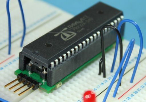

In any case(!) it's going to be a very compact build. In my first PCB layout I used elevated sockets for the display chips and fitted all components between the legs, stacked in two layers... Almost like on this image:
The battery won't fit like this though, so I have to piggyback it in the rear in my new layout. This one will have all SMD components so hopefully I'll be able to shrink everything down a bit.

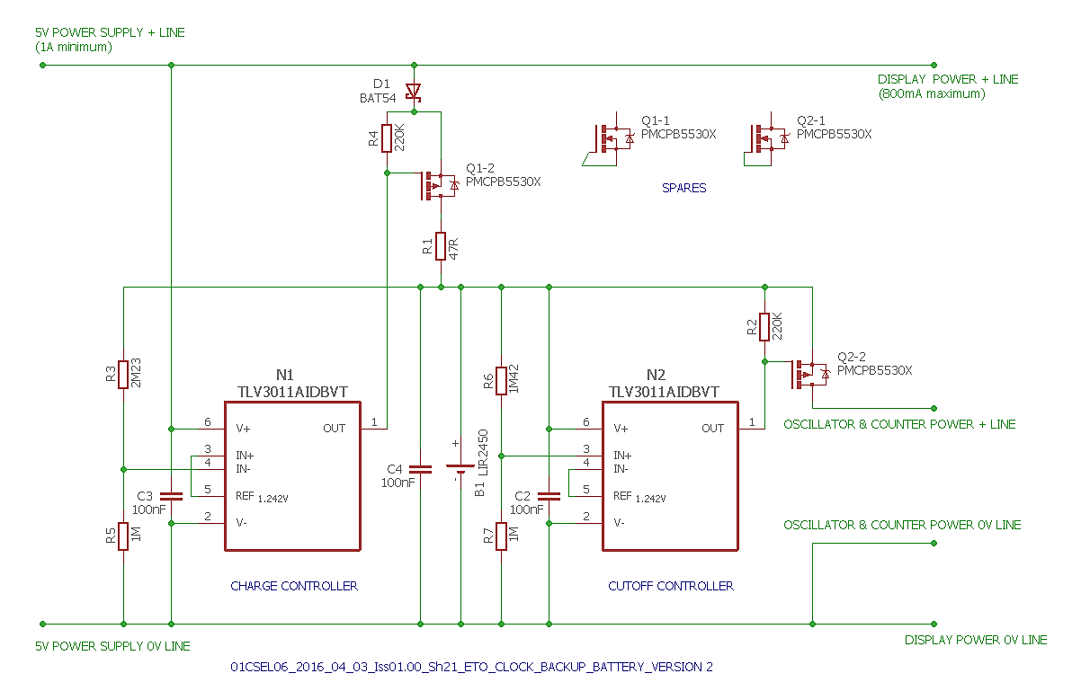

Hy engineer, this is what I have come up with for the revised clock backup battery circuit.
Once again, the parts are hellish expensive. :D

ISSUE 3 of 2016_04_05
DATA SHEETS & SOURCES
(1) Comparator & Voltage Reference, Texas Instruments TLV3012
https://www.ti.com/lit/ds/symlink/tlv3011.pdf
https://uk.rs-online.com/web/p/comp...3743D544C5633303131267374613D544C563330313126
(2) LiIon battery 120mA/hr, Multicomponents LIR2450
https://www.farnell.com/datasheets/1475807.pdf
https://uk.farnell.com/multicomp/lir2450/coin-cell-lithium-120mah-3-6v/dp/2009025?MER=BN-2009025
(3) Complimentary MOSFETS, NXP PMCPB5530X
https://uk.farnell.com/nxp/pmcpb553...id|99301984448|kword|pmcpb5530x|match|p|plid|
NOTES
(1) The above circuit is optimized for a long battery life. Charging current averages around 20mA which represents 20ma/120mAh = 17% of C. But the charging current tails off as the final float voltage of 4V is approached. The discharge current is around 340uA, to keep the oscillator and counters working, and this current is terminated when the battery voltage drops to 3V. All these factors are good for maximizing battery life. Here is an article about extending LiIon battery life: **broken link removed**
(2) The two spare NMOSFETs are only there because they come in the same case as the PMOSFETS.
(3) The NXP PMOSFETs type PMV48 (SOT23) can be used in place of the PMOSFETs in the NXP PMCPB5530X (SOT1118) if the case style is preferred for hand soldering.

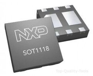

Regarding the PMCPB5530X, can you give an example that's not so tiny? The drains in that package is kind of impossible to hand-solder (well, for my and my skills anyway, hehe) since they're at the bottom...
There are a lot of other MOSFETs that you could use. Anything with similar On-resistance and gate threshold would be fine. Obviously you need P-channel. The voltage rating won't be a problem as it will never be smaller than the 5 V supply that you are using.
As Driver 300 says, but look out for leakage. I agree about the small case- it is a great shame for the hobbiest because the MOSFETs have ideal characteristics. What you can do is to glue the case on its back and solder thin wires on to the pads, only 3 used (don't worry about shorting the gate and source of the spare NMOSFETS). Alternatively, you can get headers to convert from surface mount to through hole- just put some solder paste on the header pads, glue the surface mount chip on to the header, and give it a blast with a heat gun. In any case, I will see if I can find a suitable PMOSFET in a larger/more convenient case.
