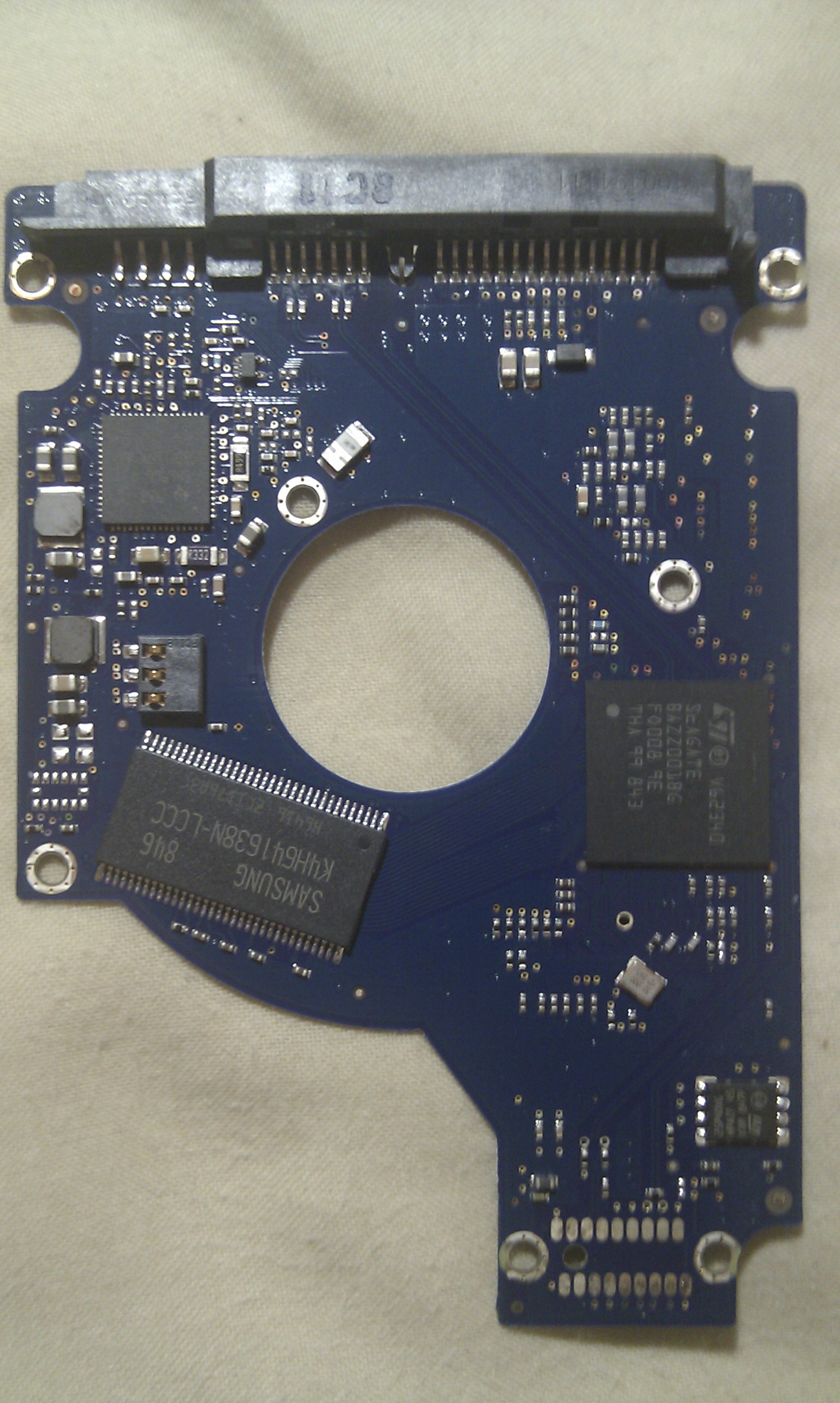

I'm liking the idea about the TVS diodes, I'm not sure where they are though or how many of them to look for. If anyone can point me in the right direction I'll get the multimeter out and check for a short. Hopefully if this is the issue, the TVS's stepping in to divert the spike and data is still salvagable maybe I can snip them off and give operation data rescue another go.
Thanks,
Megamox
I´d say the TVS is that black thing on the top right, but you will be better off looking up the pinout of the power connector and checking resistances there. Also check that white part close to the large hole, I think it is a fuse.
In the future, I recommend getting several identical drives and do RAID1 or RAID5 or RAID10 for Data striping + mirroring (or parity). This also has the happy side effect of substantially increasing performance. As for SSD's, IMO they are currently not worth the price, and also have problems with failure.
Thanks guys. I assume for a fuse, I'd just short it? The top right component seems to have the letters KEX on it. At least that's what I think without a magnifying glass! It's funny you mention RAID because when I bought the laptop it came with a RAID configuration as it has two hard drive bays. I cant remember which set up it's called, but it's where the same data is identical on both hard drives at the same time? Anyway you know how it goes, one day you need a bit more data and foolishly you decide to split the drives up and then.. well here we are. Luckily, or so I thought, because the laptop came with two identical hard drives, same model, same firmware revision, I could just swap out the logic board PCBS and get this one working again, but that didnt work. The good board in the bad drive - still not recognised and still beeping. For fun,the bad board in the good drive - the drive didnt make any sounds but it wasnt recognised any longer. Put the good board back in the good drive and it worked fine again. So obviously the drive that's broken has an issue with the board for sure. I cant say for sure whether the mechanics of the platter and head are okay or not too. I understand that even a similar board in another hard drive sometimes doesnt work even if the firmware is a good match, something about some adaptive memory on the original PCB that must be copied over or something. But I'm in no way an expert, but I feel like I've read enough to at least realise how fragile my data has been for the last two years.

it doesn't look like there's a TVS diode on the board, and i'm assuming you took a picture of that side of the board because there was nothing but traces on the other side. the power connector is the 4-pin connector in the upper left corner, and USUALLY, the TVS diodes are within an inch or two of the connector. sounds like the drive is mechanically dead (maybe from stiction, or a seized bearing) or bad motor windings. btw, i know people who have had Seagate drives last a long time, but Seagate drives have a bad reputation for reliability. Hitachi and Fujitsu drives seem to have very good reliability. Seagate, Hitachi and Fujitsu all have 5 year warranties on their drives (but that won't help you get your data back...)

the power connector is the 4-pin connector in the upper left corner...
No that´s not it, this is a SATA drive, so the power connector is the wide on the right side. The one on the left is used by the manufacturer presumably. On a dead toshiba drive I have here one pin from the left connecotr is ground and the three remaining are some data pins.
