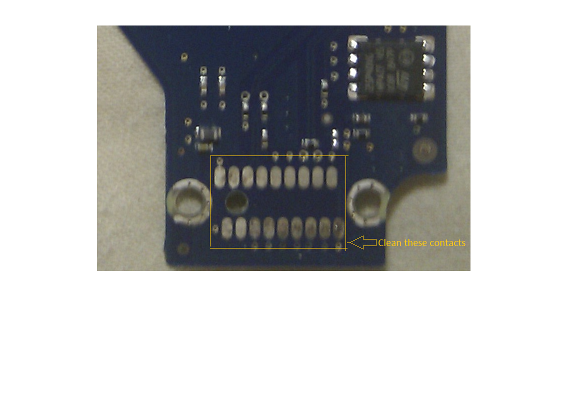

Did you clean these contacts as I suggested earlier? A thin layer of oxide makes a good insulator. Use a pencil eraser to clean them.
Timescope
Completely forgot to mention, I did! I used some rubbing alcohol actually and it seemed to help. Maybe that contributed to things, thanks! Cant seem to find that Live Linux CD at the moment... but I'm still on the hunt. Cant remember what I had planned doing this week but a hard drive failure seems to have over shadowed everything else. At this point in time I know more about hard drives, platters, heads, spindles and stiction than I ever cared to :)
