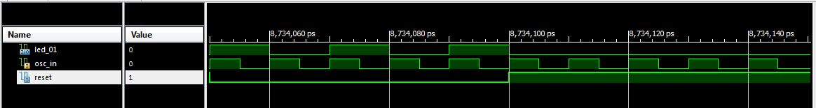

Trying to create some blink code and get a crazy error:

My Error:
ERROR:Xst:827 - "C:/XWD/BlinkLED/BlinkLed.vhd" line 34: Signal led cannot be synthesized, bad synchronous description. The description style you are using to describe a synchronous element (register, memory, etc.) is not supported in the current software release.
i even tried without the "rising_edge(clk)" the long way... (change the variable names also)

Ok the problem was:
"OSC_IN'event "
But why i cant use it is a mystery... really. What its used for is also a mystery heh. i assume its to tell me if the clocked changed states and the next item checks if the state is 1...

This code synthesizes ok
	process(OSC_IN, RESET) is begin --Handle the inputs
	if(RESET = '1') then  --if RESET is high then  set the LED to low (off in my case)
		LED_01 <= '0';
	elsif(rising_edge(OSC_IN)) then //If RESET is LOW and the RISING EDGE of clock is hit then turn LED on
		LED_01 <= '1';
	end if;
How would i turn off the LED off when the Clock is LOW then ?
do i simply add after that ?

The below seems to synthesize ok and simulates fine

You don't trun off the LED when the clock is low. You turn it on and off on alternate clock periods, using this line as I've written above:
if(rising_edge(clk)) then
LED_0 <= not LED_0;
on each clock edge, the LED will change states.
Take a look at the simulation image... As you can see when RESET is low it allows the LED to be controlled and when high even with a clock still coming in the LED is held low...

Ah i see now.. cool thanks... since i didnt copy paste i missed that :D
If i do that then to synthesize i need to make the PIN inout type to be able to read the current state. Otherwise i get a error...
Here it is tho.. now i see what i was doing heh.. trying to change it on half a clock really.
