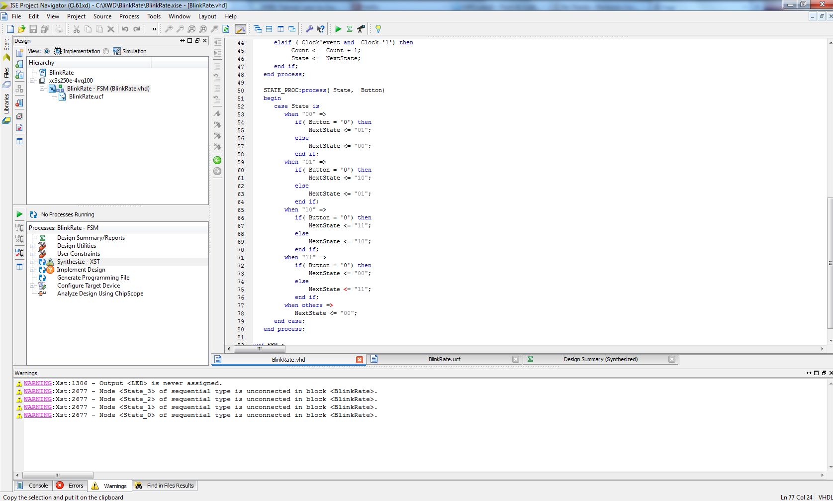

Why is it saying it found State and NextState to be 4 bits when i create them as 2 bits?
Hmmm... not sure. It might be related to the fact that you've created latches. Latches are very bad things. Like the warning says, they are created but incomplete case or if statements. For example, you code:
when "00" =>
				if( Button = '0') then
					 NextState <= "01";
What is the value of NextState when Button = '1'??? You haven't completely specified the assignment, so you created a latch. To fix this do this
when "00" =>
					 NextState <= "01";
                                                   else
                                                   NextState <= State;
Or you can use a default value for NextState:
	STATE_PROC:process( State,  Button)
	begin
                Next_State <= State;
		case State is
			when "00" =>
Maybe if you clear this up, the bits will come out right.
Thanks yet again, i used the ELSE and was left with these warnings... (these are not errors)
WARNING:Xst:1306 - Output <LED> is never assigned.
WARNING:Xst:2677 - Node <State_3> of sequential type is unconnected in block <BlinkRate>.
WARNING:Xst:2677 - Node <State_2> of sequential type is unconnected in block <BlinkRate>.
WARNING:Xst:2677 - Node <State_1> of sequential type is unconnected in block <BlinkRate>.
WARNING:Xst:2677 - Node <State_0> of sequential type is unconnected in block <BlinkRate>.

I think you can ignore those warnings. They say you're not using the signal "State" but you are. Is this a synthesis? What are you using?
You'll get used to ignoring many warnings before you're done.
yeah... take a look.. my screen...

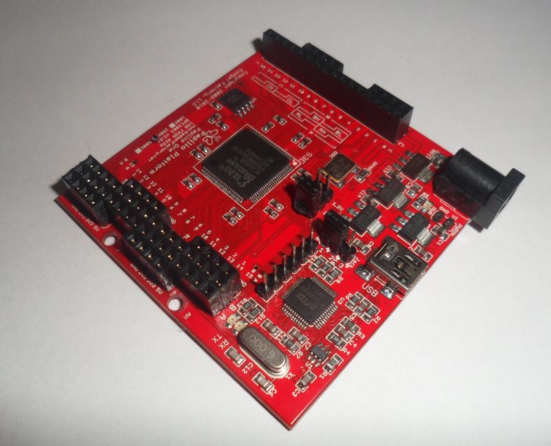

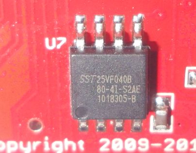

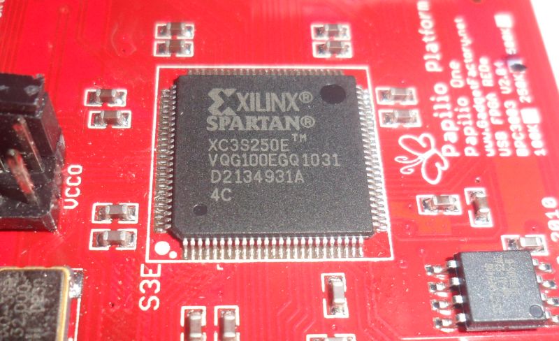

Just got my Papilio One board... looks so cool. I hand cut and soldered the headers, came out pretty good i think.
It dawned on my that your software is encoding your state machine "one-hot" and that's why you're getting 4 bits instead of 2. That might be default behavior of your software.
