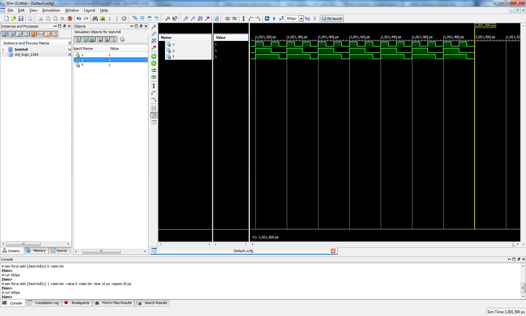

Also in FPGA design when we design a module to do a certain job we usually make a test bench for it too (FPGA design would be pretty much impossible without test benches and the simulator!). All this really is, is another VHDL file which drives our module with pretend data. We can then look at the waveforms our module produces from these inputs and determine if our code is doing the job we expect. You can even write fancy test benches which do the inspection for you so to speak (i usually do not bother with this, but depends on the complexity of the design).

This is pretty cool. I mean i only tested out a OR gate so far in code but seems nifty! i love the sim so far. I havent went crazy enough to make a test bench type thing but i can force a line to clock to get some cool accurate results
I now know what the entity is for and architecture part is for. Also you can simply "define" (not sure if its good to use this word) an Entity and reuse it if needed
library IEEE;
use IEEE.STD_LOGIC_1164.ALL;
-- Uncomment the following library declaration if using
-- arithmetic functions with Signed or Unsigned values
--use IEEE.NUMERIC_STD.ALL;
-- Uncomment the following library declaration if instantiating
-- any Xilinx primitives in this code.
--library UNISIM;
--use UNISIM.VComponents.all;
entity testVHDL is
    Port ( x : in  STD_LOGIC;
			  y : in  STD_LOGIC;
           F : out  STD_LOGIC);
end testVHDL;
architecture Behavioral of testVHDL is
begin
	process(x,y)
	begin
		-- Compare to truth table
		if ((x='0') and (y='0')) then
			F <= '0';
		else
			F <= '1';
		end if;
	end process;
end Behavioral;
