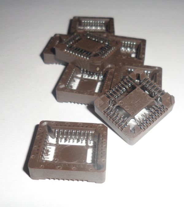

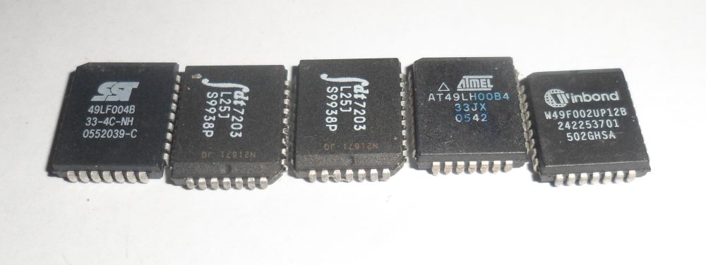

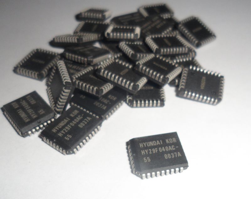

Im not a PLCC fan but i seem to have all of these in one of my organizers...

Those parts are fine, but I built mine using TH :eek: (a lot cheaper than getting boards made, which was important when I was a student studying VHDL. I can now make single sided boards at home thankfully!).

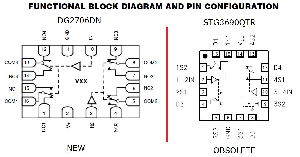

Ah found this:
https://www.electro-tech-online.com/custompdfs/2011/07/an8082.pdf
Last page has schematics... would be simple for me to make.. Ill get it sent out to make . While they dont make that Switch (STG3690QTR) anymore i found:
https://www.mouser.com/ProductDetai...GAEpiMZZMtxrAS98ir%2bs6ERF3TSO9w3xdp11UxseCI=
which looks similar enough to get the job done :D
Image made by me :D
similarities-jpg.55586
Was actually reading the pdf and found
The FT2232D device is not only a convenient solution to programming JTAG devices over USB but, it also provides
development and debugging options as well. The schematic in Appendix B, shows an analog MUX (U3) which is
used to divert the signals from channel A to either a JTAG chain or an I2C bus. Pin 16 of U1 can then be controlled
by the host software to switch between the JTAG chain and the I2C bus. FTDI provides the drivers and example
files of how to configure the FT2232D to interface with the I2C bus.
So i can omit that part if planning on using it for JTAG only
