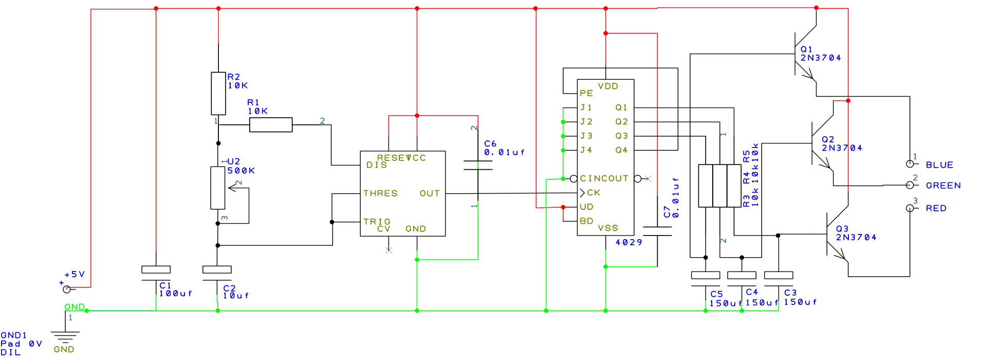

Got this umbrella light about 12 years ago. its out by the pool so between the humidity and the salt water the board is toast.
I was just going to piece this back together replacing the battery tabs and broken switch but the longer it sat on my bench the less i liked it. The leds were dim and if i have to remake the board i thought id step it up a notch.
What i have is a fade circuit that on paper does what it should but id like you to take a look and help me with the following.
Does this schematic make logical sense? Some times what I find on the web turns out to not be what it is or its got a flaw or could need an improvement. This design was posted in 2002. Ive adapted it for 8 leds by changing the transistors from 3904 to 3704 because it can handle more current. Ive also added 0.01uf caps to the two IC's between their + and - pins.
Will it run on 4.5volts? The configuration is 6 AAA batteries connected in parallel to have 2 4.5volt loads. My circuit lingo is not up to par. Im sure this setup allows for extended use from the batteries.
How long will this run on 4.5volts?
Help me understand how i can figure out how long this circuit will function with the current setup.
First the original project i located. I is designed for one LED
My Interpretation and modifications.
There are two boards for this. One for the controller and one for the LEDs. The output at the far right goes to a color on all 8 leds. Each led has its own resistor. (200r-600r). I also left out D1 from the original. Ive made a few projects and have not seen a diode at that location before.

To extend battery life, put two LEDs in series with current limiting resistors for each color. This will double battery life. It looks like you're just stepping through the RGB colours in sequence. Ahhh, you're relying on the RC time constant in the base of the transistors. Your transistors will get very hot I suspect. Personally, I'd use a micro for this. How are your programming skills?
  • Like
Reactions: 3v0
Will it fit on that PCB board? its 40mm square.
I can comprehend code pretty well. I can write too.
Cool. I did not know that. so instead of one resistor for each i would have one resistor for two. And the resistor size would also be less too.

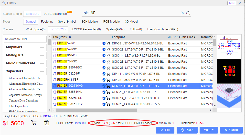

The Pic16F1503 comes in a QFN-16 package which is 3mm x 3mm. It contains four 10 bit PWM modules. It's available at EasyEDA for $1.56 and they will even manufacture (and assemble) the boards for you.

(JLCPCB / EasyEDA still do not have any PICs available, so I'd stick with through hole types that you can get separately).

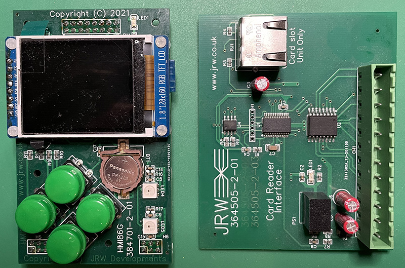

As long as the appropriate pins are available somehow, either with a dedicated header, blank pads or as other component connections (with some restrictions), the MCU can be programmed in situ.
It's called "In-Circuit Programming".
The PCBs are built with blank devices, then the program is loaded once the system manufacturer gets them from the PCB assemblers.
These are a couple of prototypes I have to hand, as examples; the left one has the required connections on the multi-way connector at the top, that normally links it to the system it controls.
For most PICs that means power ground, reset and two other pins for ICSP data and clock (which are given in each device pinout or data sheet).
The right hand one has an empty pin header pattern between the ICs, that is connected using "pogo pin" spring probes.
The same can be done with the 16F18313 etc., like many newer PICs you can both program and debug (step and trace the program) with the device fitted to the circuit board.
That may have been the case a few years ago but not now.
I had a board made about a year ago with a pic16F18854 and a 6 pin connector to do ISP.

You have LTSC stock tab selected, not JLC parts available for their PCB assembly service.
The highlighted bit at the bottom states "2327 for JLCPCB SMT service". I have boards in front of me that contain a (SMT) pic that were assembled by JLC. They definitely have them.
We've had boards with various PICs, in the past, just not during the present shortage.
Can you actually order for assembly if the JLC side shows zero?? That's the odd bit??
