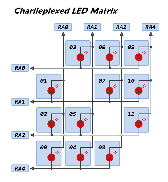

Would you be interested in a Charlieplexed display with a hi-speed hi-rez BAM driver for 12F1840 or 16F18313?
So Charlie-Plexing is the only way to add more LEDs? So, if I do that, I need to change the pins to in & out, which will add to the complexity of the programming. I told myself that I needed to study and read more...lol I need to quite goofing around and get to reading.
Yes, the limitations of only 8 pins limits what you can do - why not go to a slightly larger device, 14 or even 18 pin from the same datasheet.

With any of the larger devices you bought, you should easily be able to add more LEDs.
Edit - missed some posts..
Charlieplexing means the program has to work differently as the PWM is presently applied directly to all outputs.
Adding multiplexing of any type prevents that, as outputs have to be switched in different combinations to enable different LEDs.
The program would need rewriting for the different output system.

Yep, that is what I thought with Charlie-plexing.
Success!
I changed it to the following:
I added "#define LED_P4 64" and then changed the hex values around. Now I have a 5-LED sequencer.
The interrupt driven BAM (Bit Angle Modulation) driver takes care of that for you. A small program reads records from an array (table) that contains brightness levels for each LED (0..31) plus a duration value. The BAM driver provides 32 linear brightness levels spanning a 256 step (250-uS steps) period for each LED and the entire 12 LED display is refreshed every 768-usecs (1302-Hz refresh rate)... This is a high performance method that's probably over-kill for your application...

Well, it looks as if my edit of the code didn't do what I thought it was doing. Although 5 LEDs are working (RA0, RA1, RA2, RA4 & RA5), RA0 & RA5 are lit at the same time, i.e., they are showing the same PWM cycle. I suppose I need to add LED_P4 somewhere else in the code besides where I added it. So for now, I removed LED_P4 and am just using 4 LEDs. Been playing with the timing. Pretty cool stuff.
Using 64 makes the timing the same as 0, as it's a 64 stage step table; 64 is not divisible by five so not suitable for anything other than 2/4/8
I've done the mods I suggested plus some others in this version (120 step table & brightness vs angle from real world data), plus adding more detailed info & comments.
The outputs are now low for on by default, see the PORTA = line and comments near that to invert the outputs for active high.

uint8_t calc_pwm (uint8_t lp) {
    uint8_t x, y;
    // Work out the cycle stage for the lamp, then get the table brightness
    // and compare to the PWM count to determine on/off
    x = stepcount + lp;
    // Wrap the result back to the start of the table;
    // if it is beyond the end.
    if(x >= STEP_MAX) {
        x = x - STEP_MAX;
    // Get the brightness value from the table
    // Use ltable1 or ltable2 as appropriate.
    y = ltable2[x];
    // Compare to present PWM value to determine on or off
    if(y > pwmreg) {
        return 1;
    return 0;
Robert. Have you heard of a "toggle table" PWM method? It's faster and much simpler but it uses more RAM memory. Here's an example 6-bit (64 step) interrupt driver where the eight byte led[] array would contain values of 0..63;
Food for thought... Regards...
void interrupt ISR()                // Michael McLaren, K8LH
{ static unsigned char step = 0;
  static unsigned char toggle[64] = { 0,0,0,0,0,0,0,0,0,0,0,0,0,0,0,0,
                                      0,0,0,0,0,0,0,0,0,0,0,0,0,0,0,0 };
  PORTB ^= toggle[step];            // update channel outputs
  toggle[step] = 0;                 // clear element for next period
  step++;                           //
  if(step == 64)                    // if end-of-period
  { step = 0;                       //
    toggle[led[0]] |= 1;            // insert LED 0 toggle bit
    toggle[led[1]] |= 2;            // insert LED 1 toggle bit
    toggle[led[2]] |= 4;            // insert LED 2 toggle bit
    toggle[led[3]] |= 8;            // insert LED 3 toggle bit
    toggle[led[4]] |= 16;           // insert LED 4 toggle bit
    toggle[led[5]] |= 32;           // insert LED 5 toggle bit
    toggle[led[6]] |= 64;           // insert LED 6 toggle bit
    toggle[led[7]] |=128;           // insert LED 7 toggle bit
    toggle[0] ^= ~PORTB;            // initialize first toggle element
  TMR0 = 210;                       // adjusts step size & frame rate
  TMR0IF = 0;                       //
Hi Mike,
I normally use interrupts and as many of the device hardware facilities as possible when working on our products, but as an example for someone just learning C, I tried to keep my example program as straightforward as possible; no interrupts, no special hardware features & no C shortcuts or compound operations.
I know it can be made rather faster and far more code efficient, but at the cost of functional clarity & I thought that was most important.
(The gamma correction in your other article is something I thought it needed, though. It needs more PWM levels ideally to work well with that).
I didn't realize that you guys posted, but yes, I figured out that if I put 64, it would represent zero. I was editing the table, but all that did was add more states, so I just divided 64 by 5 and rounded up to 13. Now it looks good for a 5-LED light. It is slowly sinking in.
Looking at the new code, I understand what to modify to make everything equal out. I was afraid to change things as I wasn't sure what would "break" the code. Thank you guys for baby-stepping this through for me. It really means a lot.
Edit:
Looking a little deeper, I see that there are two ltables. So, I can leave them commented the way they are as long as I select which one to use (ltable1 or ltable2) for "y" at the bottom? I added another table to see the differences.
Yes, just use whichever you want in the PWM lookup routine, any others are ignored.
Nice. So if I wanted to change the speed, do I change a combination or just one specific area. I tried changing the substep, but it didn't seem to have any effect.
The SUBSTEP_MAX value defined near the top of the program is the coarse speed setting, changing that should change the overall speed proportionally; eg. half it for double speed, increase by 50% for 2/3 speed.
