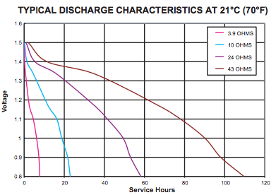

Definitely stick with a separate 12V supply; Six 1.5V batteries would start at around 9V, but steadily drop down to roughly 6V over their lifetime, causing the LEDs to progressively dim.
This chart is for a typical AA cell, triple A would have a rather shorter life at a given load..
