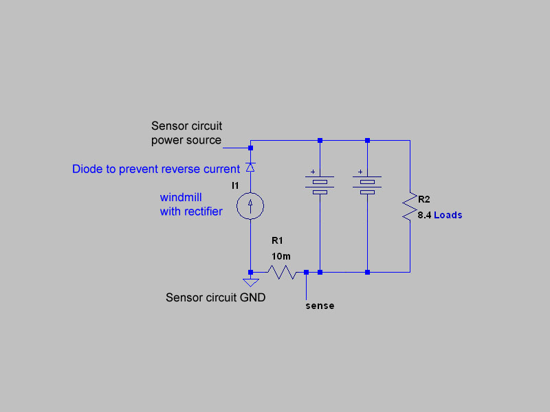

How would the circuit in the attached picture work?
Am I right in the folowing assumption:
when the windmill is generating a higher voltage than the battery array, a current will flow through the diode and through the batteries (and the load also of course) and through the shunt resistor. There will be a measurable voltage over the shunt that only corresponds to the actual current generated by the windmill, and not any other current drawn between the batteries and load.
The question is what happens when the windmill shuts down. In this circuit I put the power source point for the measurement circuit after the diode, so if the windmill shuts off, it will be powered by the batteries. However, the sensor point will be slightly lower in potential than the GND reference, but with a micro-voltage as the current flowing through the shunt at that time is only what dries the microcontroller circuit.
Do you see any problems with this design? I could of course power the sensor circuit before the diode, but it would cause the circuit to shut off if the windmill isn't generating power, which could be annoying but of course manageable, as it's a only a probe circuit and could be integrated in the windmills controller.
Edit: CafeLogic, I didn't see your post until after I posted my reply. Of course I need amplification. But as you mentioned I will have several power sources, several batteries and so on, so I don't want all the power of the whole system to run through a shunt. (could be over 100A so it wouldn't be accurate). On the other hand, my charging sources will be solar panels and small windmill which will not generate any large currents each, so measuring them separately won't need expensive high-current shunts. I will prevent large fluctuations in voltage in the system so I guess the voltage will be around 10-14V normally, but it depends on the voltage of the battery array when fully charged.

high/low side is irrelevant to reversing current. If the current flows backwards the polarity of the drop will be reversed (as ron stated). If the negative supply rail of the amp is at ground then the amp will output 0 + offset. The solution is to have the negative supply below ground so it outputs a negative voltage. You then need to offset it so your micros ADC can read it. However, if your charge line is different from your drain line, then you don't need to worry about it.
If you do need current from going both ways, rather than dealing with the negative voltage ADC problem, it is easier to get a pre-made sense amplifier with digital output (the ADC is built in), like the INA209 from TI.
A pre-made current sense amplifier is a great way to go if it is in your budget, they have all the nitty gritty specs taken care of and all you need to worry about is the accuracy spec, usually expressed in percentage. Most current sense amplifiers are high side monitors (probably because the incentive to pay more for an IC is less with low-side). To the best of knowledge (and I could be wrong), Microchip does not make one but everyone else does. TI, for example, had 53 listed on their website. The one i mentioned before is a high-side monitor. Your supplier will typically have a category for current sense amplifiers that is separate from regular op-amps.
High-side sensing isn't that much more difficult than low-side. Really the only difference is you have to find an op-amp with a high enough voltage rating whos input extends to the upper rail.
Ron, I think the last part of your post can be confusing and possibly perpetuate a common misconception so I want to make something clear when people read this thread later.
Isolated inputs are awesome but unless your amplifier was billed as an "isolation amplifier" and cost at least $5, it does not have them. While working with your typically differential/instrumentation amp, with very few exceptions, you should not be sensing any voltage which is above or below the supply rails. That statement does not only apply to the difference. For example, your op-amp is powered by -5 and +5. You figure you can measure 10 volts at the non-inverting input and 12 volts at the inverting because the difference is only -2, wrong, no, don't try it. However, if your op amp, is powered by a separate isolated supply (like the op-amp in your multimeter, powered by batteries) then it cannot "see" the voltage of anything with respect to a different ground. In that case, only the difference matters.

I will in the first place not read bidirectional current, simply because I want to maximize resolution. I will instead have several measuring points.
my device will be split into several "consumer circuits" and several "charger inputs", so I can measure them both, and they will only have current flowing one direction.
If I did put the measuring on the batteries I would off course be forced to cope with current flowing both ways.
The GND must be possible to have common for all consumer circuits, therefor I won't be measuring low side.
