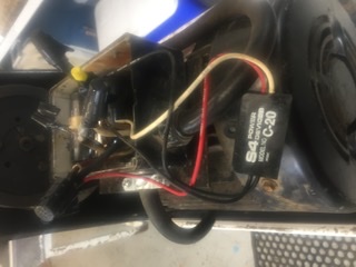

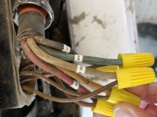

There are 5 wires at motor, three are windings I believe L1or(11)possibly common? 5&6, then 1&4 (centrifugal switch I believe?) these 5 wires then go up to a termination box with what I think may or may not be a solid state relay? There's 2 capacitor's wired in series, as well 230V supply.
I'm not able to find wiring diagram and model number gets me nowhere ugh.
Is there anyone out there that is familiar with this type of motor? What type of induction motor? Wiring diagram? What is electronic's tied to centrifugal switch relay? not able to find this S4 Power device model C20 anywhere either
The way it runs was in reverse so I swapped 5 and 6 at motor, direction changed but I smoked a capacitor (415 to 500mF) I replaced and now the other cap is starting to smoke. Wiring at motor is odd to me and really struggling with this.

This looks interesting - the two diagrams in the centre of the first page are for GE "KC" type motors, five wire with numbers similar to yours..
Looking at the centre one with the 9 terminal switch, it appears live is always to 4 and neutral to 6.
For one direction, live links to 1 and 5-6 are joined, for the other direction live links to 5 and 2-6 are joined.
I'm guessing the motor was originally designed to have the capacitors attached to its body and permanently wired to certain terminals, along with the centrifugal switch?
Does that seem to fit in with the way it was wired when it ran OK?
Nope it doesnt mean it cannot be reversed with the wiring, it was just an alternative suggestion to thiink of if you were struggling with the electrics.
Even though all of the wires from the motor are brown, it looks like the insulation is individualy numbed. e.g. T2 etc,
Those are standard terminal numbers.
What does the writing on the black box your calling an "electronic relay" say? It could passably be a "potential relay". Commonly used with sealed refrigeration compressors, but sometime used to replace a bad centrifugal switch in an otherwise good motor. Knowing what the writing says would tell more about the "electronic relay".
  • Potential_Relay.pdf
I have seen another way used to switch out the start winding when the motor gets to near it's design speed. It uses a relay with only a few turns of thick wire for the coil which is connected in series with the main winding. When the motor is stopped or running below it's normal speed the main winding current is much higher than normal so the relay pulls in energising the start winding. when the motor is up to near normal speed the current drops so the relay drops out removing the power to the start winding.

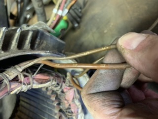

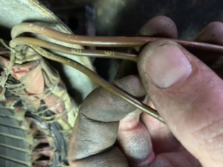

Gents I pulled motor apart in hopes to understand what type of motor I’m dealing with, found that all windings are the same size which is confusing to me.
#1,6,(L1) 11 are on bottom of one side and 4,5 come out on opposite side (top).
I’m quite stumped with what type of motor this is and no idea on how to wire without diagram.
Could it be that there’s 2 run windings, 1 start winding with electronic relay and 2 caps wired in series for start winding? (230V)
Added couple more pics. I’m just adding this and will be reviewing all comments I missed after pulling motor apart.

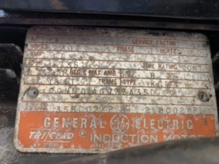

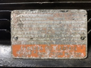

it is a GE Triclad Induction motor.
3HP, 230VAC, 17A, Cont Duty, Type KC, Frame 184T
Model number: 5KC184AL3050 (zero info out there that I could find)
There’s bearing numbers on name plate for both ends of motor which tells me age is up there because it’s maintainable.
On name plate also has “conndiag#”
Which I interpret connection diagram??
# is 733A350 but I’ve found zero info on as well.
The electronic potential relay is in pics and I find zero info on as well. It has 2 black wires that I feel are coil inside ? And opposition side is a red/white which I believe to be contacts open/closed. ( no power as device sits contacts are open tho another confusing thing to me) but without diagram hard to say if it’s correct/good/damaged etc?
Just another note there is no centrifugal switch I was confused on this above but as you gents said that’s what electronic relay (S4 power Device, model c-20) is for sorry this thing has me quite confused and worked up ha.
I would like to add one more thing because my findings when opening motor and found all windings are exactly the same size wire, when ohming out there’s no high resistance on any of leads like a start winding would usually have ...would this be why the 2 caps are in series and such a high rating? And possibly 2 run windings without caps?
Ok thx MAX, all great info so my understanding is you would think in my situation the relay I have would be “current” sensing hence contacts open .
