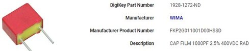

Generally speaking polypropylene capacitors are very high rated, especially the WIMA versions.
If the cap is polypropylene it must be a smaller motor?
One manufacturer I use for start caps is CDE, they make high grade oil filled paper versions for motor run conditions.
Historically Wima were the most unreliable capacitors available :D
'Back in the day' if you had a faulty amplifier, tape recorder etc. the first thing you did was to look if there were any Wima capacitors fitted - then blanket change them, and see if the fault was cured. Most of the time, that solved the repair :D
No point in fault finding while there were still Wima capacitors fitted!.
I'd like to think that they are more reliable now, after all the decades.
Interesting!
The bottom line for me, is to use run capacitors that are designed specifically for this purpose, CDE etc,
Definitely NOT start caps of Chinese origin. !

Indeed, Wima has had its poor reputation.
But is this still true on 2025?
I'd like to think not, but historically just looking for Wima capacitors in faulty items almost always found the problem :D
You didn't need a multimeter, a scope, or anything else - just a pair of eyeballs and a soldering iron. It wasn't even worth starting fault finding until you'd replaced all the Wima capacitors - luckily there wasn't usually that many of them.
