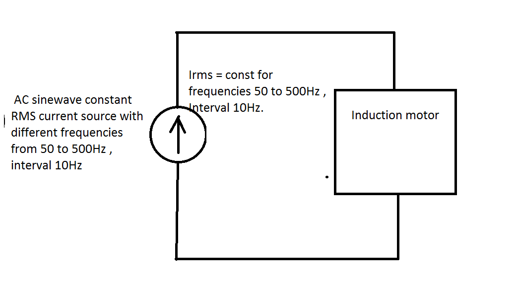

What will happen with Power and Torque if I supply simple induction motor with constant RMS current at different frequencies.
Let's consider "Ideal" Motor. No or very low losses (Eddy current, friction , stray , hysteresis and so on).
Let's say range 50Hz to 500Hz , interval 10Hz.
Power at constant RMS AC Sinewave current ranging 50Hz ... 500 Hz
Increasing, Stays the same, Decreasing
Torque at constant RMS AC Sinewave current ranging 50Hz ... 500Hz.
Thank you.

If I change/adjust voltages quickly at specific frequency, depending on loads in order to maintain constant rms supply current.
Increasing frequency. Const. rms supply current. Torque = Increasing/Decreasing
Increasing frequency. Const. rms supply current. Power= Increasing/Decreasing
