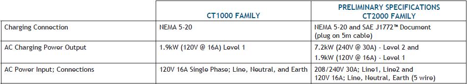

It says in the datasheet of the EV Charger:
nema-jpg.33711
Does it mean that the cord which connects the EV Charger to the vehicle passes 30A or 46A?
Moreover, why are two lines of 30A needed if only one 30A line is used in the output?

There are two charge levels on the right column: the low level uses only the 120V/16A line (level 1: 1.9kW). The higher level 2 uses a 208/240V@30A three phase power for 7.2kW charge power. The 120V uses two wires (line and neutral) and the 240V three phase uses two lines and neutral. Total of five wires: Line(120), Line (240), Line (240), neutral, earth ground. Each 240Line is rated for 30A, the 120 Line is 16A.

Do you think that the operator should choose between higher level (fast charge) and lower level (slow charge)?
You would use slow charge if you have the time and fast charge only if you must. fast charge will likely be less efficient because it pushes the power converter harder. It also increases peak power usage.
