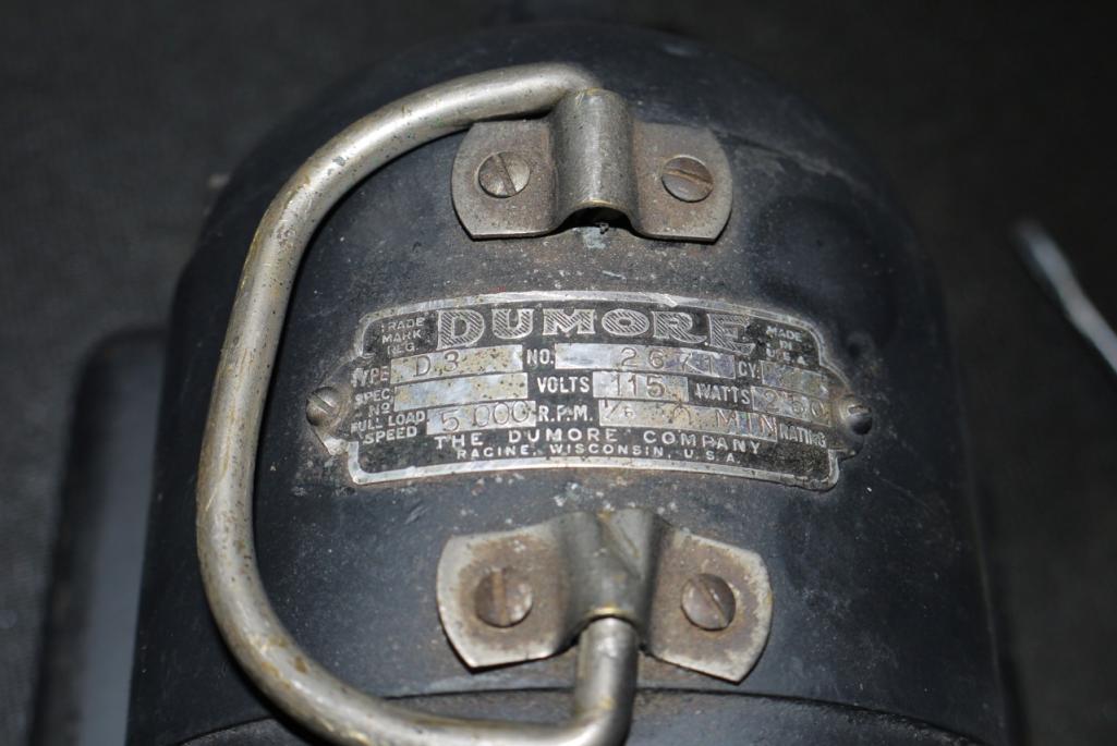

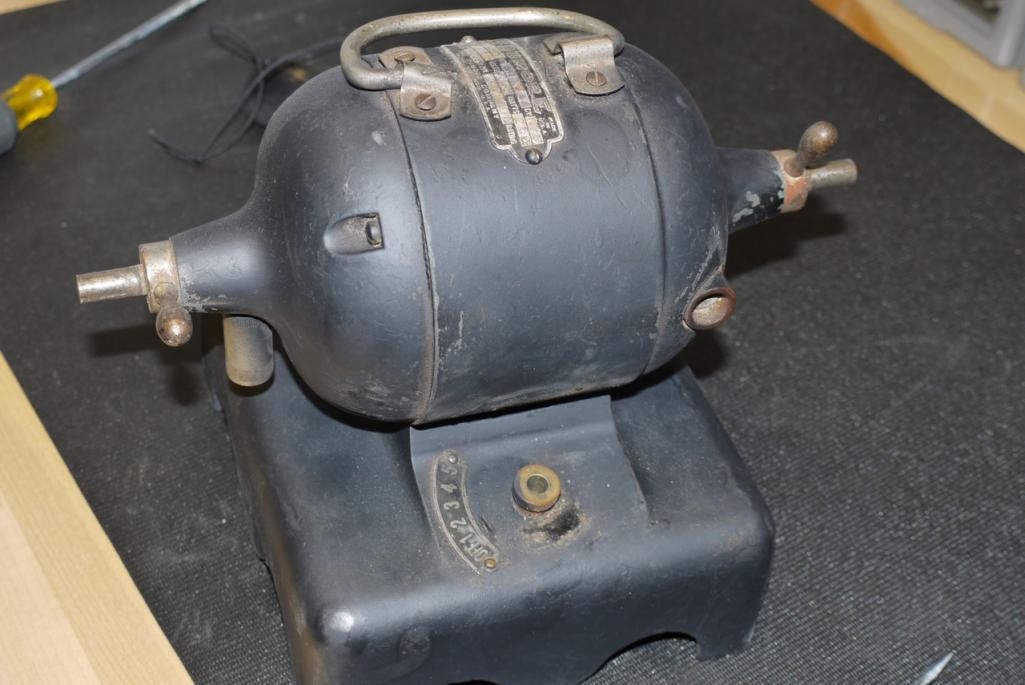

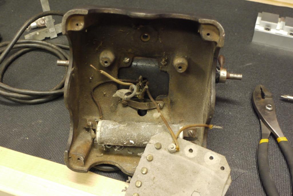

I recently picked up from a flea market for 5.00 $ a little Dumore D3 dental lathe made in 1938 !!! I started restoring it because upon inspection at home I noticed that the main cable was damaged and there is no ground at all; the engine works but I would like to restore it and modernize it a bit.

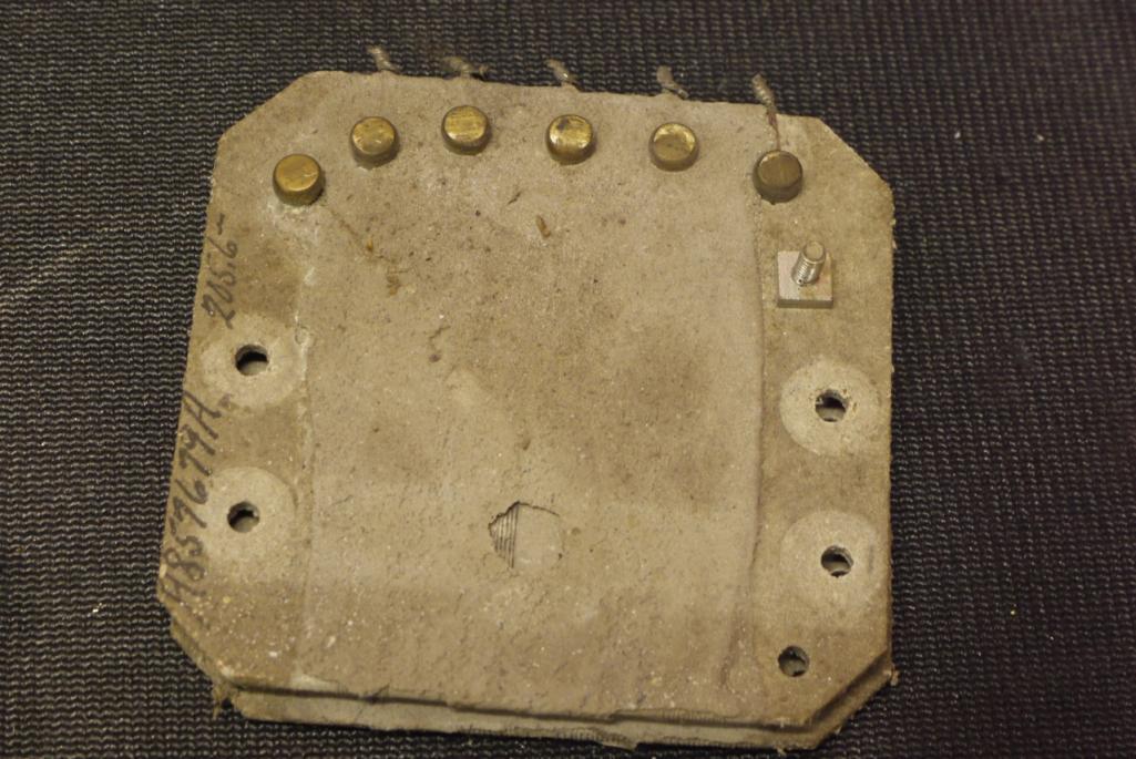

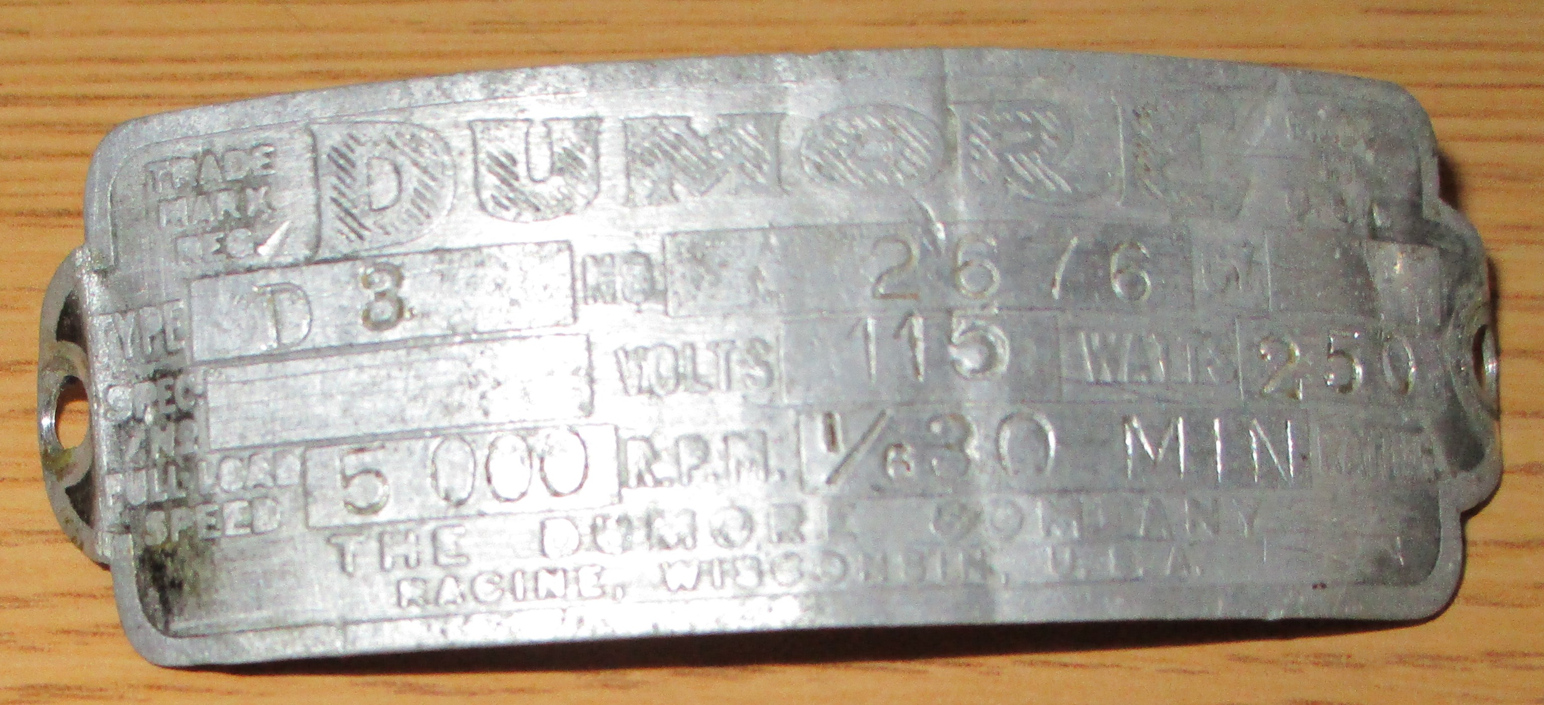

First off, the label says " Type D3 N0. 2676 Volts 115 Watts 250 full load speed 5000 RPM 1/6 30 min rating " now, it has a little know to select the speed, and it is double shaft. Upon taking it apart it had a cylinder wrapped in tiny metal ( I guess a resistance???) that was falling apart and some "thick sheets of paper and wax like material " what is it???
Could you guys help me restore it and make it safe? Pics are to follow.

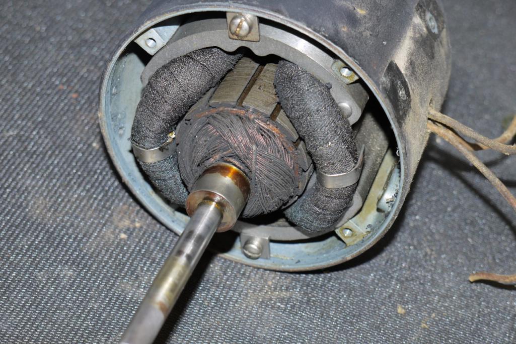

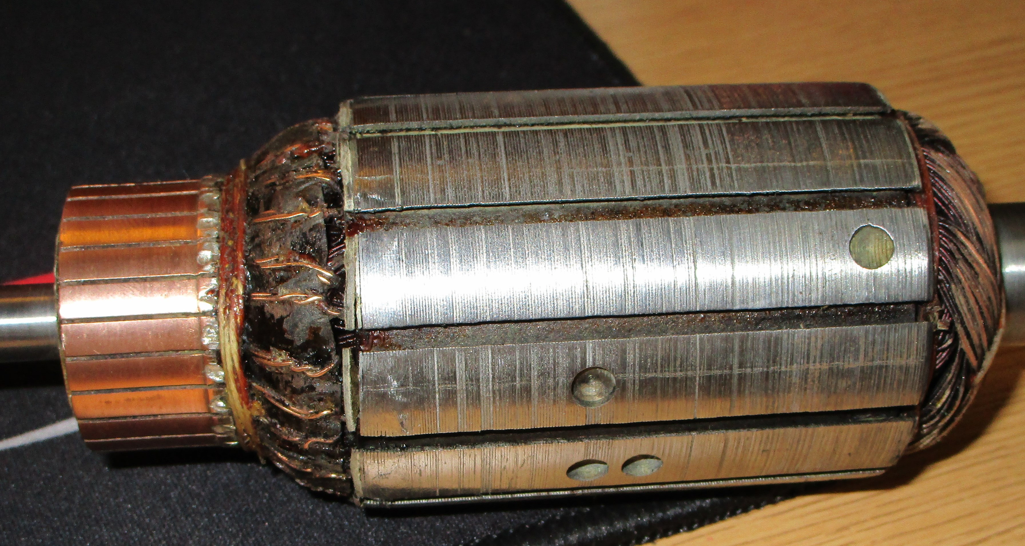

more images of the shield and motor ( It is a brush motor with little cilynders full of oil to lubricate the bushing-bearing

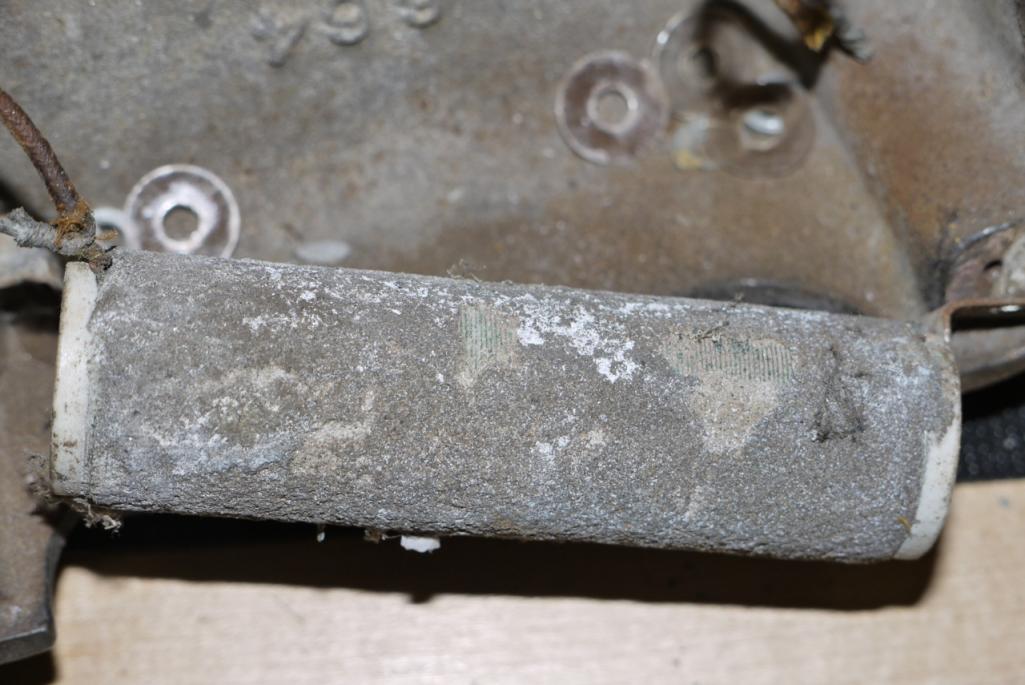

Correct.
That looks like a wirewound resistor.
That looks like a wirewound resistor with several tapping points (the brass studs).
That is a primitive speed controller, there should have been a wiper contact attached to the knob which selects the "speed numbers".
That wiper would contact the brass studs to vary the resistance and hence the motor speed.

Thank you JimB,

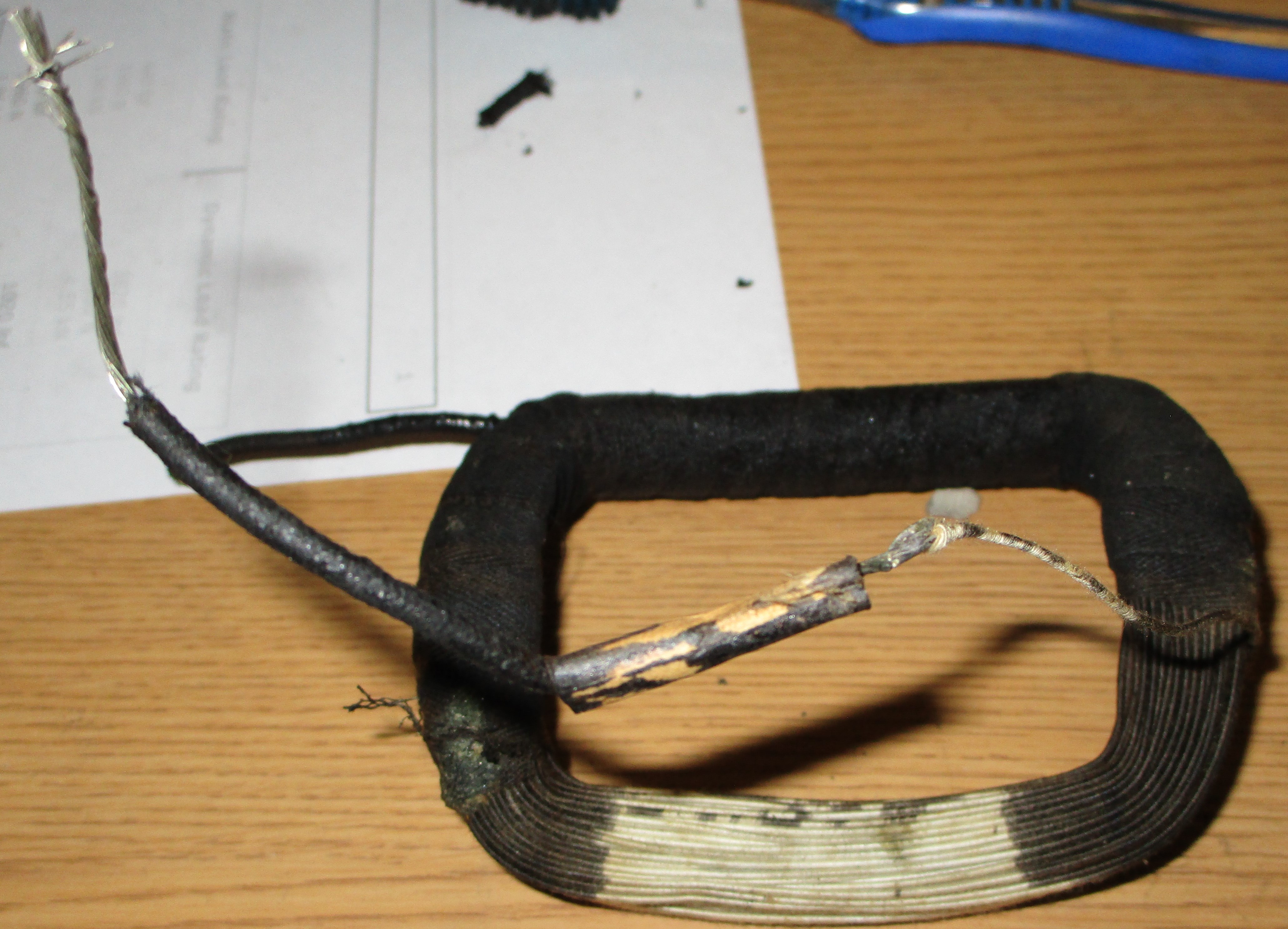

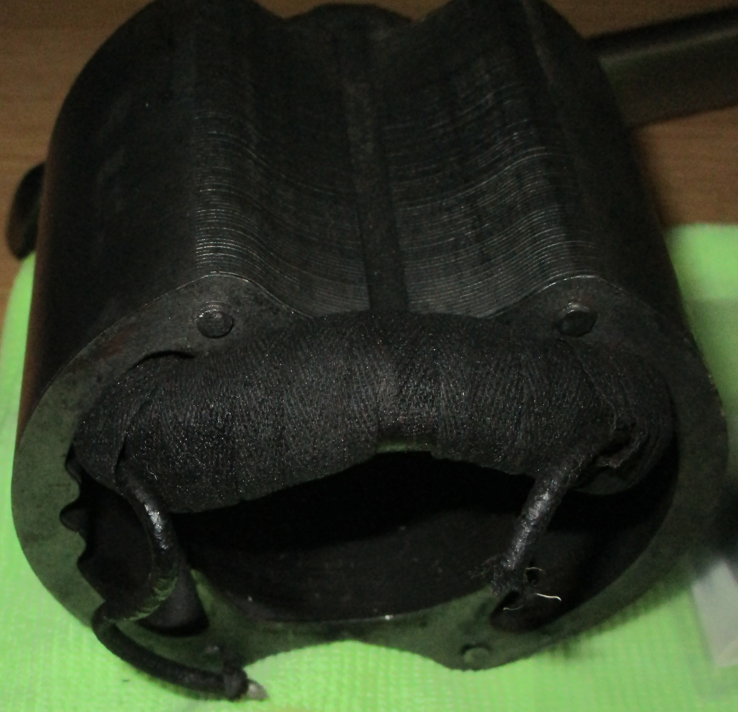

there was a wiper device as well, I just didn't take a picture of it. You think I can replace the wirewound resistor with a modern one ( the only info on it says 140 ohm) which one should i get to replace it? I want to replace it the speed "selector too and use a potentiometer to regulate speed. But how would I go about that???
I'm also planning on replacing the wire field around the shield as wires are covered with like " cloth material" and falling apart, the metal also it is not copper but it is grey, maybe lead???

The field coil wire will be copper, but most likely tinned copper, it is quite common and was used even more with early cables as bare copper reacted more with the materials used for insulation.
The insulation is a wrap of cotton thread. It was used for "magnet wire" before plastic insulation was developed.
Or two wraps of cotton in the case of DCC wire - Double cotton covered..
You can actually still buy the stuff for renovating old gear - https://www.wires.co.uk/acatalog/dc...QrTtCh08Owv9EAQYASABEgJjbPD_BwE#adc0450_2d10m
ps. I'd dispose of that speed switch, or soak it in oil or something to prevent dust particles if you want to keep it for dimensions - it appears to be built on asbestos board.

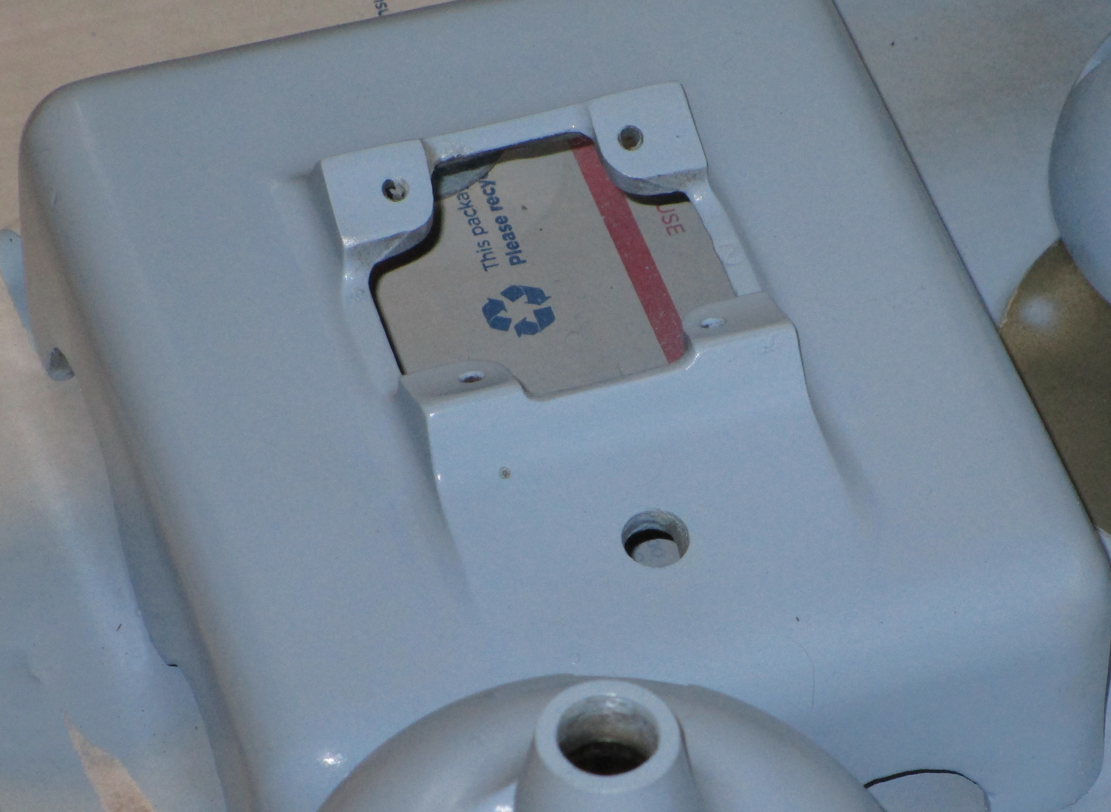

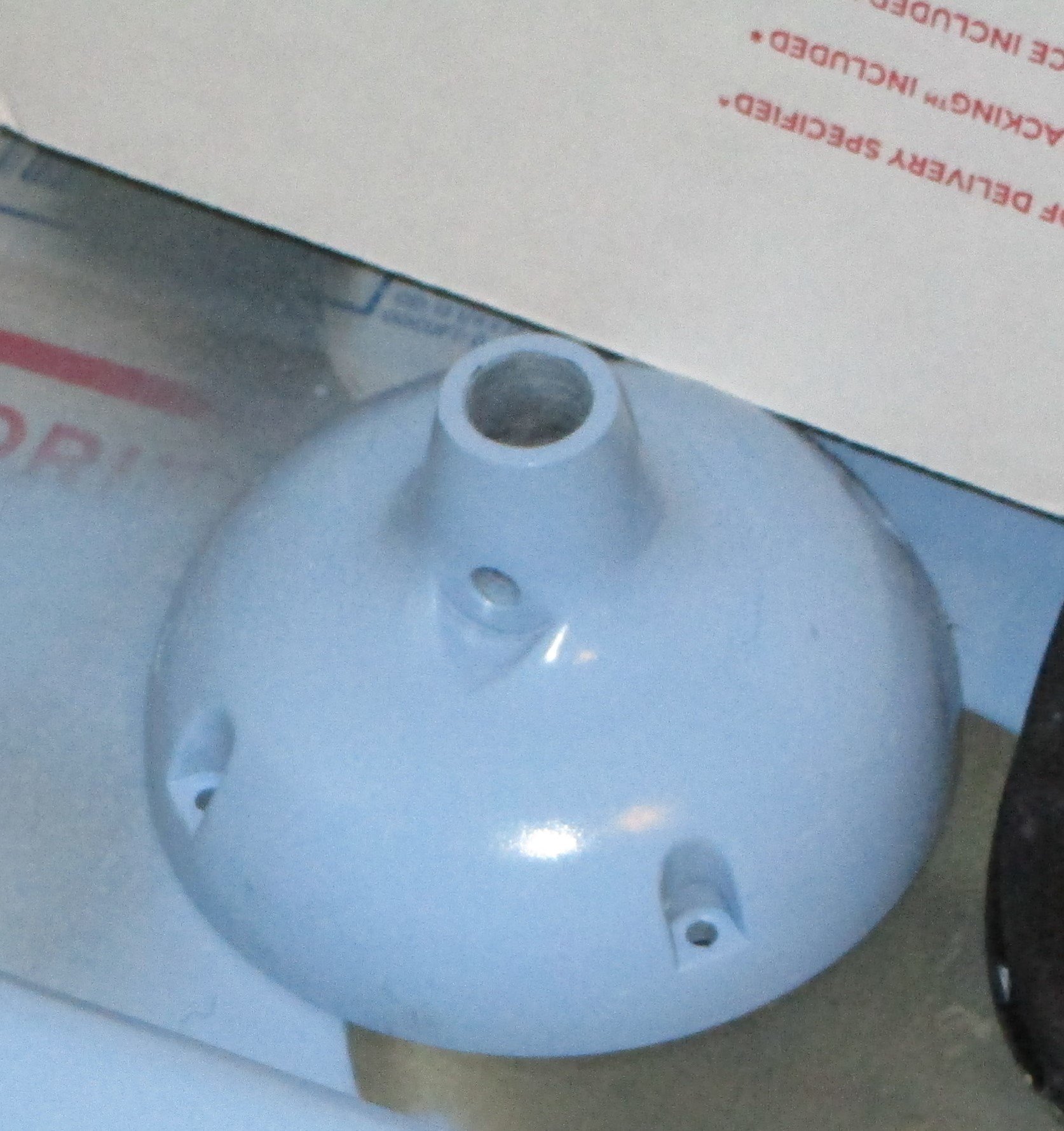

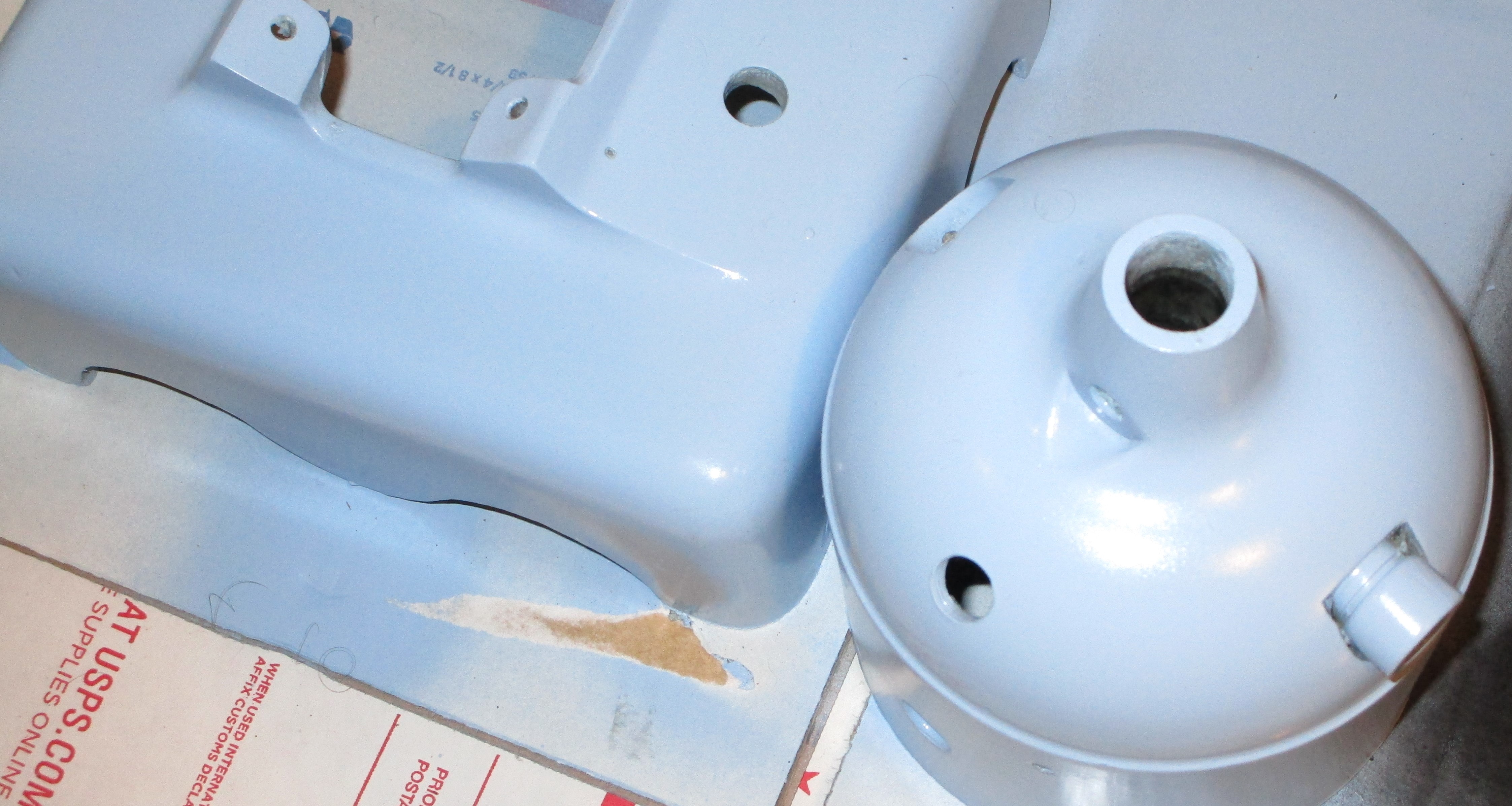

Thank you friends for all the help and suggestions. I am afraid that those resistors are indeed asbestos board; I plan on getting properly dispose of them and modernize the little device. What king of wire-wound resistor should I replace the old one with? The old one just says 140 Ohm on it. I was planning on rewiring the armature shield coil with new copper wires and then use varnish as insulator, would that work? and what thickness of copper-wire should I use? I am unsure on how to connect the wires to the speed controller ( planning on getting a 20th century one install along with a ground cable.
In the mean-time I painted the shell ( sanded, primer and two coats of paint and clear-coat.)

Ohh, the original paint looked so nice - like a survivor. The new restoration trend is to clean up the surfaces as well as possible, and call it a day. No fresh paint unless you can find the replica paint.). No need to regret the past, it is painted and looks good. Just something to think about for the next restoration.
I thought it was a good idea to paint it again, that color reminded me of machinery shops ! Oh well, lesson learned, guess I'll try to stay close to original paint next time,
Unwrap the cotton from some of the old field coil and measure the bare wire with a micrometer or vernier caliper.
Try in a few places to makes sure it is consistent.
You need to use exactly the same diameter of copper as was originally used if possible, with the same number of turns in the coil.
You may not need any extra resistors if you are using an electronic speed controller; the motor should be configured as it would be if the speed switch was set to maximum, then the electronics take care of reducing it.
