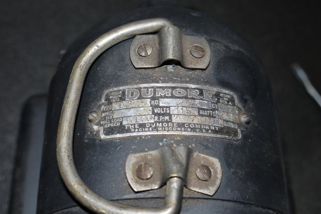

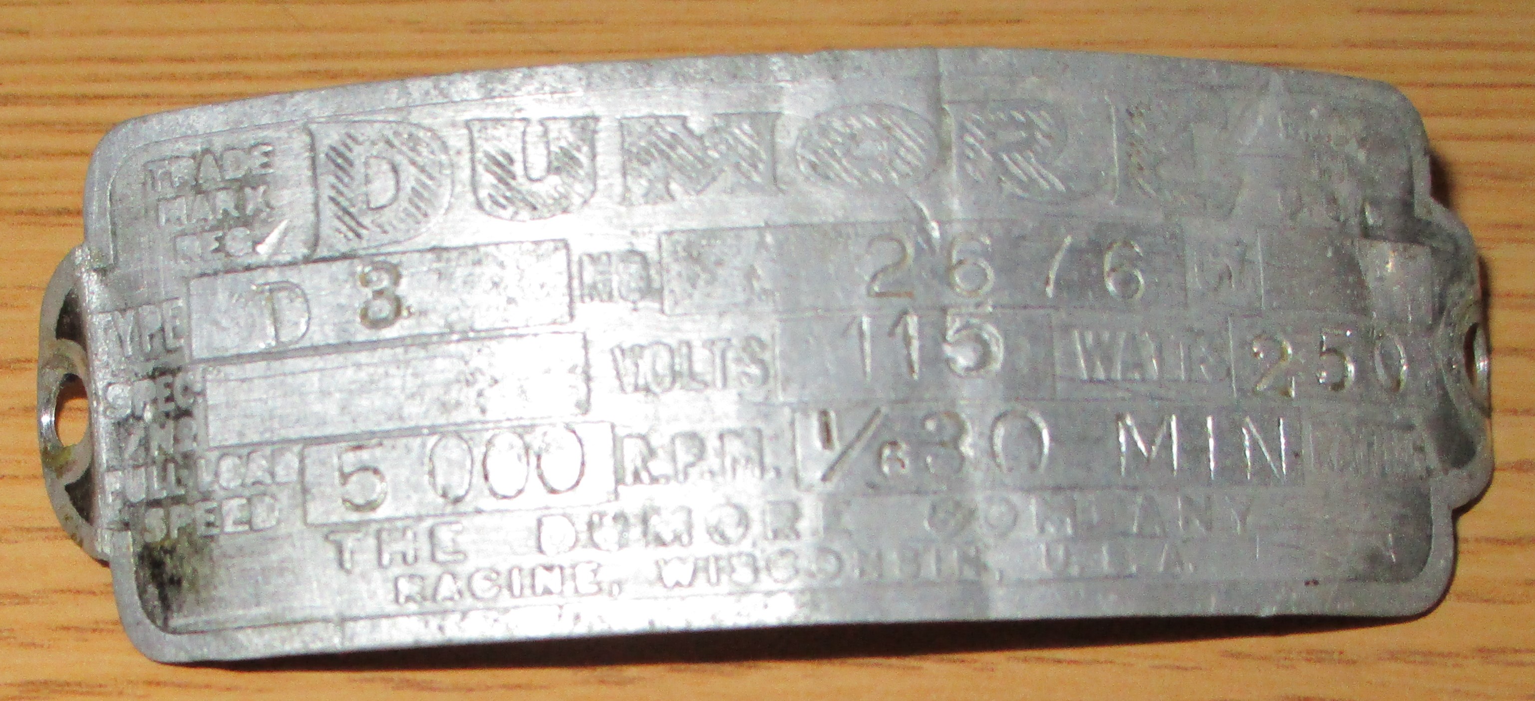

I can spot them at work... the only civilians, I am military lol jokes aside, thanks for the advice! I will post pictures of the clean-up as I go and as I install new wires and give it a new life. Quick OT the metal tag with all the info, how can I restore it? Was thinking of spray-paint it black and then either color the words with a paint-pen of with a piece of sand-paper make the letters appear again, what would you advice to do?
Post a photo of the tag.
