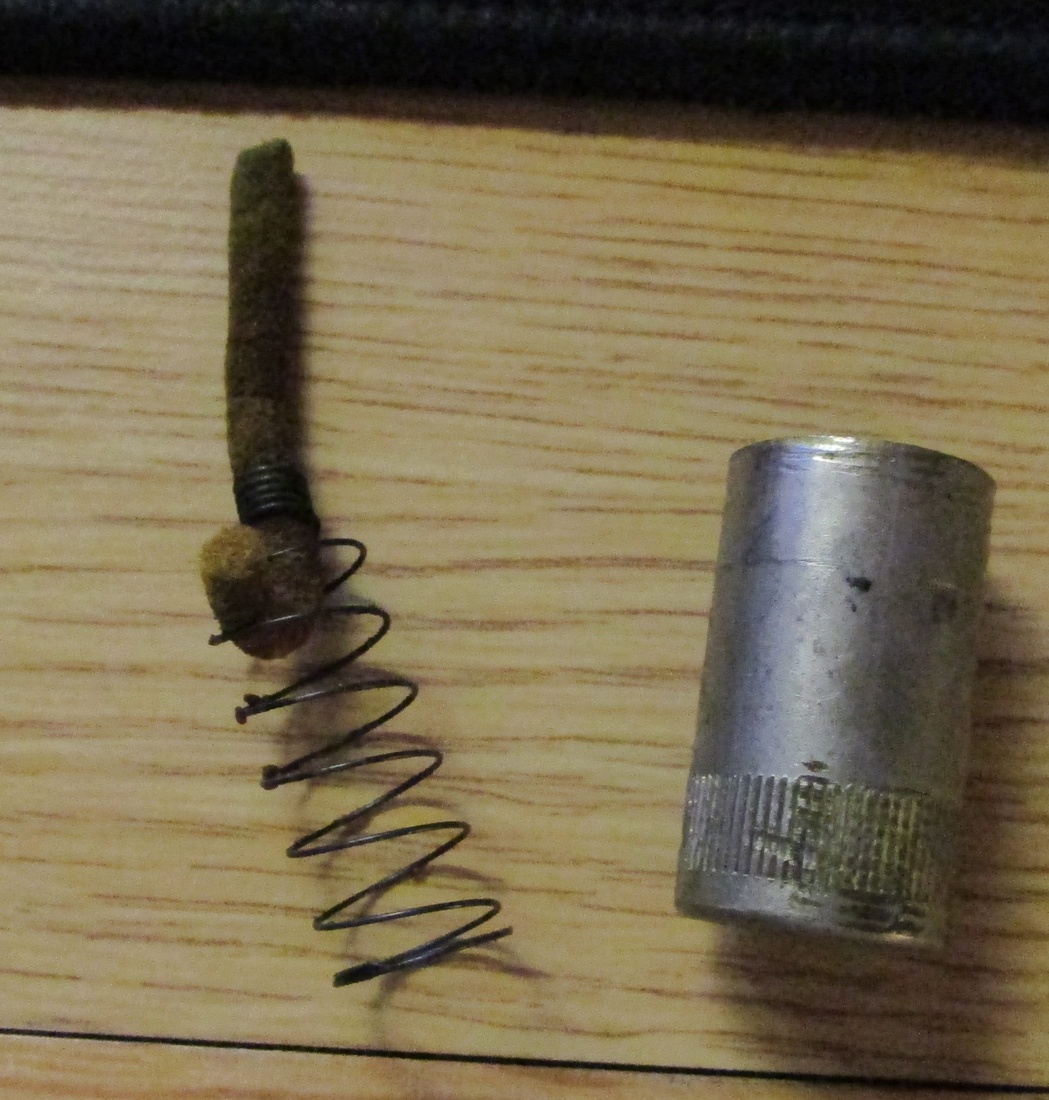

That wick ( hope that is the correct name for it) is attached to the spring and immersed in that little cylinder full of oil ( it lubricates the motor shaft while in use I believe). Where would I find wicks suitable for that purpose? If I wanted to replace the spring do I just need one with the same lenght/diameter?

Why would you want to replace it? You seem to be doing things to this just to be doing things. Those wicks were usually made of wool felt, back in the day.

I tough it might be a good idea since they are pretty filthy and old as well. Somebody did put grease in the cylinders instead of lubricating oil and the wick is pretty nasty. Should I just put new oil in the cylinder and use the old wick or replace it?
