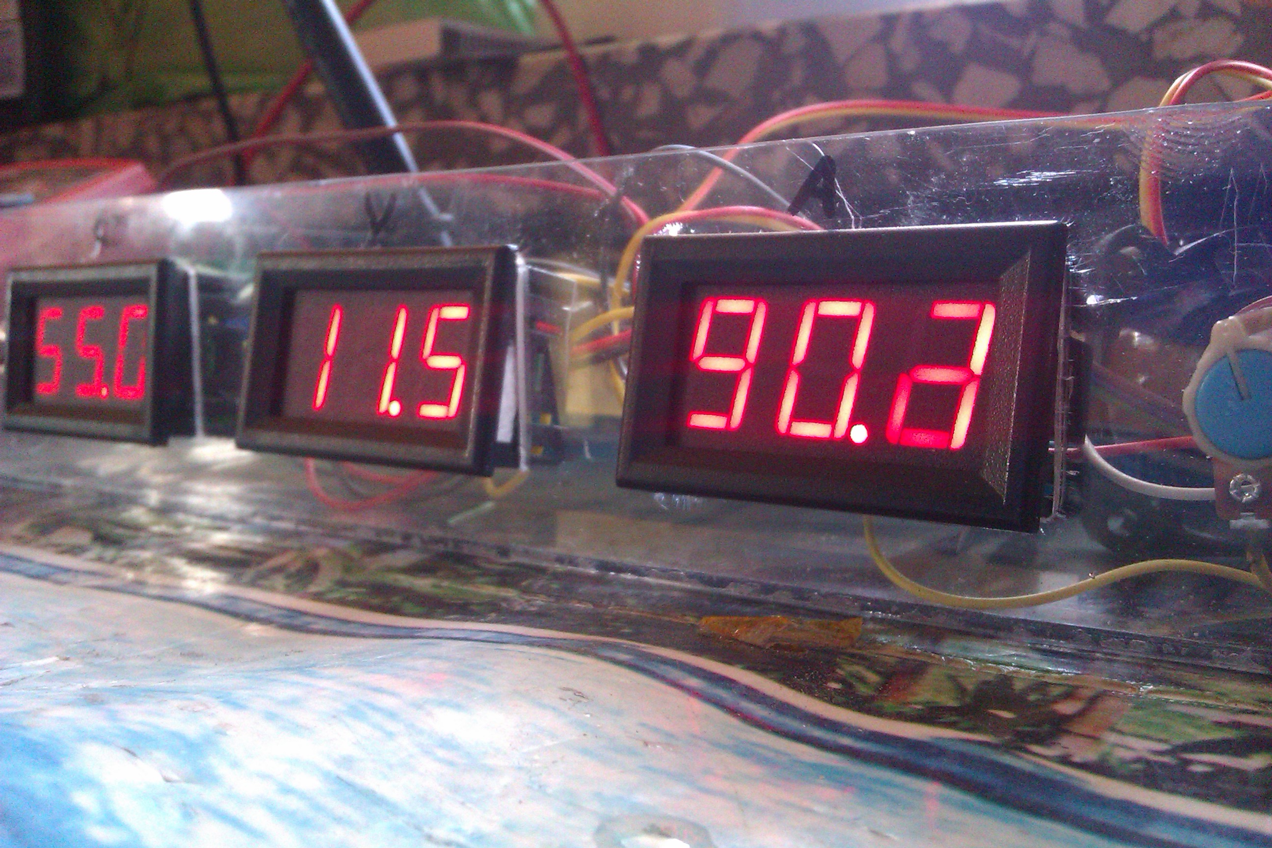

I get 90AMPS!
Mosfets are still working, but please don't suggest on temperature(first display) because water was from pail, not from tap as it should be.
Power supply was rated for 72AMPS, but OLP shut down PS on 93-95AMPS :D

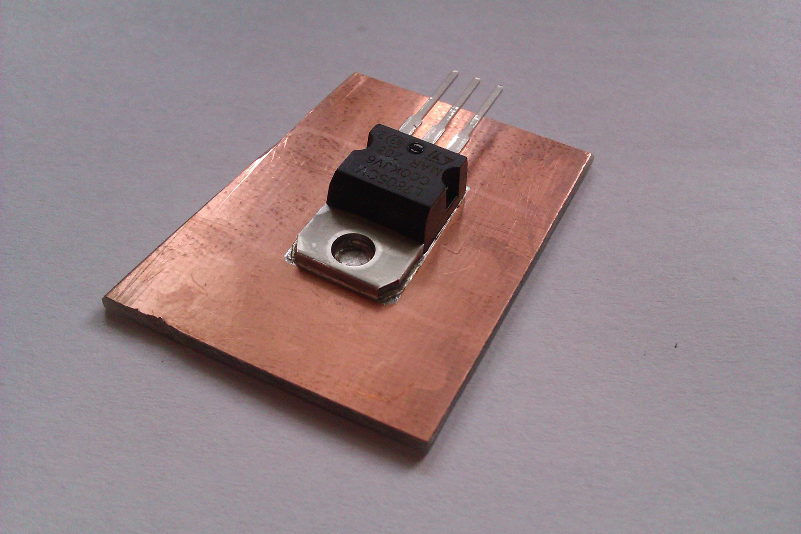

My first soldering of mosfets to copper pipe was terrible, now I know how to do this correctly, even "proffesional" and I will post here how I will do this next time.
The biggest problem was not to heat too much mosfets and escaping solder from mosfets.
So I got idea with soldering paste and capton tape.
Example is on PCB but this is the same with copper pipe.

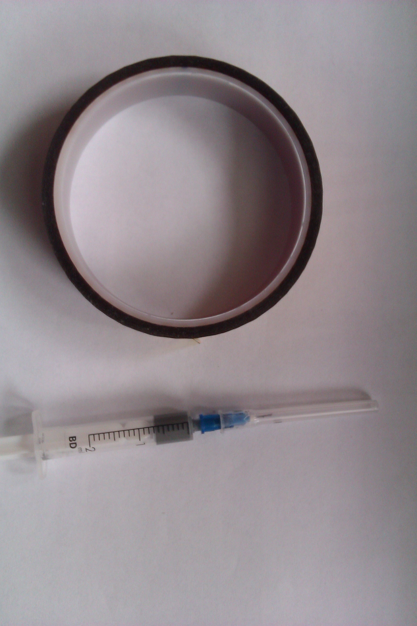

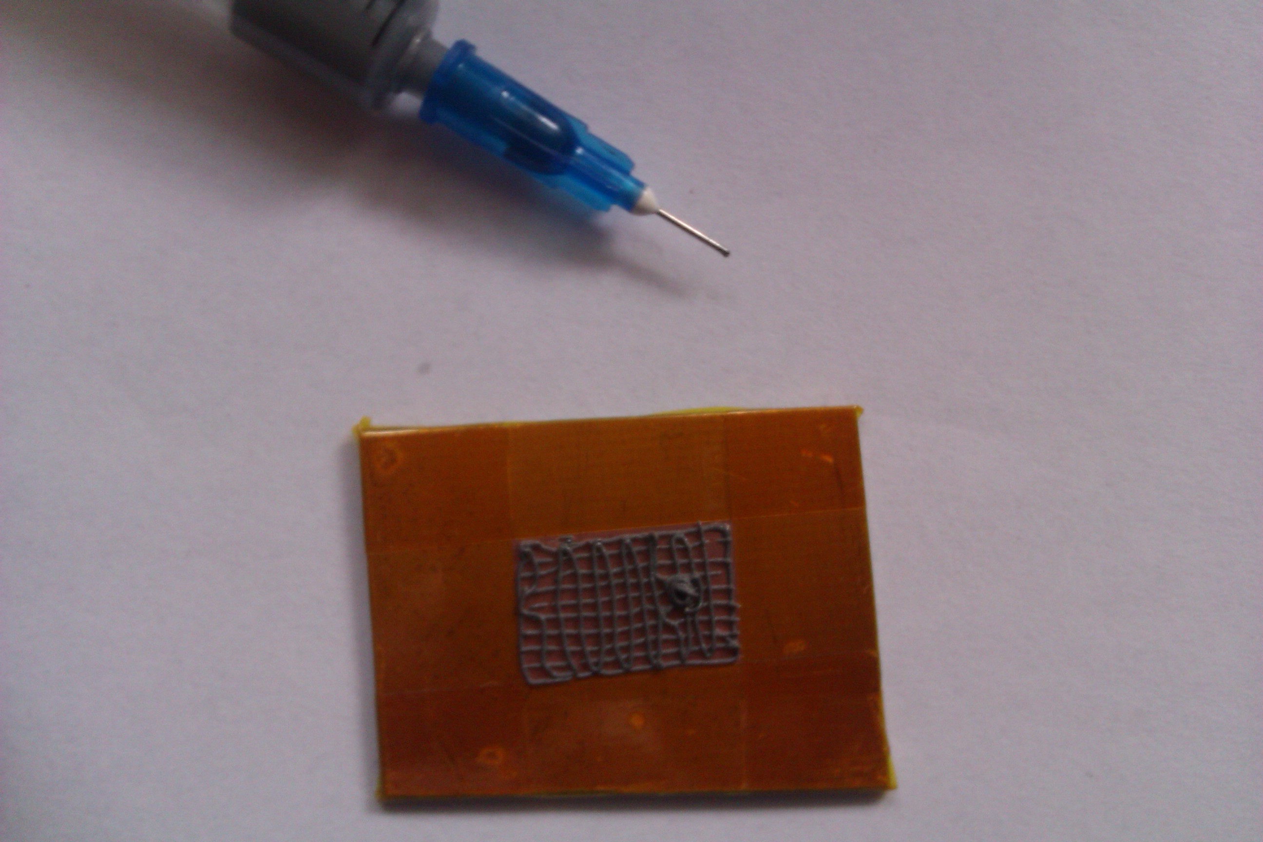

And here is what we need:
This is capton tape and soldering paste in syringe(**broken link removed**) this is heapest paste I find, but this paste is very good and do what it should do, but this paste don't like air and should be storaged in fridge.

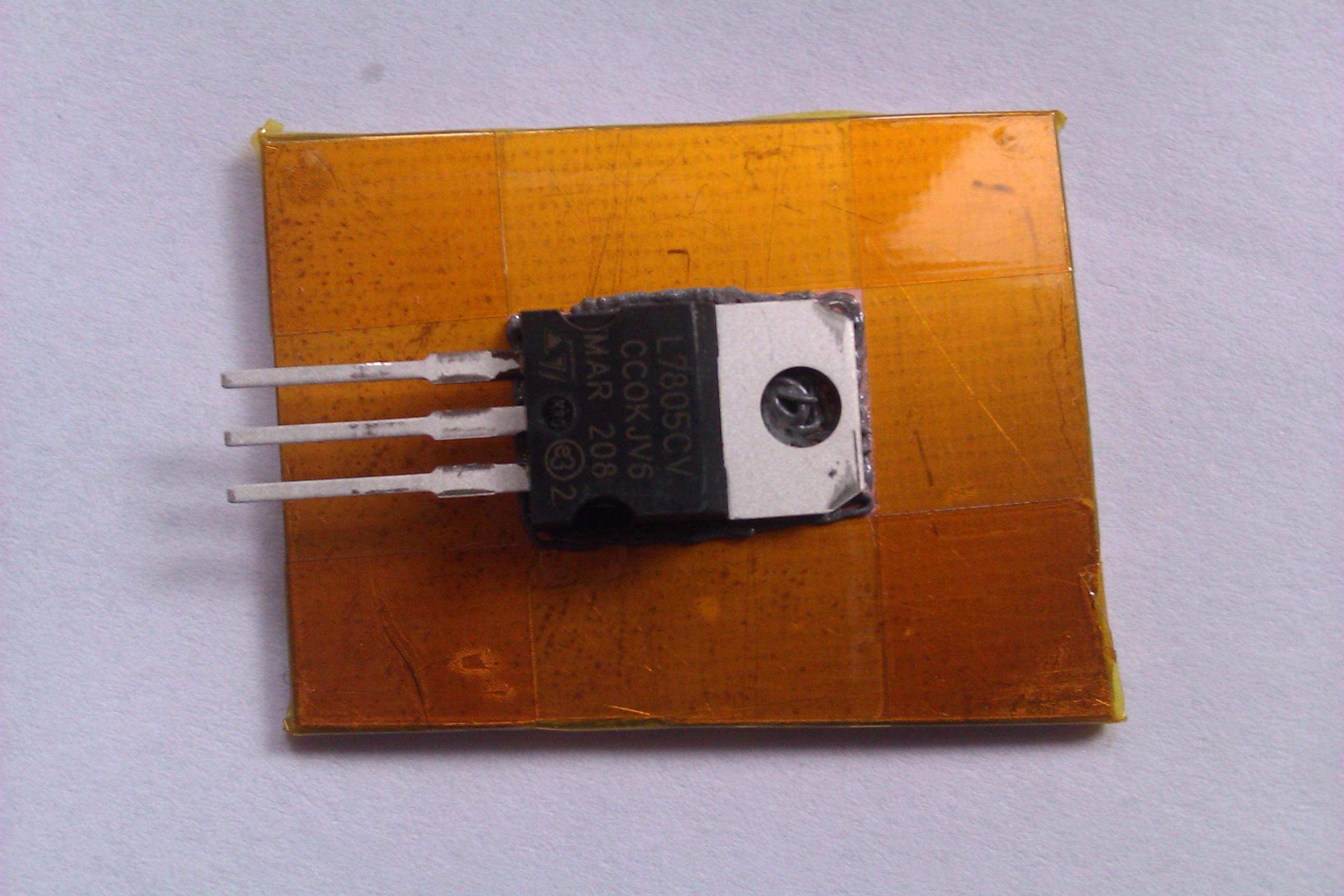

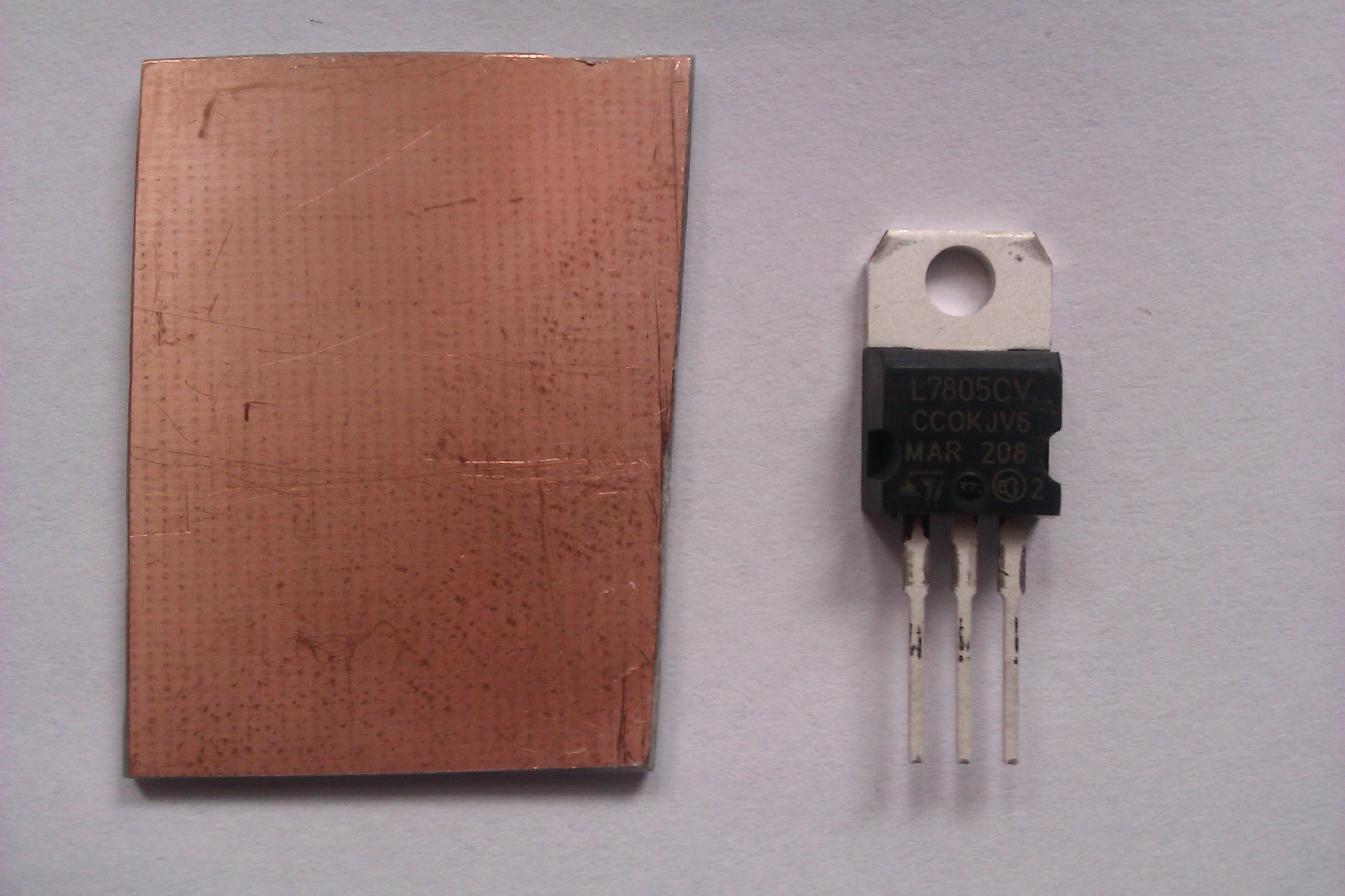

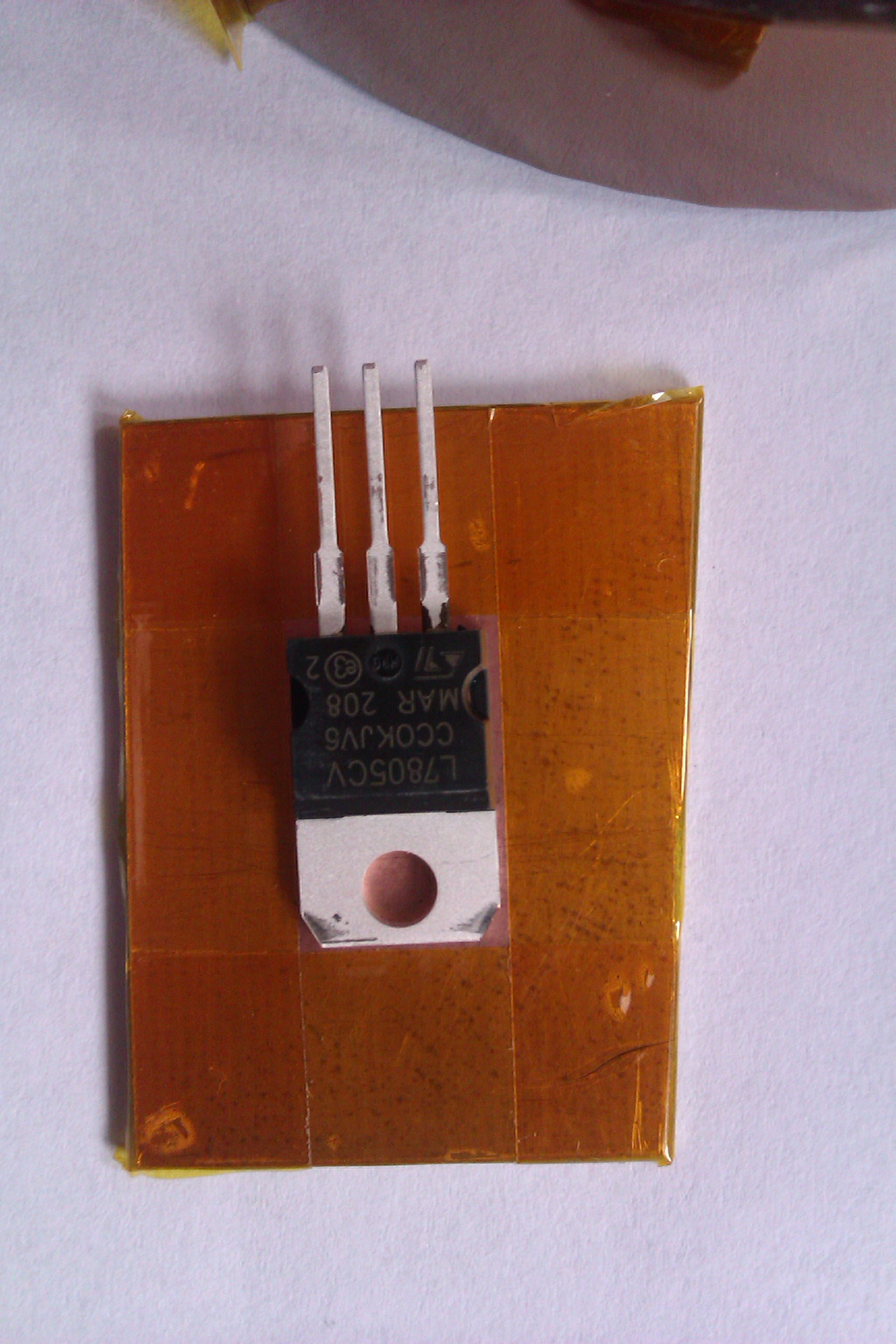

So, frist clean copper pipe/PCB and put capton tape like here:
Then add soldering paste:
Put on this your mosfet:

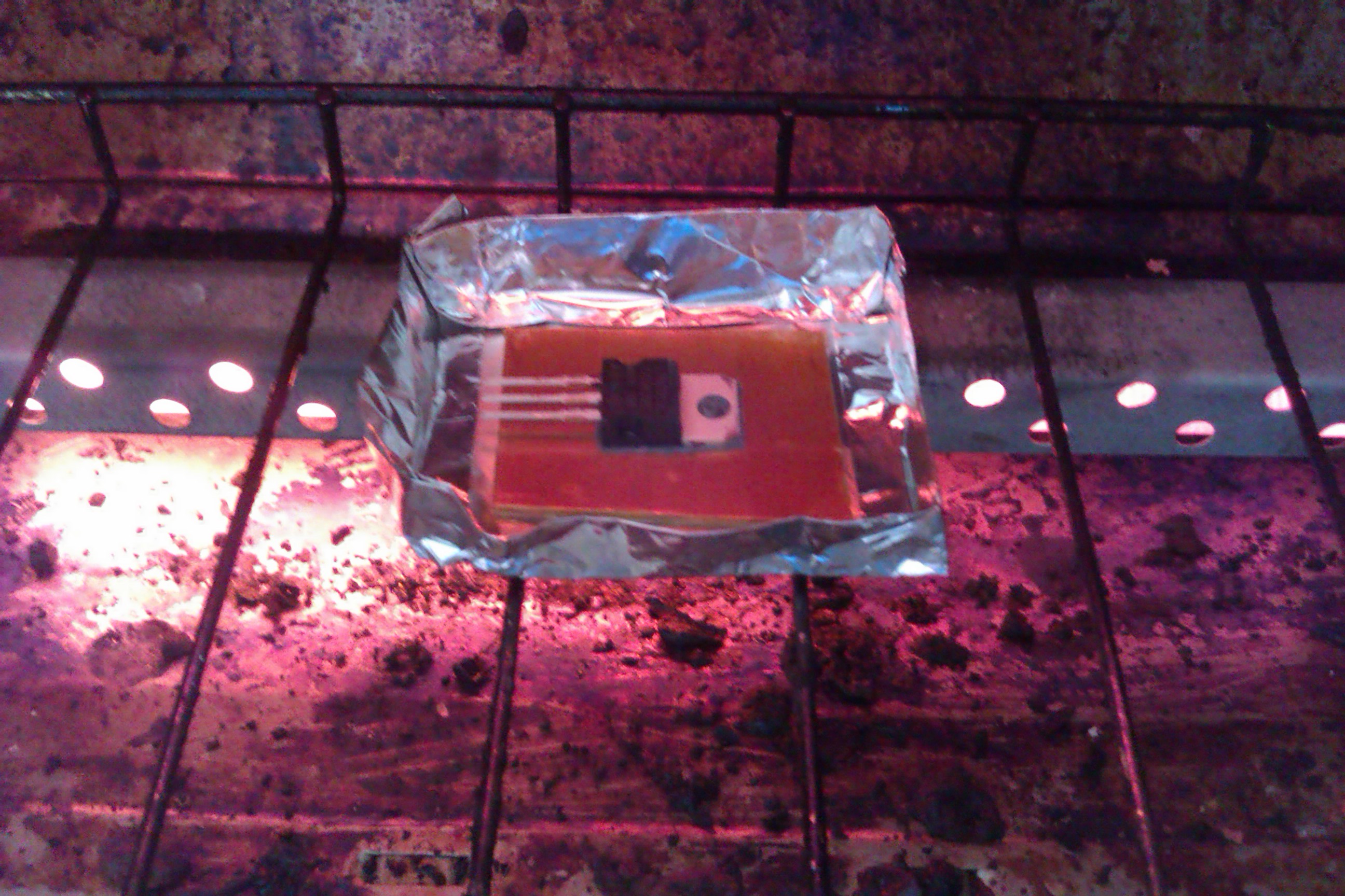

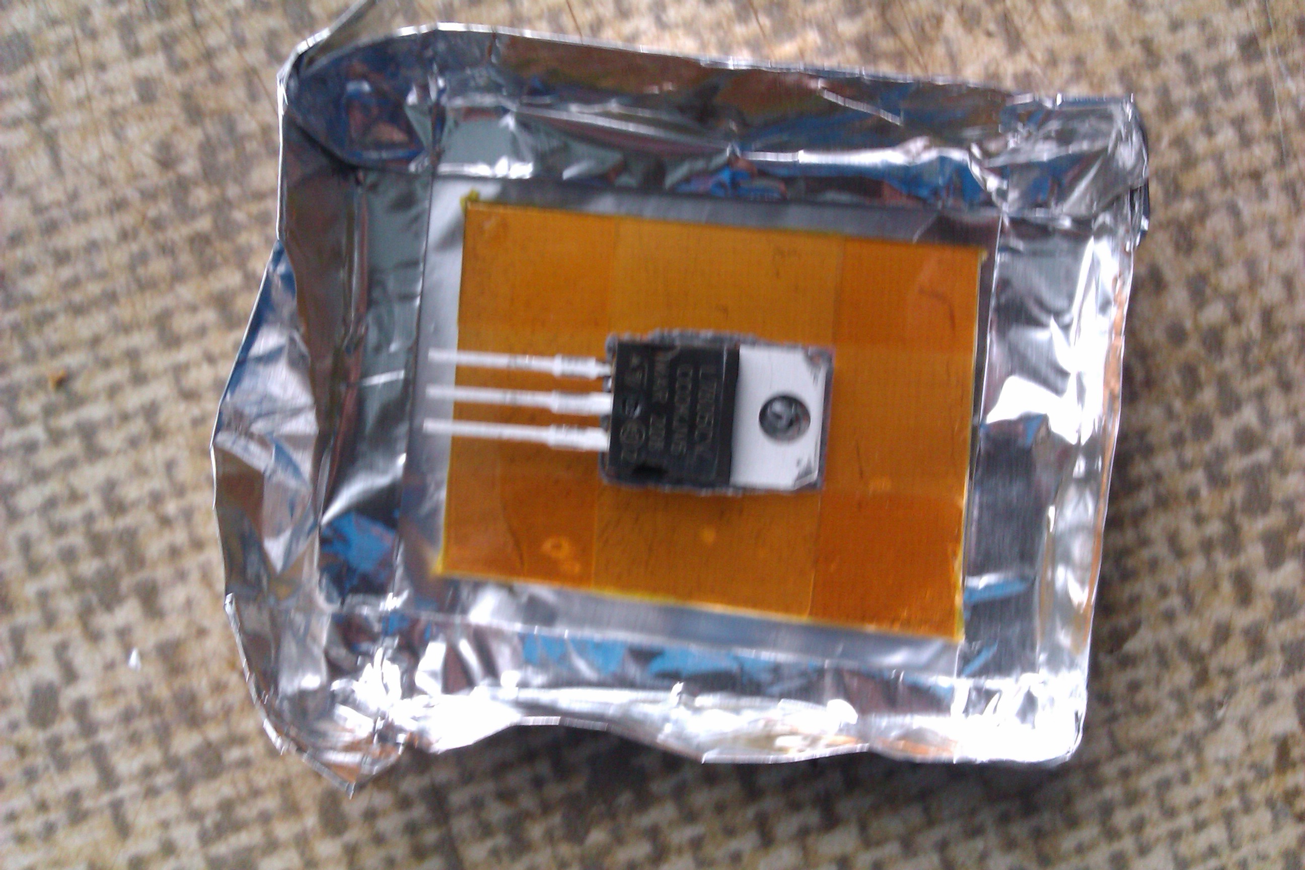

Soldering process can be done in kitchen oven, we don't need PRO oven with temperature controlling.
I use little oven.
Put your copper pipe/PCB on aluminum foil:
And in my dirty oven:
Then keep an eye on this, when solder paste will be melted turn off and open your oven
to cool off.
Then unstick capton tape and clean from flux using alcohole.

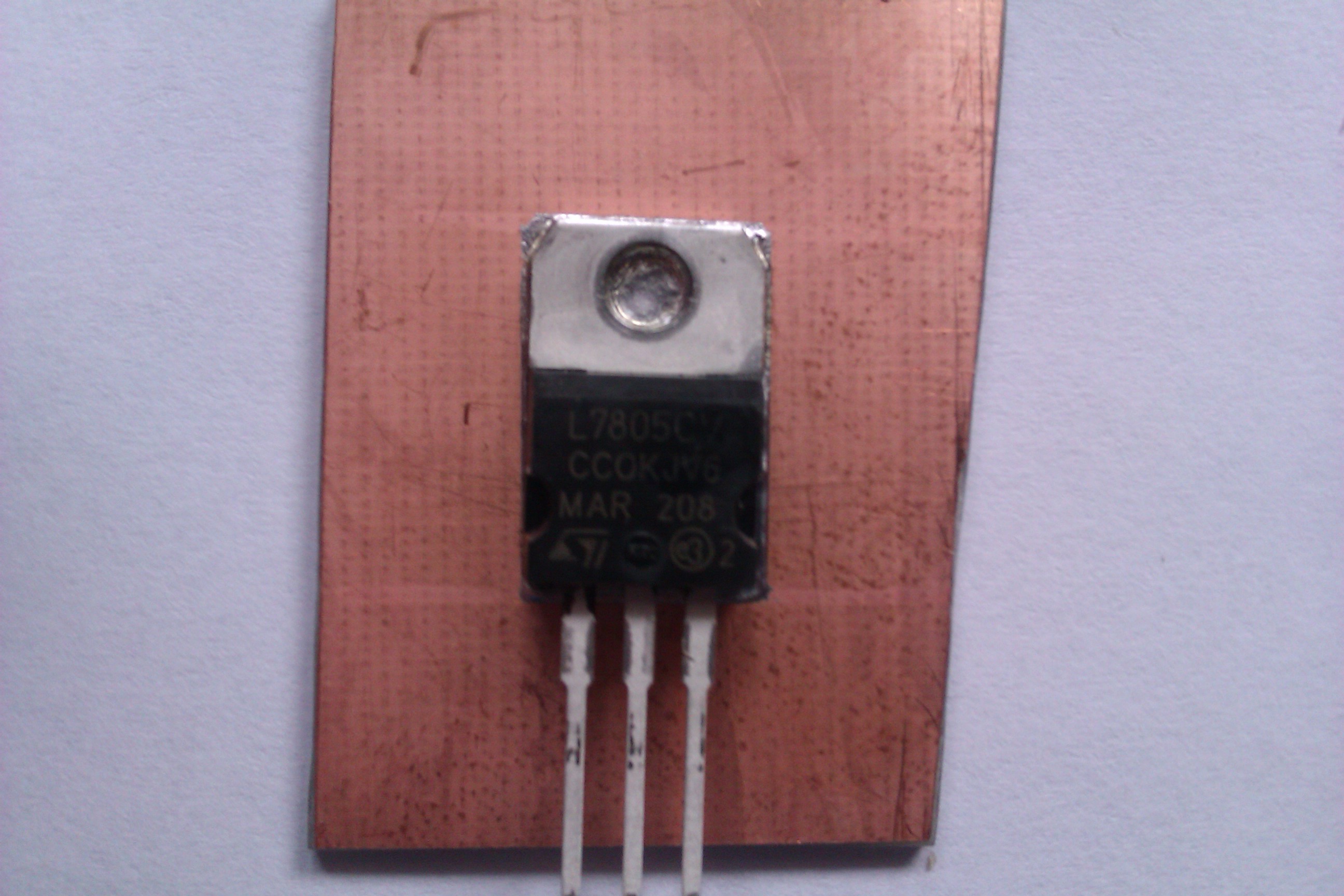

EFFECTS:
This solder looks like from fab!
This is simple method to hold solder in determined place and by surface tension of solder, mosfet is on place we want.
I not will be angry if anyone tell that this is not PRO :)
wow, that's a great idea. I didn't know you could cook the MOSFETs, it doesn't break them? How hot can you get the oven before the MOSFETs are toast?
If you get them back quickly from oven they will be not burned, remember, in fabs electronics are soldered in ovens, but temperature is controlled and many other parameters.

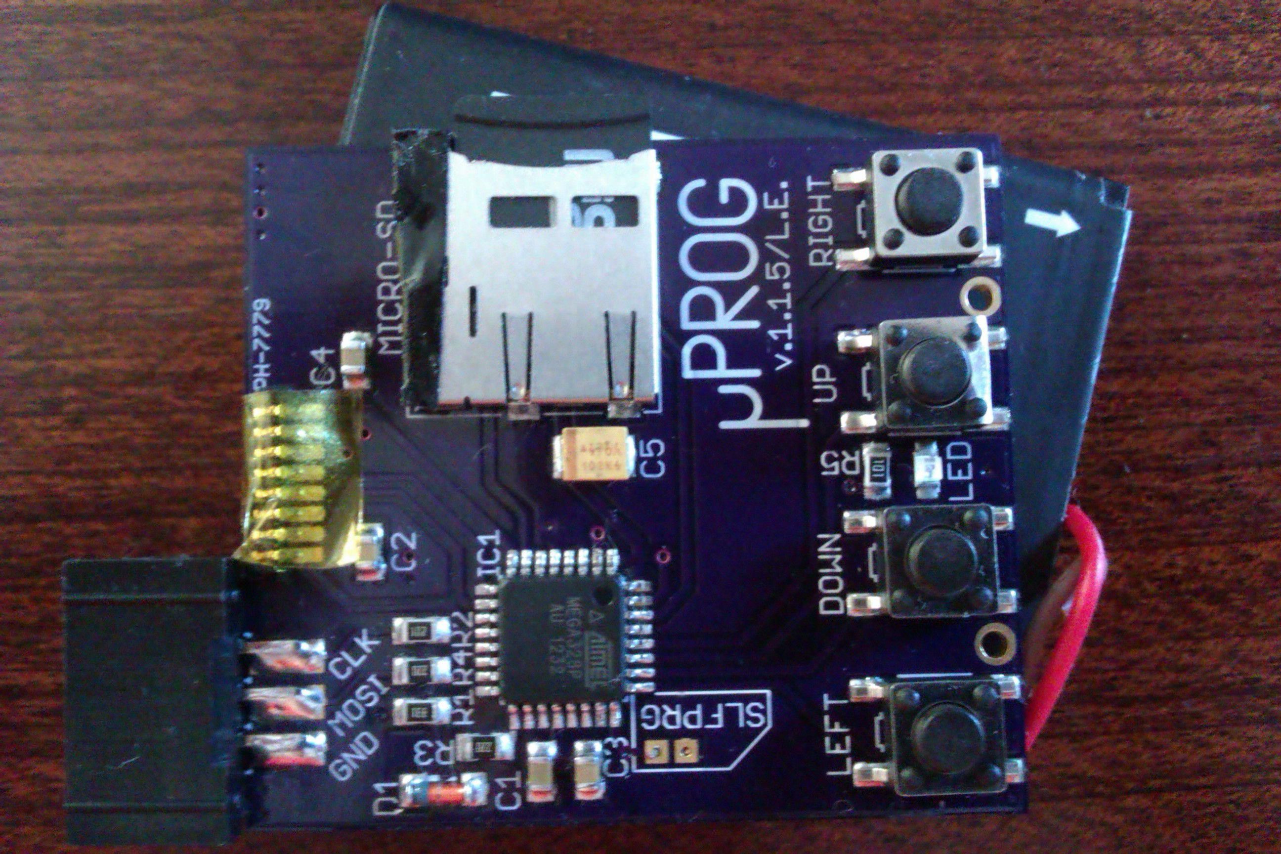

I solder many circuits in this oven, eg. SMT resistors, capacitors, atmega uC etc. w/o any burned part.
Soldering point of this paste is about 200C and max temp possible to get in this oven, about 350(bimetalic thermostat), but when I have about 250C I turning off oven and open doors to coll of components.
EDIT:
Cooked in my dirty oven :D :
