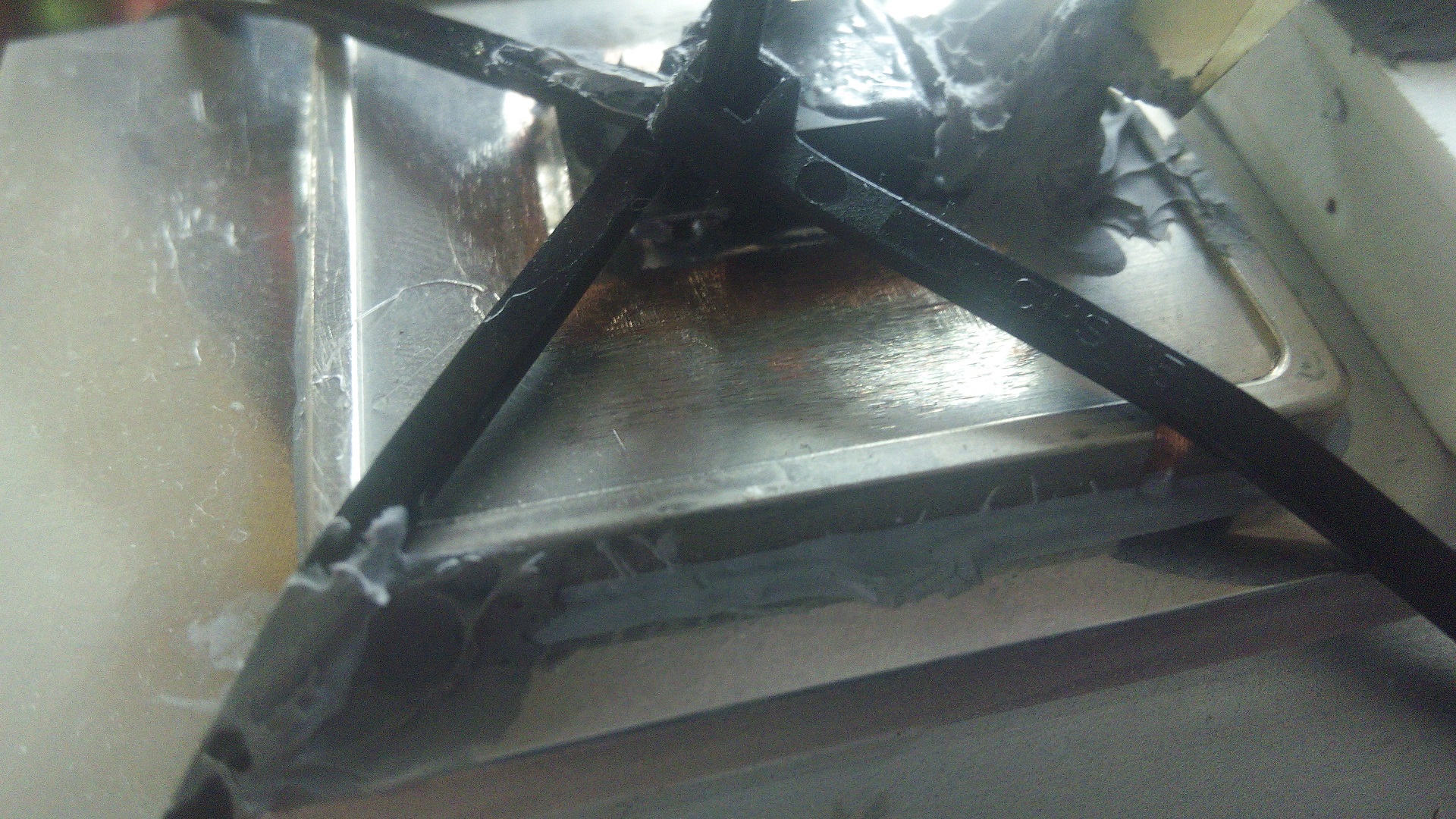

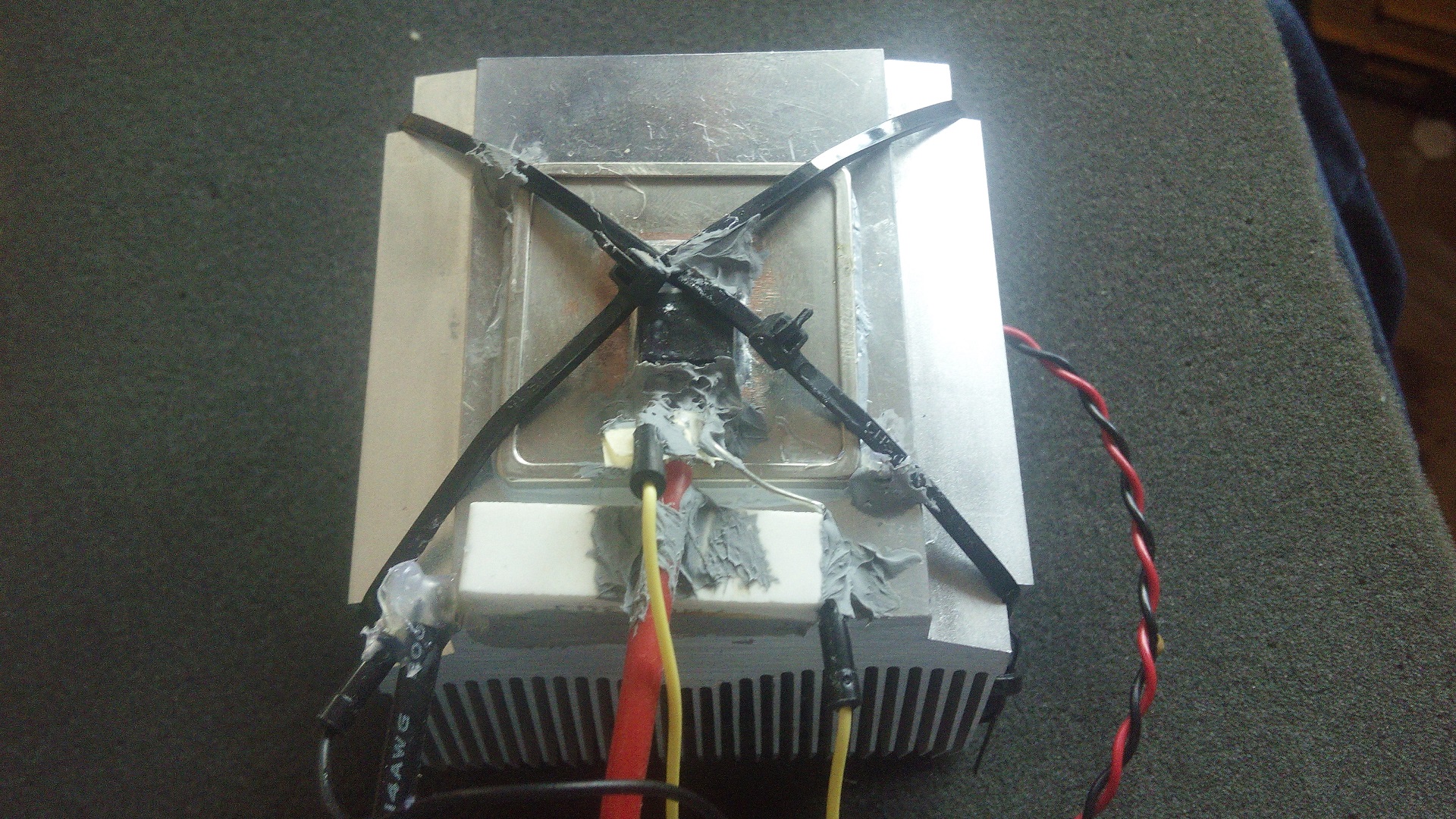

Also by making this DL, I learned something about cooling, and now im able to put 200W(mosfet case about 60C) per mosfet with standard cooling(heatsink+fan from 10yrs old PC CPU).
The key is soldering mosfet to piece of copper(35x35x4mm, salvaged from CPU thermal contact), and this module connected with heatsink by PC thermal grease.
By this way and 10 mosfets I can get even 2,5kW w/o water cooling
If you cant imagine what I mean, I can make photo of prototype silngle-mosfet, breadboard prototype.
In my dead DL I had soldered mosfets to copper pipe with 1mm wall which is too small, even with flowing 20C water inside pipe :|
So when I was reaching eg. 70C on mosfet case, there was 20C on other side of pipe...

Ok, there is it:
Yes I know, it looks messy, but its only for tests.
Tested with 15V/200W.
As u can see I used grey thermal grease its not that white, silicone crap, but good arctic cooling mx-2 grease.
To solder mosfet to this piece of pure copper I used standard alloy 60/40 paste, but it will be better(lower thermal resistance) to use "rohs" 99Sn paste, which I bought from china but that ******** send me dryed one, unusable -,-
